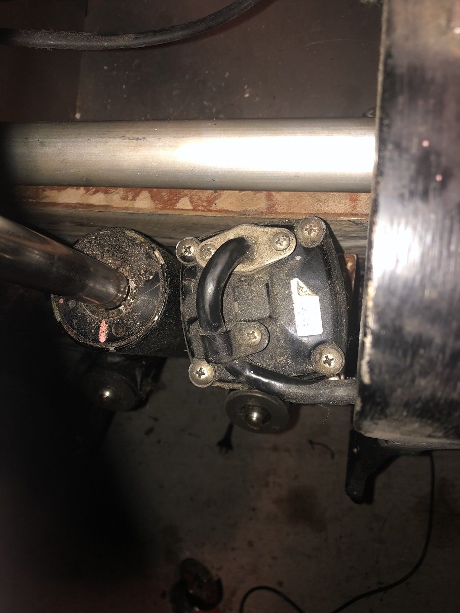

sgtjackass Posted April 25, 2019 Author Posted April 25, 2019 Took old motor off, put new motor on. Wired new motor, went to trim it up, solendoids clicking but no movement from pump motor. Bugger Had to remove one side of mounting bracket to get at this bugger. Cracked it open to find that the commutator and bushes were covered in oxide Sanded them back and hit it with a liberal amount of contact cleaner Put back together and is working ok, a little noisy and a little slow, will replace in future. Leaves me with this- Ready to start on a fine day with no kids. 7 Quote
