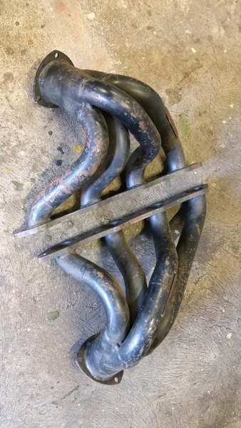

kyteler Posted June 13, 2017 Posted June 13, 2017 How solid are your mounts? That piping from the photo angle looks like something that could hit on motor vibration/twist Quote
KKtrips Posted June 13, 2017 Posted June 13, 2017 These are headers made by Castle Headers for a 304 into EJ/EH https://i.ebayimg.com/00/s/MTYwMFg5MDA=/z/eDcAAOSwdGFYt6b4/$_20.PNG 2 Quote
Kiwibirdman Posted June 14, 2017 Author Posted June 14, 2017 9 hours ago, k-trips said: These are headers made by Castle Headers for a 304 into EJ/EH https://i.ebayimg.com/00/s/MTYwMFg5MDA=/z/eDcAAOSwdGFYt6b4/$_20.PNG These are the headers that go out through the inner guard. Being the difficult contrary bugger that I am I want my exhaust to go down the side of the engine. If there is a hard way of doing something, that will be the way I want it. 2 Quote
Kiwibirdman Posted June 14, 2017 Author Posted June 14, 2017 17 hours ago, kyteler said: How solid are your mounts? That piping from the photo angle looks like something that could hit on motor vibration/twist I am using standard Holden rubber mounts. There is more clearance than the photo shows, there is about 10mm to the lip where the 2 halves of the subframe are joined together. I will be cutting that back when the engine comes out. Fingers crossed that the motor doesn't move that much. 1 Quote
