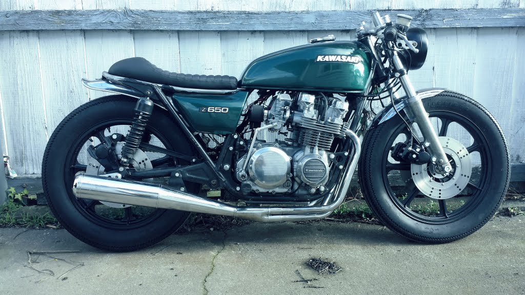

Flauski Posted February 3, 2016 Author Posted February 3, 2016 This baby needs some lovin. My Uncle has just finished his BMW K100 Cafe (which is awesome) and he started well after me. A mate has recently finished my rear fender to accommodate the tail light and made the bracket for my speedo. Finish list getting smaller; Check rear fender fitment. Strip apart to bare frame. Frame: Make cut outs for coils (different for B frame to C frame) Weld on rear disc brake bracket (different for B frame to C frame) Weld on mounting tags for rear indicators Weld mount for ignition Make mount for speedo Weld up holes in modified triple tree Blast / paint frame, fenders, triple tree Modify /source alternative front fender (redrill mount holes as sections welded in to accommodate clearance for larger tyres) Parts: Front disc brake bolts x 4 New air filters (some of the old ones rubbers have separated from filter) Rear shocks? Shorter clutch cable / throttle cables smaller battery To get running: Wiring - new speedo (removal of super huge cluster), moving of ignition, LED indicators/tail light, check suitability of wiring for H4 headlight WOF 8 Quote
Mitch.W Posted February 3, 2016 Posted February 3, 2016 this thing gets me every time! its so nice man, can't wait to build a big bike. Quote
Chris.QCR Posted February 3, 2016 Posted February 3, 2016 Oh mate this is looking so damn good !!! So slammed !!!! Quote
kyteler Posted February 3, 2016 Posted February 3, 2016 Agreed, this thing is fucking slick man. So good. Well done you. Quote
