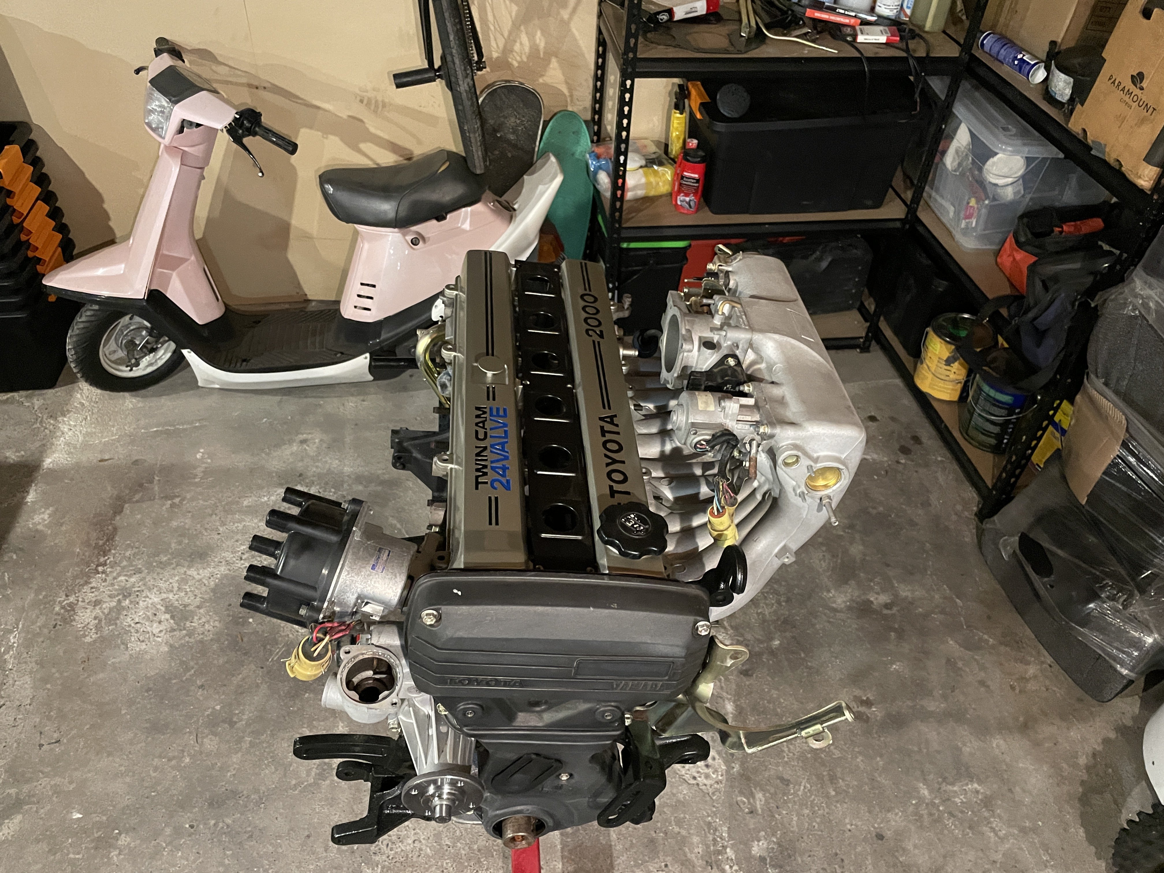

Slowly chipping away at this, got the motor 90% complete, just need to pull apart the accessories to vapour blast all them and it’s ready to drop in. Big shoutout to @HighLUX for sending me down a lower timing belt cover in good condition as mine had been mangled when it was pulled out of the original car. I’ve also been in the hunt since I got this for for a pair of 14x9j A type (-25) ssr mk3 with original ssr lips to match my pair of 8j A type mk3, finally found some on yahoo when they arrived they looked wide and I measured them up and they turned out to be 14x9.5 A type (-30) which is wider than I wanted and a little annoying, but have decided I’ll just make em fit, will need a little more guard work but that’s no biggie. I stripped the paint off the centres and a thinking I will vapour blast and clear coat the faces? If anyone has any suggestions on the best way/any other ways to keep a raw face nice that would be handy, and they are getting sent off to get the lips all polished up and tidied.
