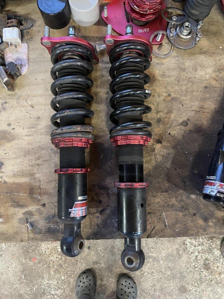

  13. First thing to do was work on getting this thing rolling so I could get it home. Started looking for some parts on marketplace place - blitz coilover - $150 - black racing n1 in 17x9 +30 - $500 - grb sti rear hubs to convert to 5x114 - $50 - gk tech front hubs to convert to 5x114 - $400 now it's rolling I can finally drag the thing home and start digging into it properly. plans for here are empty the thing out, it still has 90% of its interior so if anyone need anything flick me a dm. I have a j160 and hopefully a spicy 3sge sorted because it's currently the best/most cost Effictive combo at the moment, I did consider ez30... and ofcourse 2zz, 2gr but still went back to 3sge for how simple/cheap they are. a bit of inspiration on ow I would like this thingg to end up looking, the main downside currently is aftermarket body kits are still super expensive and not very abundant at the moment. a guy in Aus has just started making mount kits to throw 3sge's in the zn6 chassis, they look simple enough so I will probably just make my own and try get the motor sitting in a bit better of a position
