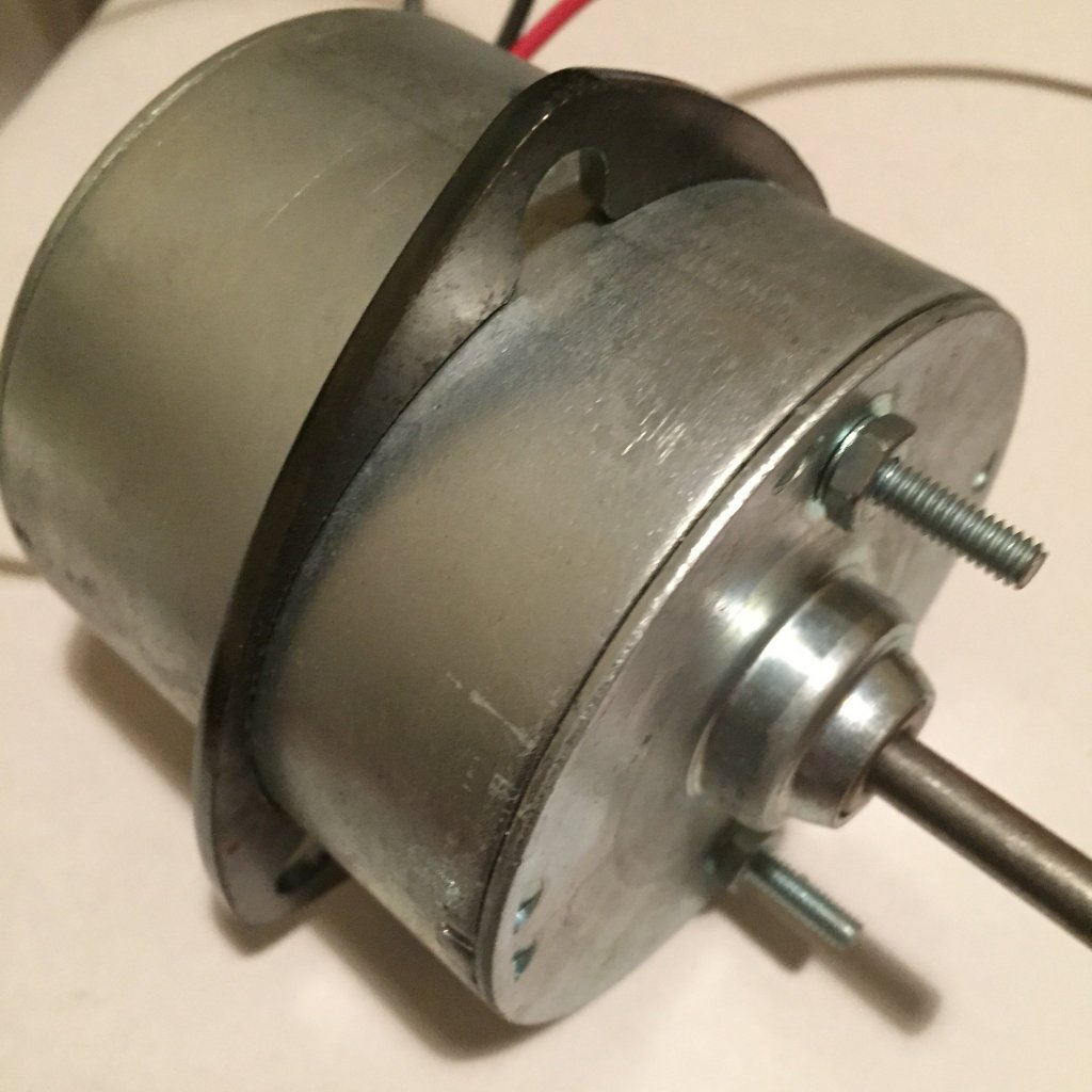

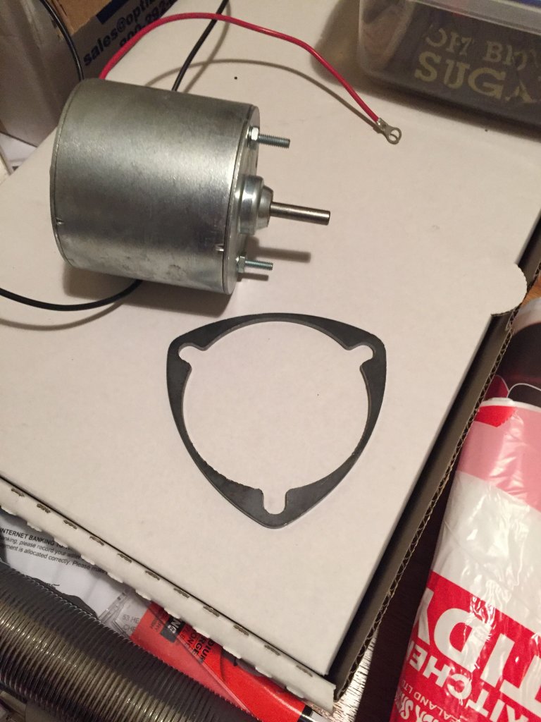

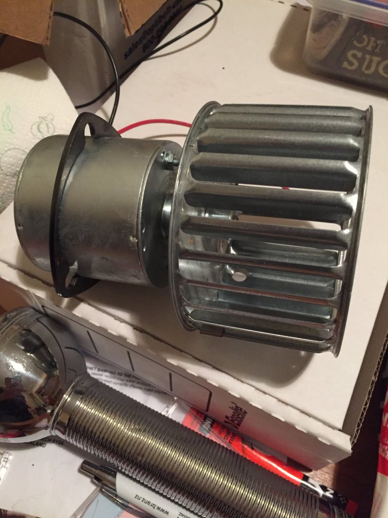

  6. TIG seems to be the consensus. Now to work out exactly where I want the brackets and get it done. Thanks for your help gentlemen

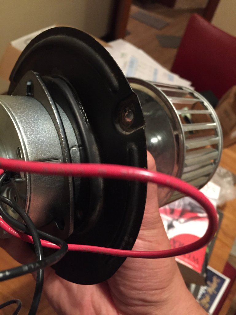

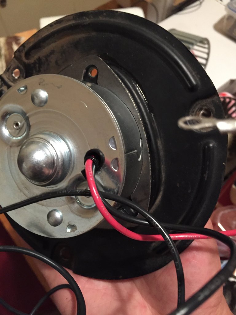

  7. When the bracket is fixed to the motor its screws into a larger plate which is fixed to the firewall (all the fan and half of the motor is behind the firewall is the ventilation ducting) hope that makes sense
  8. Hi All, I've been pottering away at this for over a year now basically making up some replacement heater motors for the Jag. I've basically got everything done but I'm a little hesitant when it comes to attaching the mounting bracket to the motor. I reckon this can't be welded due to the electrical stuff inside the motor (theres two big half doughnut magnets glued inside the circular housing - I might be able to remove the rest of the innards) I had been planning on epoxying it but wasn't sure I'd be able to get a good key on both parts (or if it would stand up to weight / momentum of the fans running). Keen for any suggestions....
