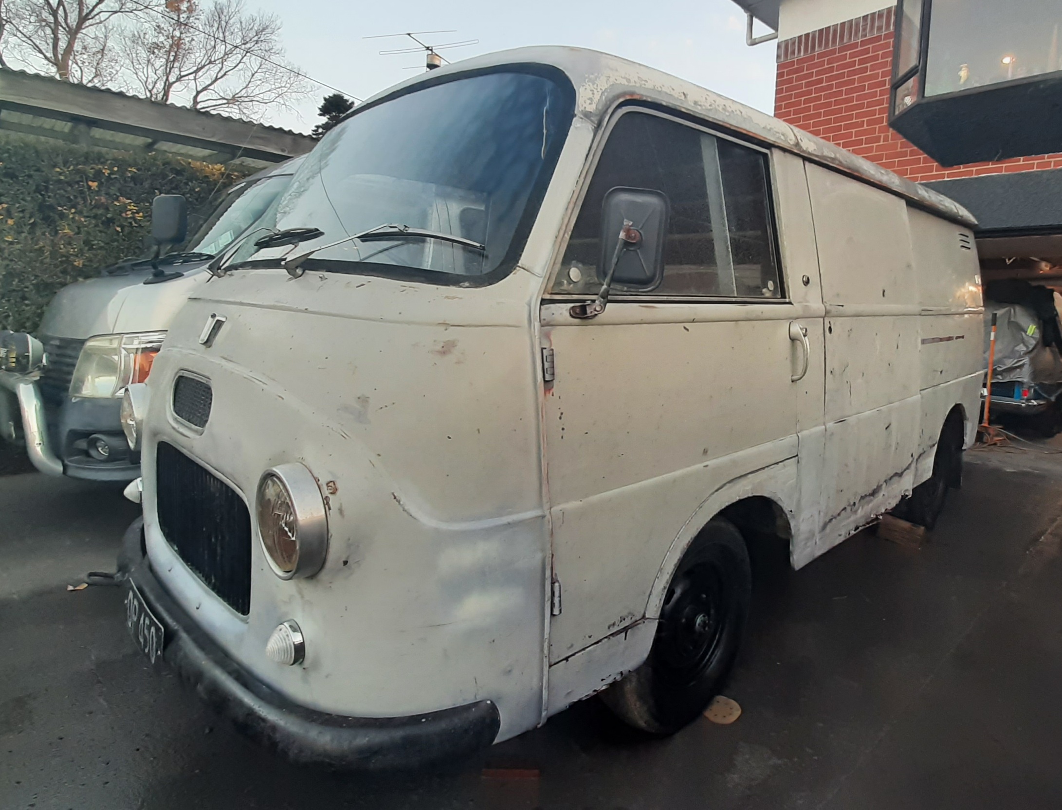

Popular Post azzurro Posted April 12, 2021 Popular Post Posted April 12, 2021 Just won a trademe auction for this. Not collected yet, so not fully mine or in my possession, but i'm quietly fizzing. Its been sold and resold on trademe and on Facebook about 4 times in the last 5 years, I was the second highest bidder a couple of times, moving pretty steadily south, starting off in Ashburton, then Christchurch (a fellow Fiat botherer went and had a look and sent me lots of detailed pics and declared it was savable), then i think Timaru , and now, back of Milton. At least 5 people messaged me directly to share the link, and the key difference is this time Im only 40 minutes up the road, and this time i got it for about half of what i have bid on a couple of the previous auctions I like to think the sellers (honest!) description, and utterly depressing photos put a lot of punters off but i could also be assuming its the world that is mad, not me.. Anyway, looking forwards to collecting and then playing around with this. What i know: - A 1960-64 model based on the sliding windows and engine - they made the same shape from the mid-1950s but started off with the 1100cc from the Fiat 1100 its based on. I suspect many bits will be easy (but not necessarily cheap) to find once i figure out what other Fiats it shares parts with - the 1100 obviously (eventually evolving into the Premier Padmini Taxi from india) , but also the Fiat 600 particularly the Multipla shared some lights and switchgear and maybe column change/front control parts and other bits which itself formed the base of the 850/133 and many other variants made up until the 1980s in places like Spain, Serbia and Argentina under licence. - dead rego, no papers no nothin, but im hoping the black plates are an in and maybe some faint rego stickers. Suggestions and hints on getting the paperwork sorted so its at least in the system again welcomed! - has the 'big block' 1500cc pushrod engine (the engine that should be in my 125p ute, and is the 2300 in my wagon, less 2 cylinders (so have some bits and pieces already). There was also a 1300cc model and orginally they came out with an 1100 same as the car. There is one engine in the hole thats seized and one in the back that i assume is also seized. - Seats and Engine cover, front bumper are int eh back - it doesnt really have any interior from the factory, no rear bumper either, this one has a tow bar (lol) - 4 speed column change, 5.x something rear diff, 95kph top speed new but apparently very quick off the line and able to lug a surprising amount of stuff, just not quickly! - everything is 'there' except a sliding door handle, but almost everything looks like shit or is slightly busted - it appears to be relatively low milage and remarkably unrusty otherwise - the terrible paint (flaky grey and rusty brown primer over the original poorly sanded white?) makes it look much worse than it is, but definitely needs new front floors, and the bottom of all the doors is frilly, otherwise surprisingly good underneath and on top 35 2 Quote
Popular Post azzurro Posted April 16, 2021 Author Popular Post Posted April 16, 2021 Took the day off work today to pick this up. Donkeys! Then home. Gave it a rinse inside and out with the waterblaster, and started digging in to see what I got/whats missing. It is mostly complete, box of spares has old brake bits, which might be ominous. It has a 4x148 or so stud pattern, which ive never seen before. The body is pretty good, just the bottom of all the doors and front floors are crispy. All the switches are bung. Windows are stuck. Found the chassis number, data plate and an faint image of an old wof sticker and an old style reg sticker with 1992 faintly on it. Pretty sure it was repainted maroon over grey primer and roof left cream, and the maroon has fallen mostly off. I think the grey primer might wet sand off. I also think it was a painters van for a while based on the range of colours and depth of house paint splatters in the back. None of the doors close or work properly so i started by adjusting the catches then taking the door handles off to clean and lube them up. Fixing the rust will help the door stiffness too. 42 Quote
Popular Post azzurro Posted April 17, 2021 Author Popular Post Posted April 17, 2021 Bit more wombling. Took the front bits off for a tidy up, and hit a few dents out, drivers headlight bucket had had a dint (as they say), headlight spaced out with a stack of rusty washers the paint underneath what remains of the maroon had only been lightly scuffed and the front looks waaay better after a bit (a lot) more wet and dry and the bright work (all cast alloy) given a light tidy. I think it will come around, but gosh, i just really fricken hate hand sanding. Ill do around all the door handles for now so i can pop those back on tomorrow now they're all cleaned up 20 Quote
Popular Post azzurro Posted April 17, 2021 Author Popular Post Posted April 17, 2021 None of the door handles really worked so the doors dont really close properly. Lack of use had made them stiff and sticky. I was most worried about the rear door handles and mechanism because thats stuff is van specific, and well, good luck finding another one, and it was jammed. Tap tap with a hammer didnt do anything much so drastic destructive action needed! That'll do it! Both bottom latches were full of gunk, that could get in but not out. Cleaned up ok, very different life compared to the top ones which look like new! a bit more weld to fill in the wear areas, fill with grease, assemble and weld closed again. oh, and dont forget to put in the spring, silly! The latch mechanism tidied up well too, a degrease, soak in evavorust and reassemble with new grease All the exterior shiny bits, of which there aren't many, are all lovely cast alloy. disassembled as i far as i could without keys and withscotch brites and steel wool came up nice and satiny. Should be able to open and close the doors easily for the first time in many years tomorrow 22 Quote
Popular Post azzurro Posted April 17, 2021 Author Popular Post Posted April 17, 2021 I also tidied the hub caps. Came with all 4, which i happy about as they are van specific too, but they had all been given a good kicking. Underside to show the ring that clips into another ring on the rim, and, A former owners address? D. S. Clark Kelso 5 RD Gore Again alloy, so came up much better, certainly good enough, after tapping the dents out and a whiz with the scotchbrite and wore wool. Ill give the rims a fresh waft of black and pop these on tomorrow. 26 Quote
Popular Post azzurro Posted April 18, 2021 Author Popular Post Posted April 18, 2021 Sprayed some black rust remover and metal restorer on the rims. Massive stud pattern. Ill take the drums off to look at the brakes another day. Im sure they are juuust fiiine. Cop mode. Put the rear doors back together and straightened a few things out and did a bit more sanding. They are still busted but now they open and close nicely. Pulled the front door apart to get the inner latch out. Safari! Some percussive maintenance needed where the limit strap had bent in the door flange and the door now opens and closes lovely. 28 Quote
Popular Post azzurro Posted April 22, 2021 Author Popular Post Posted April 22, 2021 Been doing some excavation, attacking the bog patches with a stripping wheel to free what lurks behind them. First the ugly forehead lump above the windscreen. Looks like it was driven into something, and very roughly but also hardly tapped out. Pretty easy access from the back too so some tappy tap should tidy up a lot. Stoked there are no rusty holes tho! Then the area between the wheels on the passenger side. Jeepers! Front of the sliding door looks good under the protective 10mm layer of wob Back half not so much, and reveals the deep dingle down the side. The panels either side of the sliding door are pretty beat up but not rusty. Again pretty good access from behind so not sure why they used heaps of time layering on so, so much bog, rather than spend a few minutes with a hammer and dolly. 25 Quote

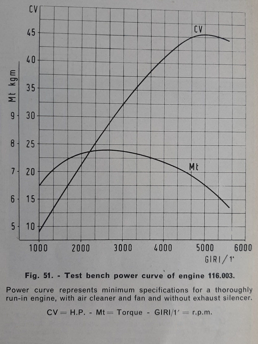

Popular Post azzurro Posted April 24, 2021 Author Popular Post Posted April 24, 2021 Trinkets are starting to arrive. This will be painted to suit, once i decide on the full size version A factory service manual. These 'yellow books' are great, beautiful hand drawn 'photos', pics of the special tools in use and all sorts of specs and info. Such power! (The 116.000 is the 1300, the 1500 is closer to 52hp with slightly more torque). Such utility! What i really wanted was this page. Fiat 1100T wiring diagram. Not too many systems, with only 4 fuses, but classically FIAT in its implementation And this. Dash contols, none of the switches are labelled from the factory anyway, and there has been some hackery, like a foot switch for hi/lo beam retrofitted to the steering column, aftermarket switches replacing the factory ones and vampire taps galore, as well as some rodent damage. 20 Quote
