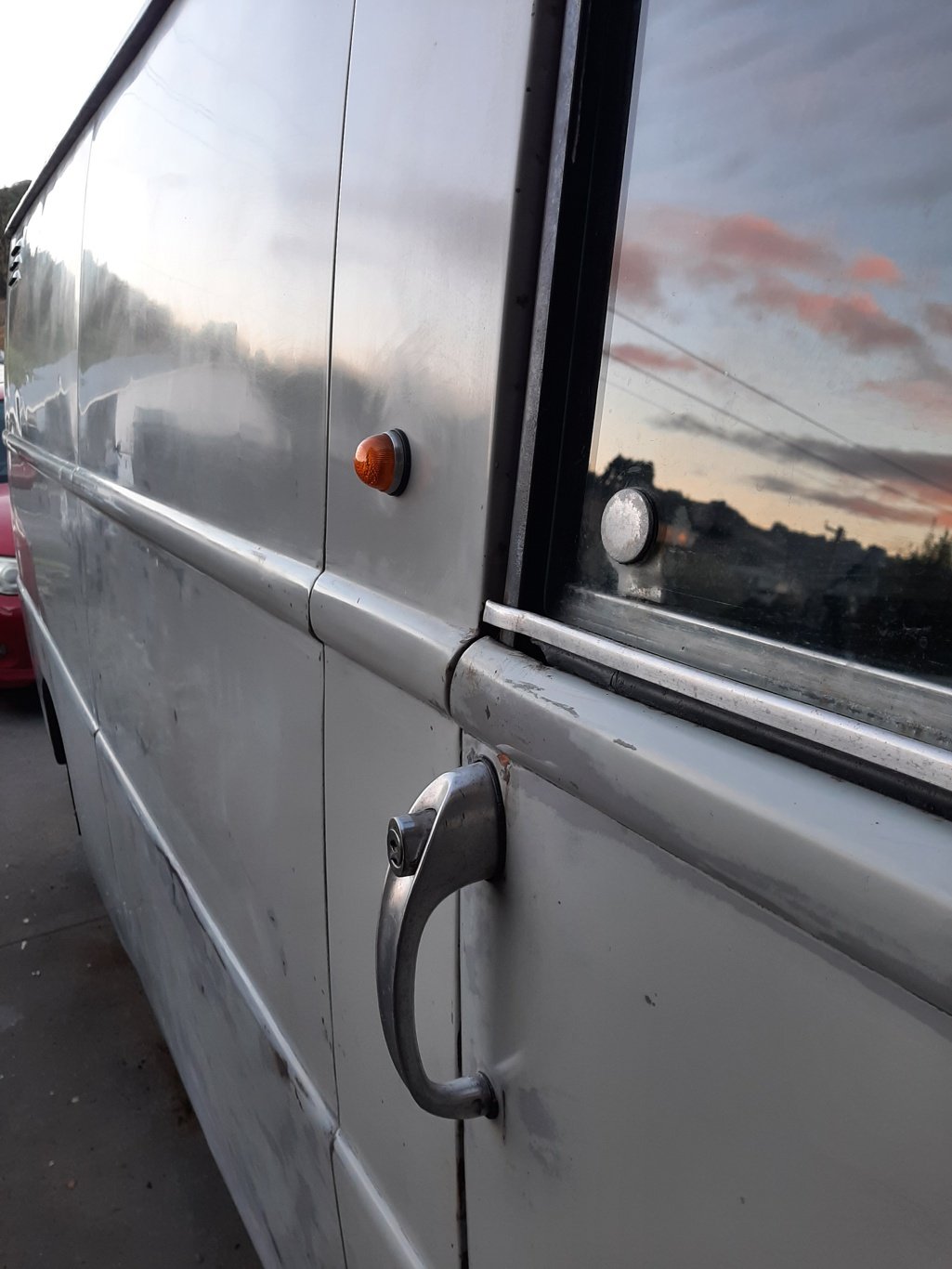

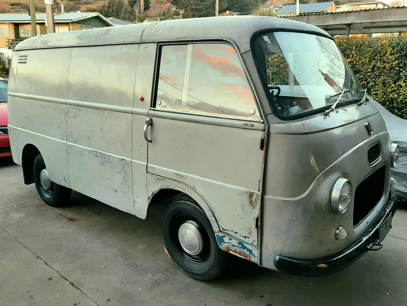

Popular Post azzurro Posted June 13, 2021 Author Popular Post Posted June 13, 2021 slow progress this week finally started painting the bathroom ceiling i rejibbed after replacing the old 3 in 1 fan a few months ago. Some more treasure from Italy showed up, its the missing sliding door handle. Popped that on and now the van (furgone) is pretty much complete now. Just doesnt go or stop... So shuffled the 'car' engine off the stand and under the bench and got the original one from the van ready, removed clutch and flywheel, and got it on the stand to start the tear down to see what we have to work with. Got a new parts washer - its a revelation - good for cleaning things before (remove the greasy smeg) and after a soak in the vinegar bath (to neutralize it) and after the sand blasting cabinet to get the sand off things before putting them away - flywheel and clutch plate are both in great condition and came up well I know this engine is hard seized and the engine number is about 50,000 lower than the car engine. Both are 115C 000 blocks, but the van one is #35xxxx, car one is #409707. Centrifugal oil filter shows signs of a lot of deferred maintenance! Popped the valve cover, the inside and the head very blackened (from dirty old oil getting hot) and the valve gear has some surface rust from condensation A couple of valves were sticky but they freed up once the head was off and i could tap them back up. Ill strip the head down after work this week some time, hopefully its better than the other one. The valve gear off the other engine is nicer than this This is Cylinder 1 after popping the head off and a quick vacuum. That will buff out? After a good water blast and air dry i stripped the rest of the accessories out. Cam looks ok - cam gears, chain and cover are also in good nick - no witness marks from loose chains either so ill use that cover at least. Oil pump shaft is stuck in its hole- and BLACK Left some ATF and Acetone sitting in the cylinders overnight - only #2 drained out - i know for sure #1 is rusty and stuck, but maybe #3 and #4 just have really good rings? HA haaaa haaaahaaaahahahaha hhmmmm. Hmmm. Shame because it looks like this engine has standard pistons still (77mm vs 77.2 on the car block) and apart from the rust the cylinder walls look less worn as well. Will see if it frees up, but i think ill stick with the car block, hopefully the head off this one turns out to be ok, or at least better than the car one, and with a few other bits swapped around and some new rings ill get 'a runner' 27 Quote
