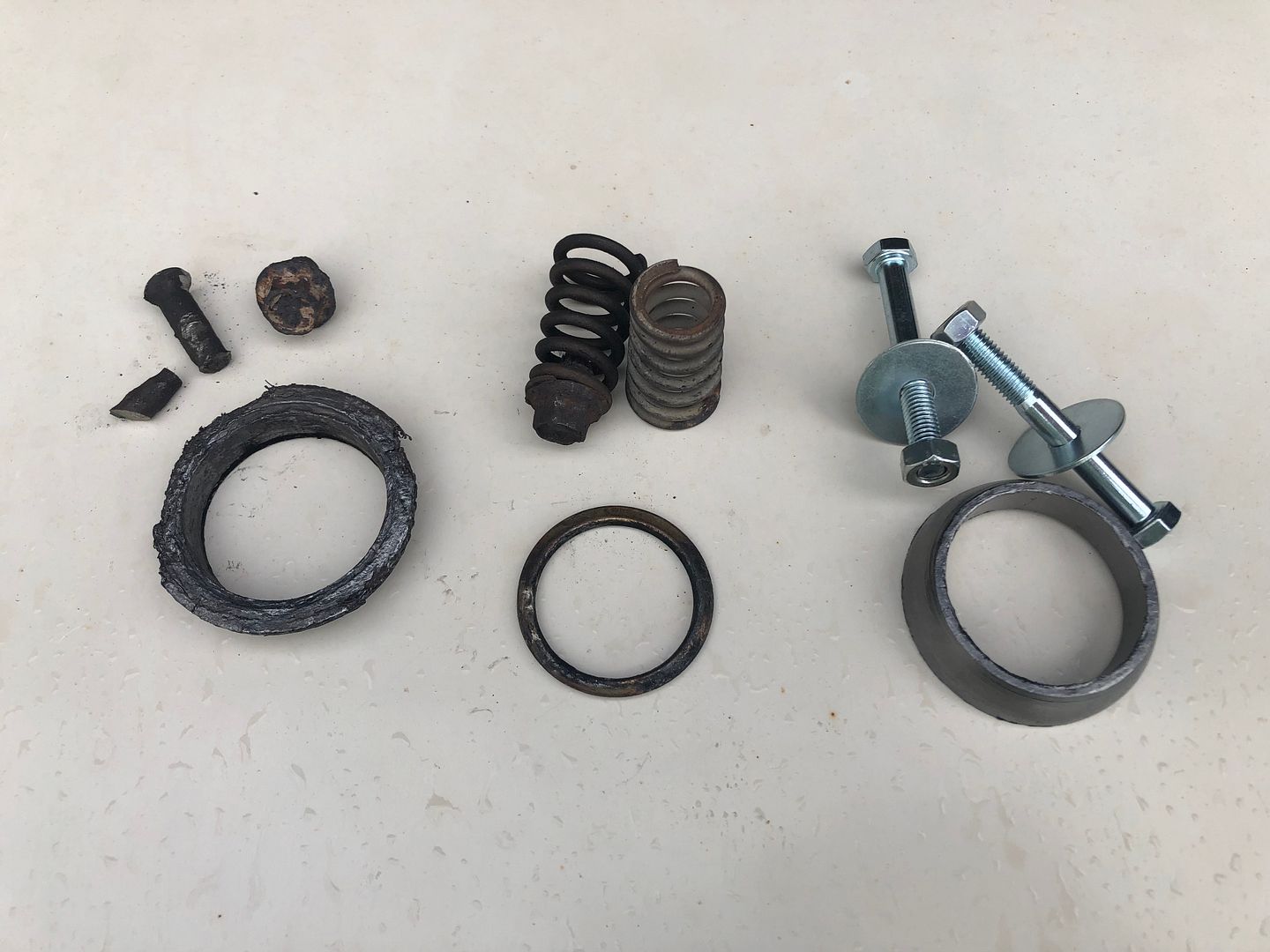

Grizz Posted August 15, 2022 Author Posted August 15, 2022 1 hour ago, yoeddynz said: Yeah it's a neat design (when the bits ain't corroded to that level) and yeah - bolts instead of studs are fine but they need to be just the right length of clear shank so when done up tight they protrude the same amount as the original studs. It's purely the tension on those springs that should be holding it all together. How have you got on with this @Grizz? Or are you dead from excessive swear laden sweating in the heatwave going on there? There you go. So not a lot of swearing……… YET. Quote
Grizz Posted August 15, 2022 Author Posted August 15, 2022 I used a Vax wet vacuum cleaner to clean the seats. Front seats after the first cleaning relinquished a lot of dirt, settled in the bucket. Yesterday afternoon I got the grinder in, cut wheat was left of the broken bolts off, followed by a slow grinding back with my favourite tool. Need to replace these. Grinding back. So before I get it in the neck, both sides had been threaded in, one into a blind casting, the other, through the casting and into a fixed nut as far as I can see. But I think a couple of long M8 bolts welded in place should do the job. if not, refrigerator time. 1 Quote

Grizz Posted August 16, 2022 Author Posted August 16, 2022 Ready to Rock n Roll or curl up and Die. The bolts need plating removed. Not going to try remove the studs. 1 Quote
