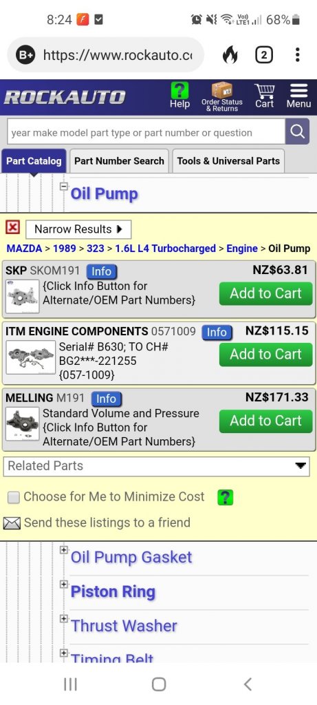

Bearded Baldy Posted May 7 Report Share Posted May 7 Rock auto to the rescue? 1 Quote Link to comment Share on other sites More sharing options...

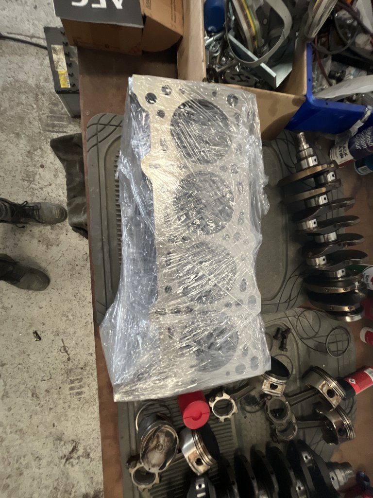

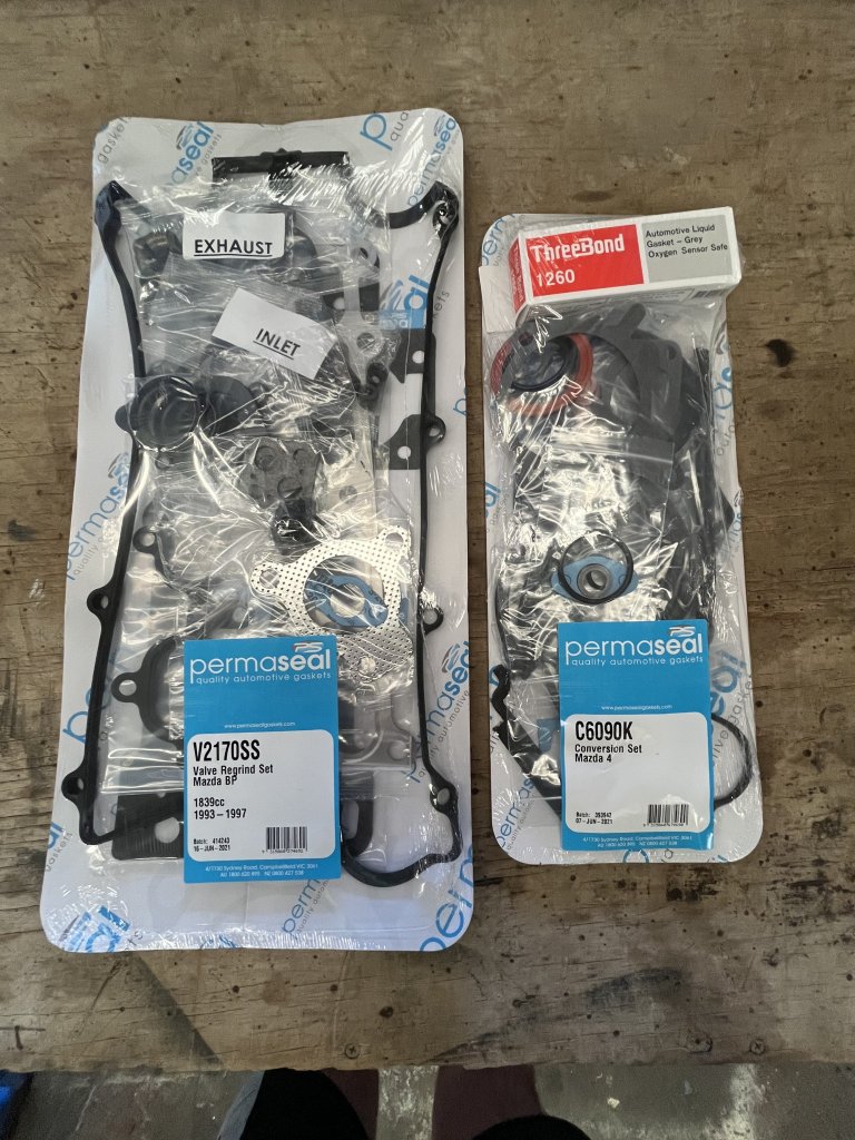

shizzl Posted May 11 Author Report Share Posted May 11 Goodies have arrived. got the block in at franklin engineering getting a deck, clean and hone. all the bearings , rings and thrust washers are ready to go. will get the bottom end back together. Then send the head in for a look at and valve lap. 7 Quote Link to comment Share on other sites More sharing options...
shizzl Posted May 16 Author Report Share Posted May 16 It’s nice, good size … picked up the block from Franklin engineering. had it honed, tanked and decked, flushed galleries etc. it’s rebuild time!!! still need to strip the head to get that checked, cleaned, decked, lapped. 8 Quote Link to comment Share on other sites More sharing options...

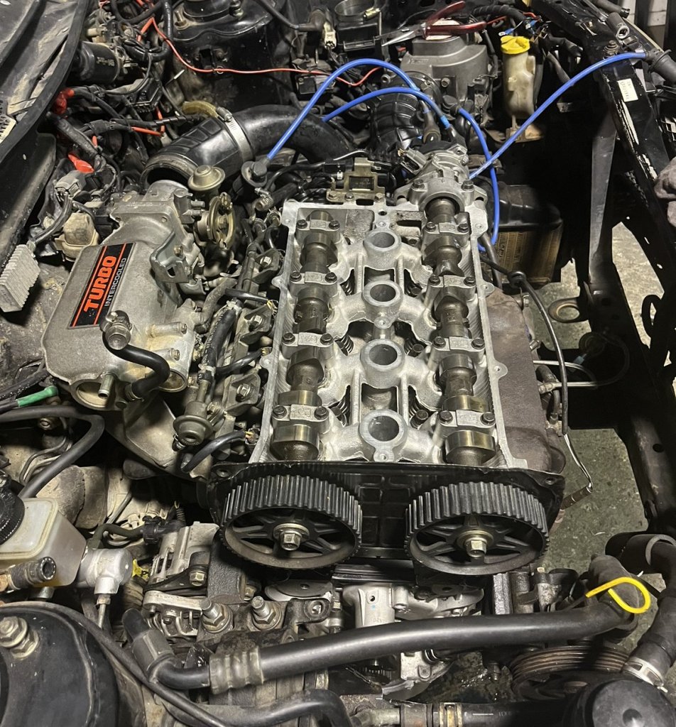

shizzl Posted June 5 Author Report Share Posted June 5 Picked up the GTR head from Franklin engineering, it looks brand new again. I decided to bolt the intake on before fitting the head it’s a c—t getting my mitts in the back to get the nuts on. Started putting everything back together, plugs, hoses, cams and lifters. even got the turbski on. not much left to do for a fire up. have been told to just buy cheap mineral oil for initial start up and break in. there’s loads of conflicting info out there in break in procedures . 6 Quote Link to comment Share on other sites More sharing options...
Popular Post shizzl Posted June 6 Author Popular Post Report Share Posted June 6 Chur bro. got it back together. Got some oil psi’s happening. Fired up instantly. still has lifter tick. So let it get to temp, no change. Then swapped out for the new lifters, fired up and became much smoother. no leaks anywhere. Just burning residue off the turbo manifold. now I need to sort out where I can fit all the necessary sensors so I can monitor its bowels. oil pressure oil temp water temp intake temp boost exhaust temp fuel pressure 15 Quote Link to comment Share on other sites More sharing options...

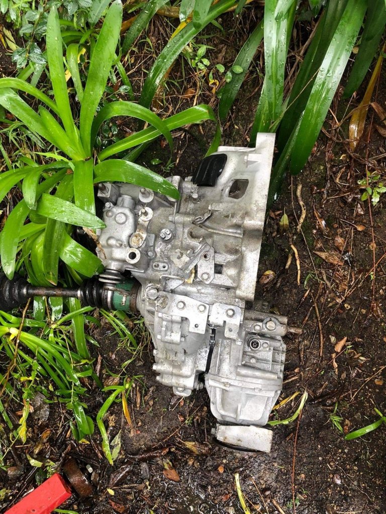

shizzl Posted June 15 Author Report Share Posted June 15 I stepped in some rocking horse shit , slipped and landed on a unicorn. yup that’s right, I found a stock GTX gearbox that has been rebuilt. it us now on its way to me along with a left driveshaft and another baby unicorn, a working AFM. price paid, much less than I was expecting to have to pay for one. i technically have the parts to put together a complete car from a rolling body. Don’t dare me please, I can’t deal with that kind of pressure. 7 Quote Link to comment Share on other sites More sharing options...
