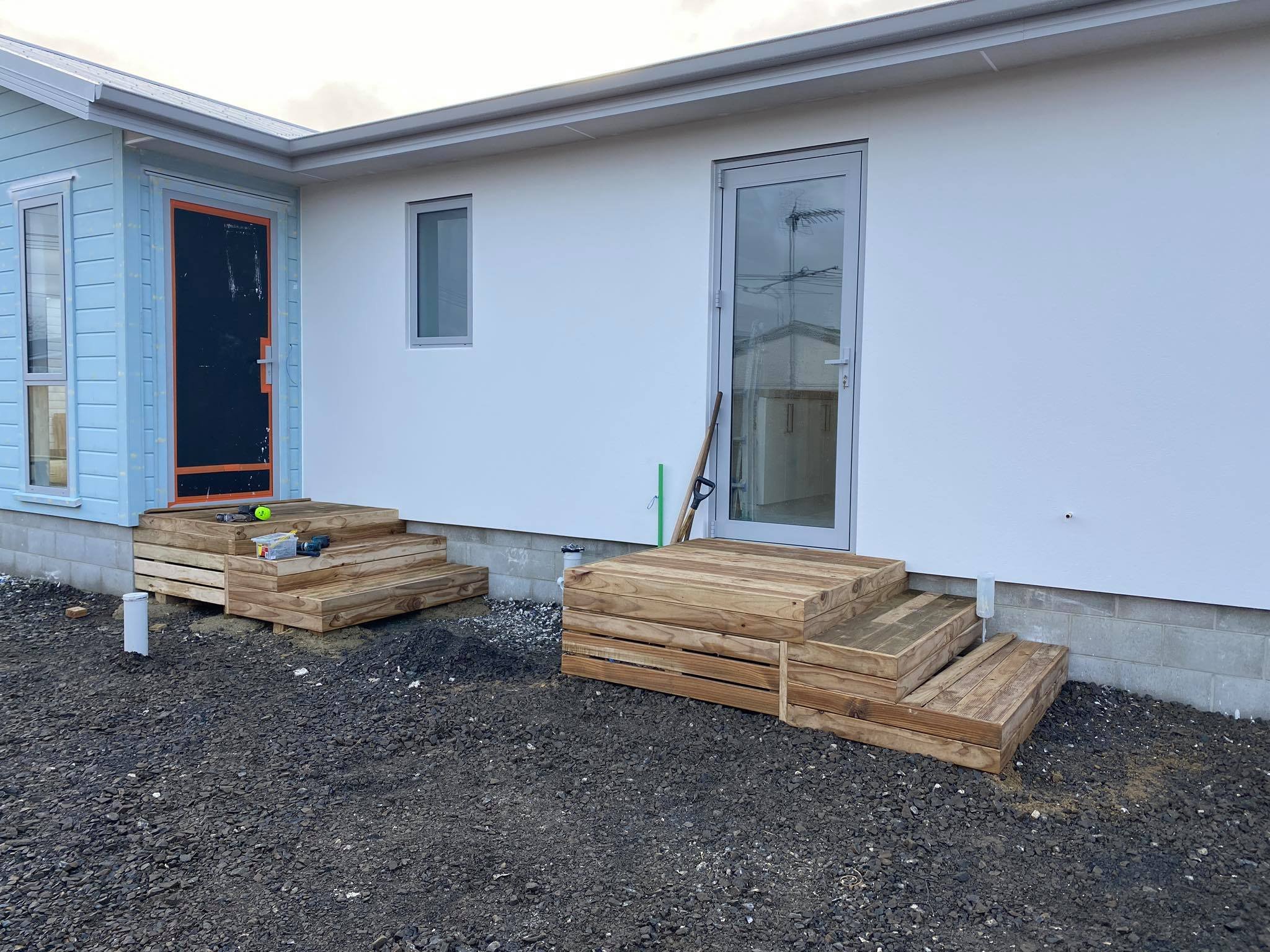

I hear ya @TimShadboltfan27.  The contract had driveway in it (need to have 5m+ sealed for council).  I had said at the start I’d sort the decking etc.  apparently can get ccc with just ‘temporary’ steps but that seems dodge.
I had temporary steps / pallets at my place as I think by rights, smooth side up decking doesn't meet "slip factor" for code.
Could be wrong mind, but wasn't an issue I was willing to deal with. Pretty sure up here the driveway just needs to be formed.

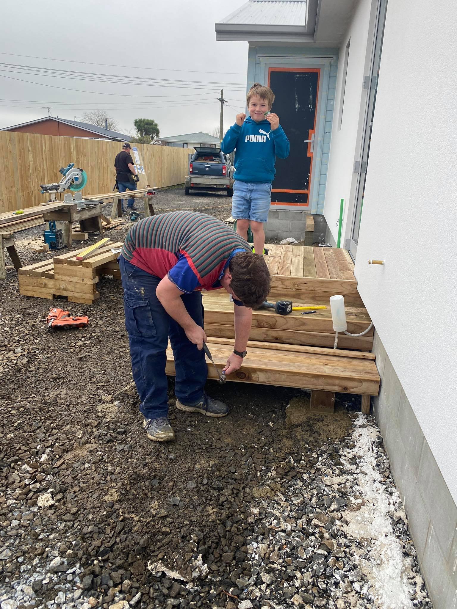

Deck complete, fencing done.  Schedule has us completed next week with asphalted driveway ready for my landscaper.  Very close to getting this back on the market....
  • Like 7
Looking good, but one small observation.. decking grooves down is best practice in my humble opinion.. each to their own though :thumbleft:
(now let the debate start)
Yeah as above I was also about to say.  The grooves were originally used down so the timber could breathe and didn't rot between the connections. Somewhere along the line some suit decided it was good for grip and is now policy to have it up. From my experience it can be fucken dangerous when wet with less surface area for your shoe to grip, especially when in a shaded spot. Hardwood is even worse and on some jobs we've had to put put sand down to make it safe (while we're there anyway). We used antislip tape along the front edge of any steps when we built our deck, mainly for oldies.
