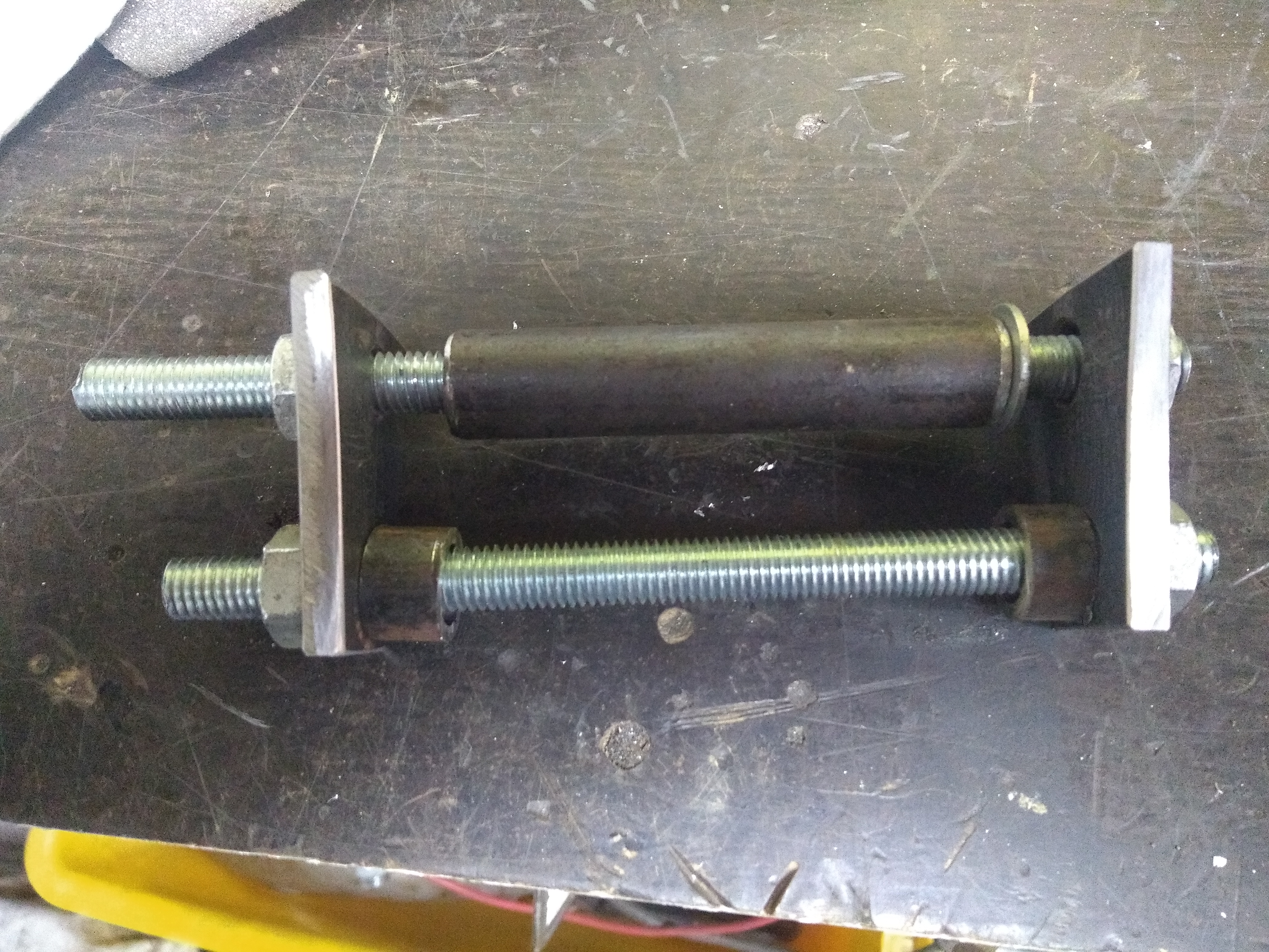

Popular Post KKtrips Posted August 16, 2018 Author Popular Post Posted August 16, 2018 Tonight's job was making the engine mount, engineers, please bare with me cos this may be painful to look at, but my engineering skills ain't that flash.. First was put the engine where I wanted it to sit and measure the distance between centres from the original engine mount location to the new mount location. (which was 30mm BTW) Next cut some 50mm x 6mm strap to 50mm lengths giving me 50x50x6 plates. Drill 2 pilot holes 30mm apart along the centre line of the plate and drill them to 11mm (10mm bolt plus wiggle) Cut down the sides to a nice taper then repeat x 2 Next measure the gap from the engine to the plates with them bolted in, each side was different (8mm one side and 10mm the other) Also cut a spacer to go where the engine used to sit (90mm wide but I fucked up so have to add a wee washer on one side to pack it out) Fit the plates with spacers and tighten it all up, VOILA! a mount is born. And here are all the parts back out of the bike. I intend to radius the corners of the plates and weld the small spacers to the plates and then weld the plates to the frame. But I ran out of time tonight. It was incredibly strong as it was by just tightening up the bolts, but for longevity I reckon its probably best to weld the plates in place. I may linish down the smaller spacers yet, because it might be a mission to get the engine in and out with the snugness it possesses currently. Anyhow if you have any criticism then fire away. Although this seems a much easier method than the way other people have described to me how they did it. Also I won't be using threaded rod in the final version - I just used it for mock up purposes this time around. 16 Quote
Chris.QCR Posted August 16, 2018 Posted August 16, 2018 Quite possibly the most professional mounting of a 125 into a c90 yet. And also looking at the photos your engineering skills are tops. Good work matey 5 Quote

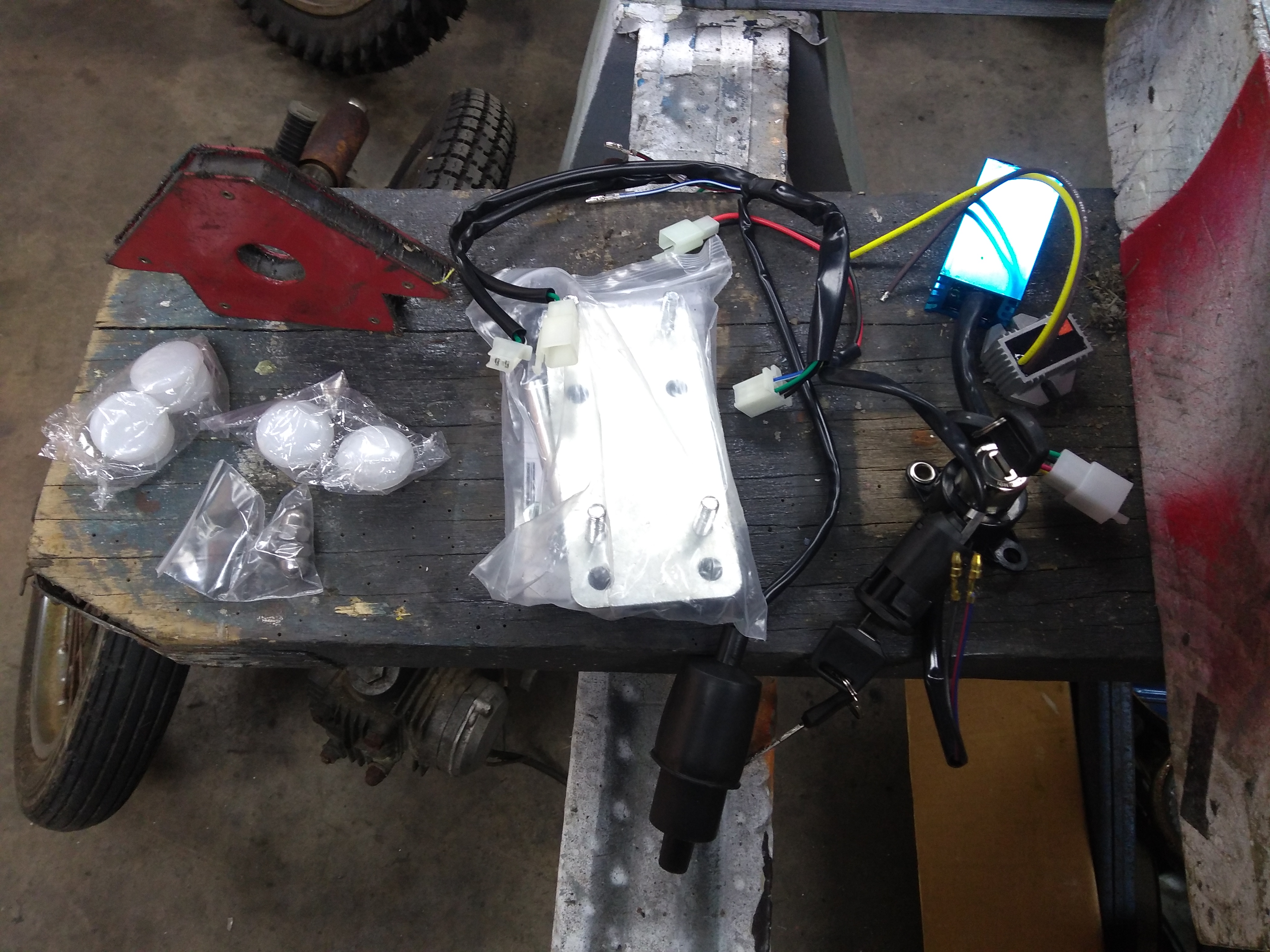

Popular Post KKtrips Posted August 24, 2018 Author Popular Post Posted August 24, 2018 OK so a bevvy of parts arrived from the states in the last couple of days. Heaps of electrical bits and a rear guard plus an aftermarket conversion kit for engine mount (so no longer need my home made one) Also my parts bike arrives from Dunedin on Sunday night, plan is to rip into full mock up on Monday and Tuesday. Maybe even try and kick it into life next week before full strip down and paint. 14 Quote

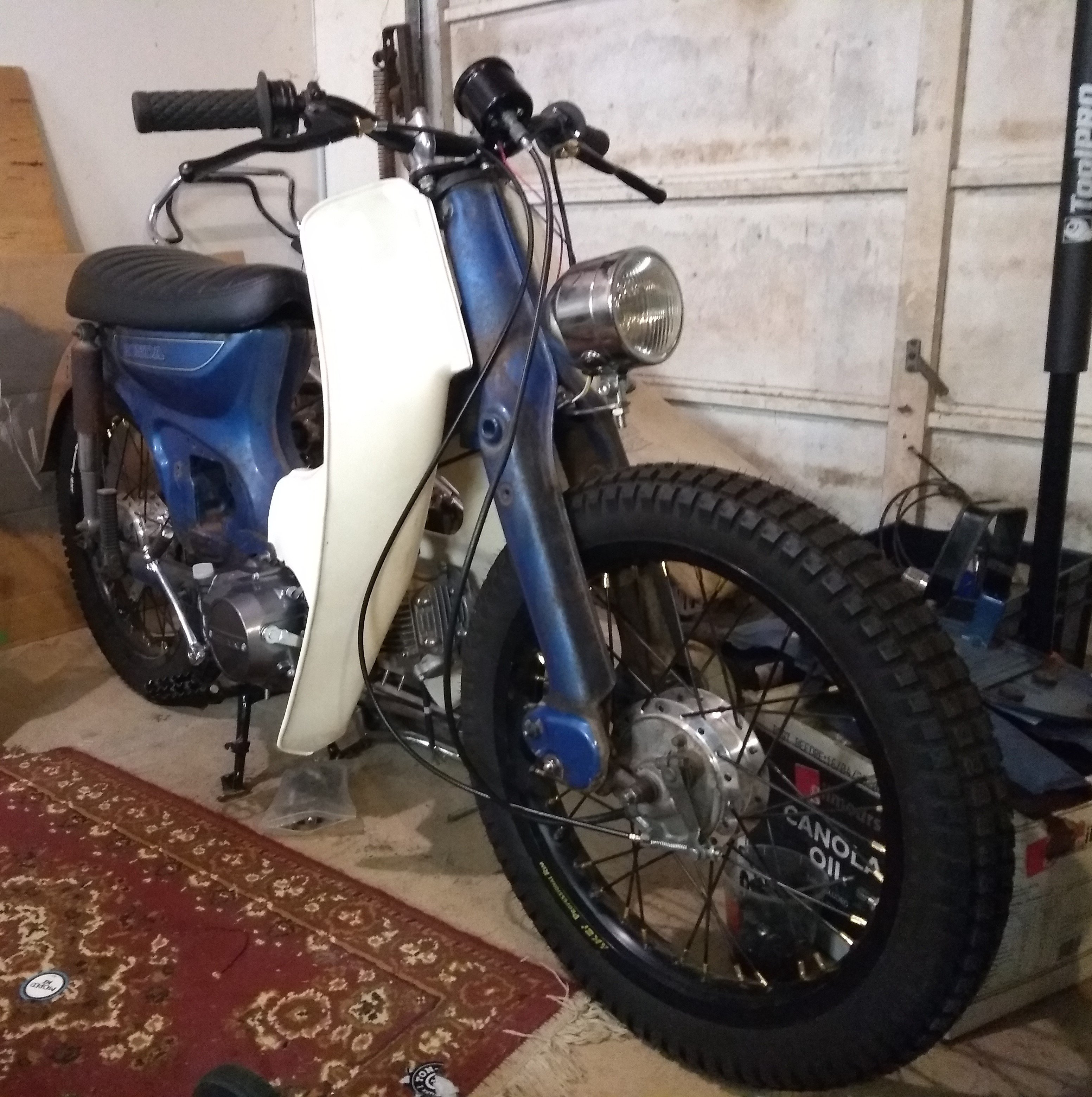

Popular Post KKtrips Posted September 24, 2019 Author Popular Post Posted September 24, 2019 Been doin a little bit here and there at Joe/Goat/Flanges on Tuesday night Bike night Still a tonne to do but as long as I knock off a couple things each week I'm happy with progress. Last couple of weeks I got the front wheel on, motor in, speedo, clutch and brake cables hooked up, foot brake and seat mounted plus slipped leg shield on (hole was in the PERFECT place tonight for the carb to poke out - didn't even need to cut it) and then remounted the speedo. Next week will be getting it up high in the air so I don't have to crucify my back each week, fit the accelerator cable, centre the rear wheel, mount the rear brake arm, button up the rear end, final weld up the rear guard and pump it out a little so the tyre doesn't rub. 15 Quote

KKtrips Posted October 15, 2019 Author Posted October 15, 2019 A little more progress. The side covers look BOSS!! Just ordered a bunch of other new parts, still a lot to do, all small shit, its just progress trying to figure out exactly what I need to buy. Next step is @kicker dragging his welder around to finish welding all the bits of steel together. 9 Quote
Chris.QCR Posted October 15, 2019 Posted October 15, 2019 Lookin good bruv ! Yeah those side covers look great ! 1 Quote
My name is Russell Posted October 15, 2019 Posted October 15, 2019 Wheels are on point! That grey/silver engine casing looks rad and that speedO setup too 1 Quote
