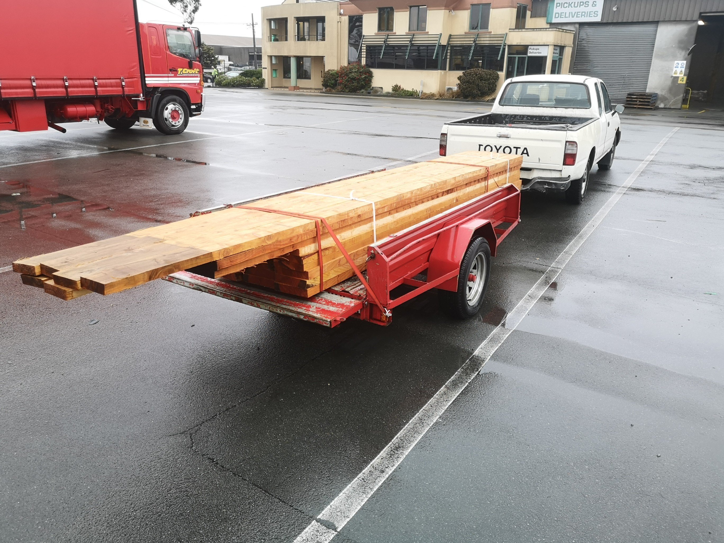

yetchh Posted June 19, 2020 Author Posted June 19, 2020 Also ordered the rest of the mac to go around the sub floor and cap the outside corners of the house .. Miffed at myself that I didn't order it last year as it took 3 months to season.. Picked it up today, so now I can finally "finish" the outside.. 6 Quote
