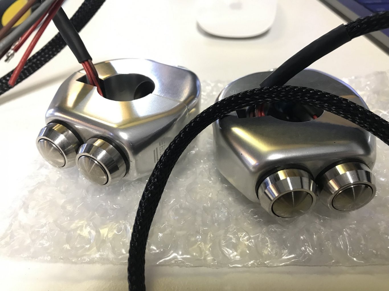

kdotlowe Posted April 15, 2019 Author Share Posted April 15, 2019 New cables arrived and seem to fit all good. Also got a set of these badboys. Essentially Motogadget knockoffs - definitely the nicest made product I've ever purchased off Ali! 7 Quote Link to comment Share on other sites More sharing options...

kseries.rookie Posted April 15, 2019 Share Posted April 15, 2019 2 hours ago, kdotlowe said: New cables arrived and seem to fit all good. Also got a set of these badboys. Essentially Motogadget knockoffs - definitely the nicest made product I've ever purchased off Ali! Do you have the link available for these? Out of curiosity - how will you run the buttons? Lets say for example, the left side.. Top button = left indicator - press again and it's off Bottom button = Right indicator - pretty again for off What about the other side? You will need high beam, pass, horn, engine on, engine start So much cleaner with the small controls but keen to hear the logistics of running these chur 1 Quote Link to comment Share on other sites More sharing options...
kdotlowe Posted April 15, 2019 Author Share Posted April 15, 2019 3 minutes ago, kseries.rookie said: Do you have the link available for these? https://www.aliexpress.com/item/CNC-Momentary-Latching-Switch-Aluminium-Alloy-Switch-Motorcycle-Cafe-Race-Handle-Grips-Reset-Buttons-For-Honda/32844235133.html?spm=a2g0s.9042311.0.0.5fb84c4dskXaG1 They're not cheap! You can also choose latching or momentary buttons when you purchase. I'm using momentary to work alongside an M-Unit. And good question. I will be using a Motogadget M-Unit to wire the motorcycle which takes care of most of the below functions. Here's an idea on how I think will run them. Left side Top button: Left indicator. Press to start, press to stop. Will time out after 30sec. Bottom button: Horn. Back button: M-Unit Config.Right side Top button: Right indicator. Press to start, press to stop. Will time out after 30sec. Bottom button: Headlight. Always on. Tap to flash highbeam, hold down to turn on highbeam. Hold down longer to turn headlight off. Back button: Not assigned as of yet. Maybe electric starter if I decide to get that working or a momentary kill switch. Hope that all makes sense! 3 1 Quote Link to comment Share on other sites More sharing options...
kseries.rookie Posted April 15, 2019 Share Posted April 15, 2019 Crystal clear. I did wonder if you were going to run the m-unit along side the buttons. I love the simplicity of their stuff. Not in terms of wiring cause fook dat, but such a smart simple device. I like the time out of the indicators but 30 seconds might feel like a lifetime? Those buttons aren't too bad, especially concidering the OG motogadget ones have a heavier price tag. I love the M-Lock. I saw a bloke put the little cylinder thing inside a guitar AUX type plug and then the female side on the top yoke. He would push in the plug into the female side and that would effectively be his key. Does that make sense? So genius and such a cool little custom modification Im eager/excited to see the whole process with the wiring and all Keep us posted 1 Quote Link to comment Share on other sites More sharing options...
kdotlowe Posted April 15, 2019 Author Share Posted April 15, 2019 I agree, 30 seconds is ridiculously long. I forget to turn my indicators off half the time anyway haha. I don't currently have a solid harness so wiring one with the M-Unit should be more straight forward. Inputs in one side, outputs on the other. And it's even easier if you run the M-Button. It's just the price which is a bit hard to swallow! Quote Link to comment Share on other sites More sharing options...
Lord Gruntfuttock Posted April 15, 2019 Share Posted April 15, 2019 I'm running a Badlands flasher module on the ironhead that times out after 11 secs. This is fine for normal turns but sucks when you're at an intersection and you have to keep hitting button. I'd rather have no timer but 30 seems a good compromise, long enough to let you sit a while, yet turns off if you forget... 3 Quote Link to comment Share on other sites More sharing options...

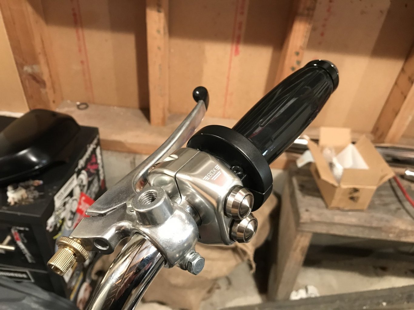

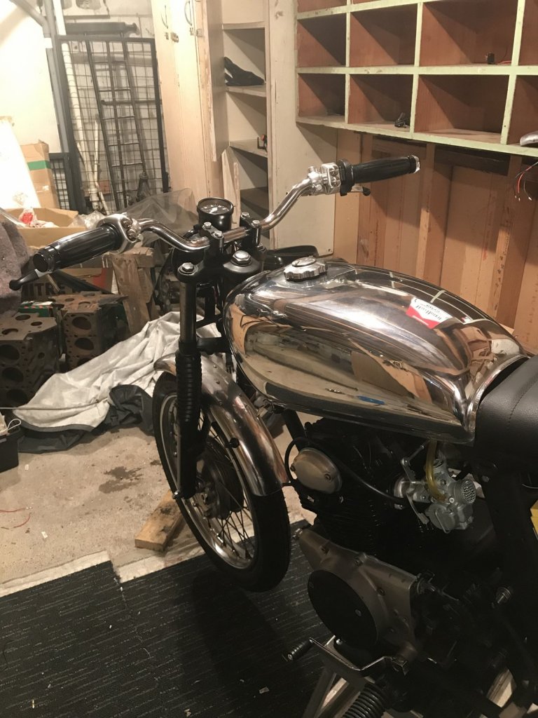

kdotlowe Posted April 19, 2019 Author Share Posted April 19, 2019 Installed the controls today by routing the cables through the bars. Pretty tricky but if you were good at the boardgame 'Operation' as a kid I'm sure it'll be a breeze. 4 Quote Link to comment Share on other sites More sharing options...
AllTorque Posted April 19, 2019 Share Posted April 19, 2019 Looks good. Can you still pull the brake lever in all the way? 1 Quote Link to comment Share on other sites More sharing options...
kdotlowe Posted April 19, 2019 Author Share Posted April 19, 2019 1 minute ago, AllTorque said: Looks good. Can you still pull the brake lever in all the way? Sure can. It's hard to see from that angle, but the end of the lever bottoms out on the grip. It actually clears that back button by a few millimetres. 1 Quote Link to comment Share on other sites More sharing options...
kseries.rookie Posted April 19, 2019 Share Posted April 19, 2019 That looks clean! 1 Quote Link to comment Share on other sites More sharing options...

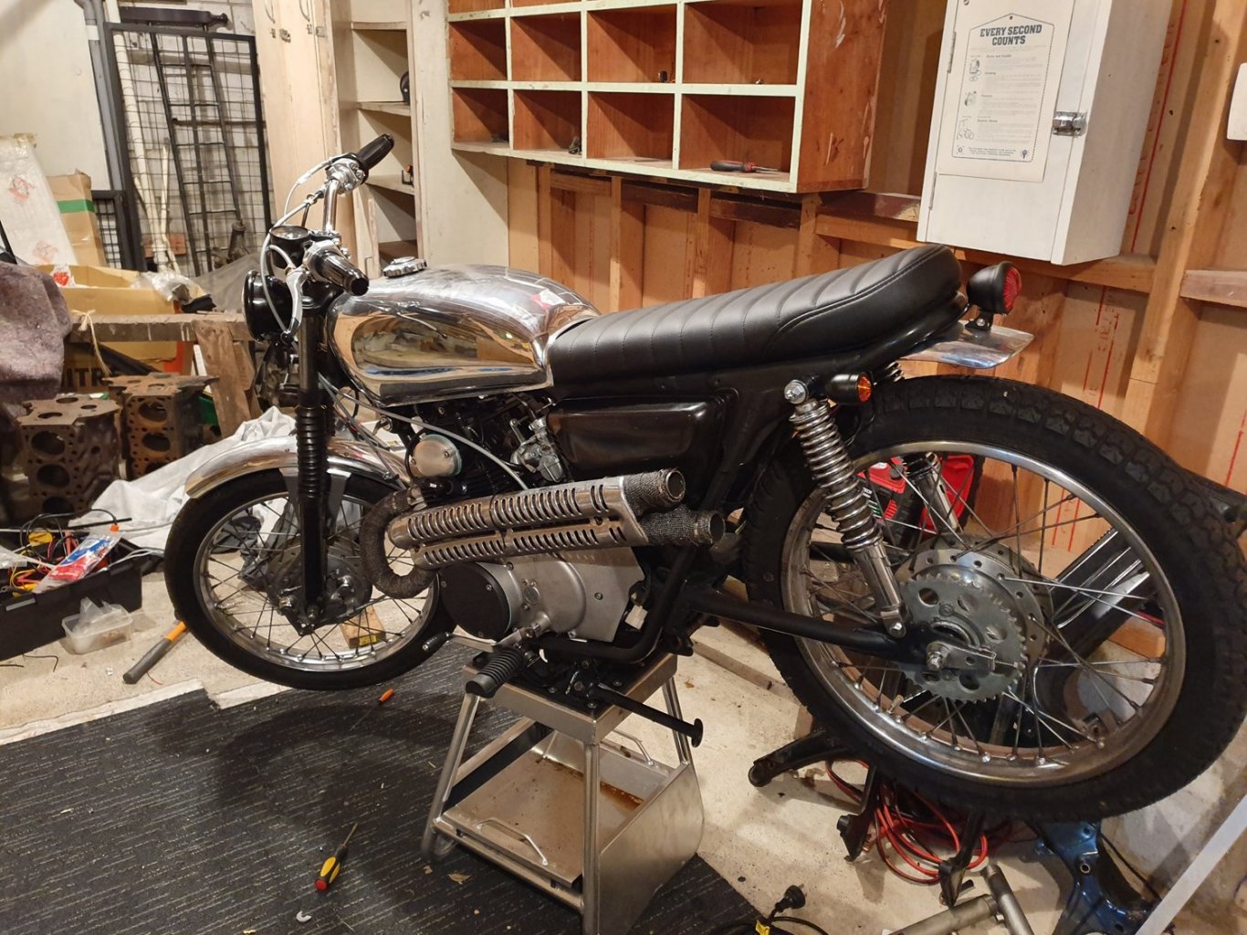

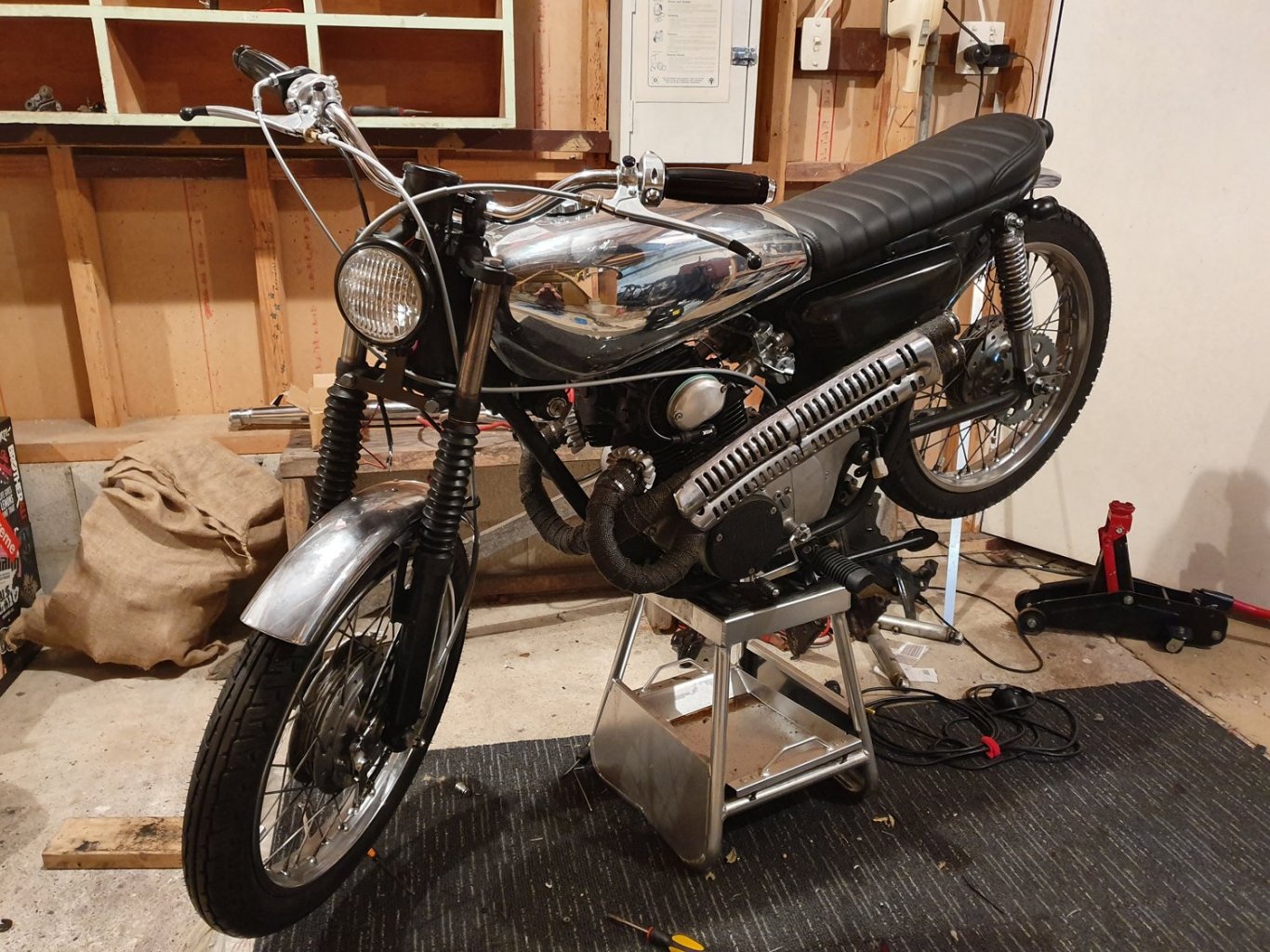

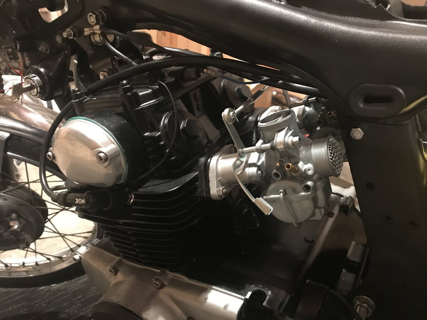

kdotlowe Posted April 22, 2019 Author Share Posted April 22, 2019 Installed the carbs today. She's really coming together. Not to much to do now Purchase and install M-Unit + finish wiring. Fabricate a number plate bracket and rear indicator mounts. Install tachometer blanking plug. Maybe purchase new tires (I'm wanting something dual sport). Fill with oil, set points and timing and start her up! 9 Quote Link to comment Share on other sites More sharing options...

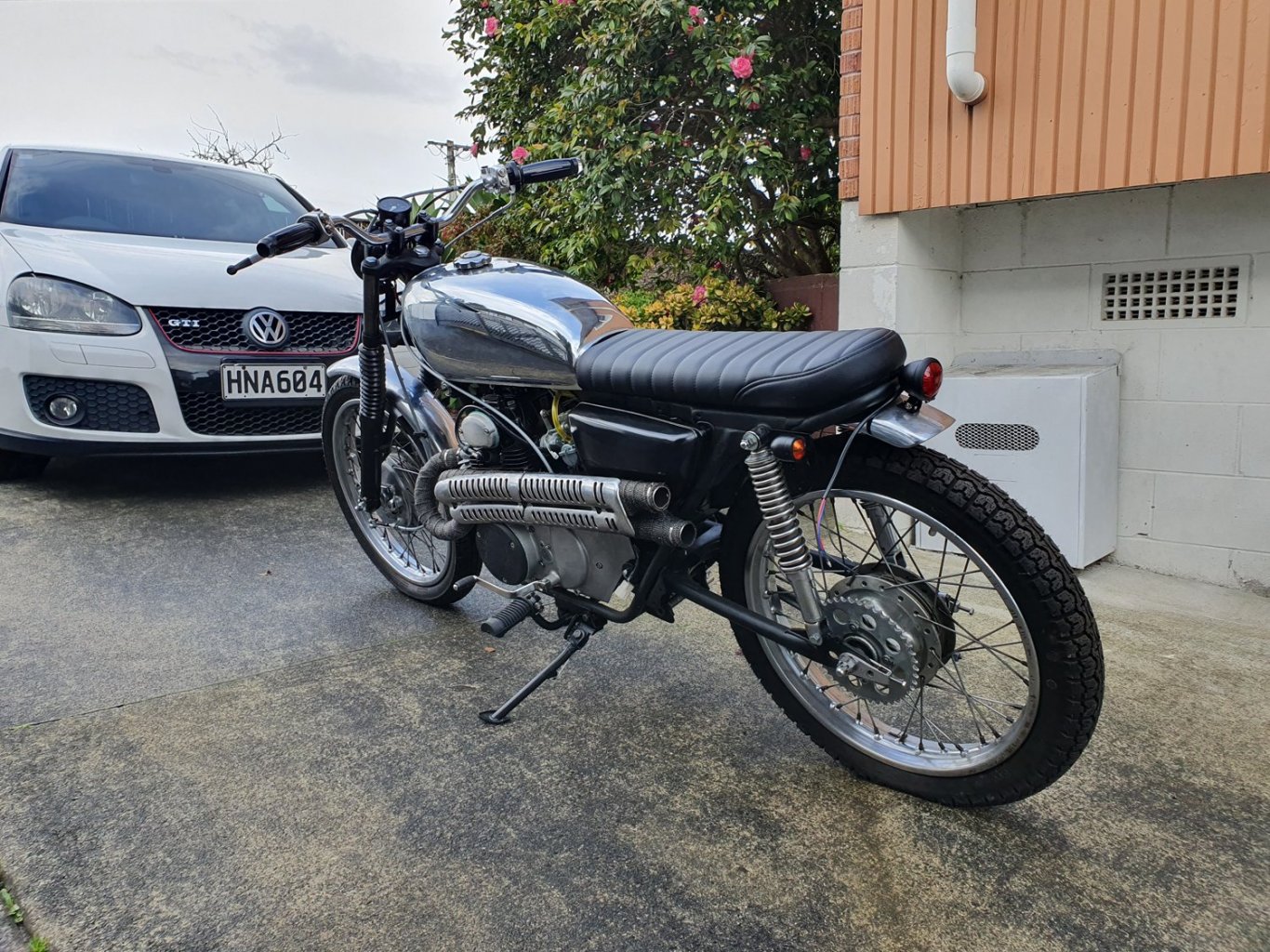

Popular Post kdotlowe Posted August 10, 2019 Author Popular Post Share Posted August 10, 2019 Oh yeah, so this thing is pretty much done. Wiring is in place. Just need to splash out on the M-Unit to finish. I'll probably try tidy up the control cables somehow and also fit some nice exhaust tips to my cut pipes. 11 Quote Link to comment Share on other sites More sharing options...
Shakotom Posted August 10, 2019 Share Posted August 10, 2019 Man that is beautiful. good work! 1 Quote Link to comment Share on other sites More sharing options...

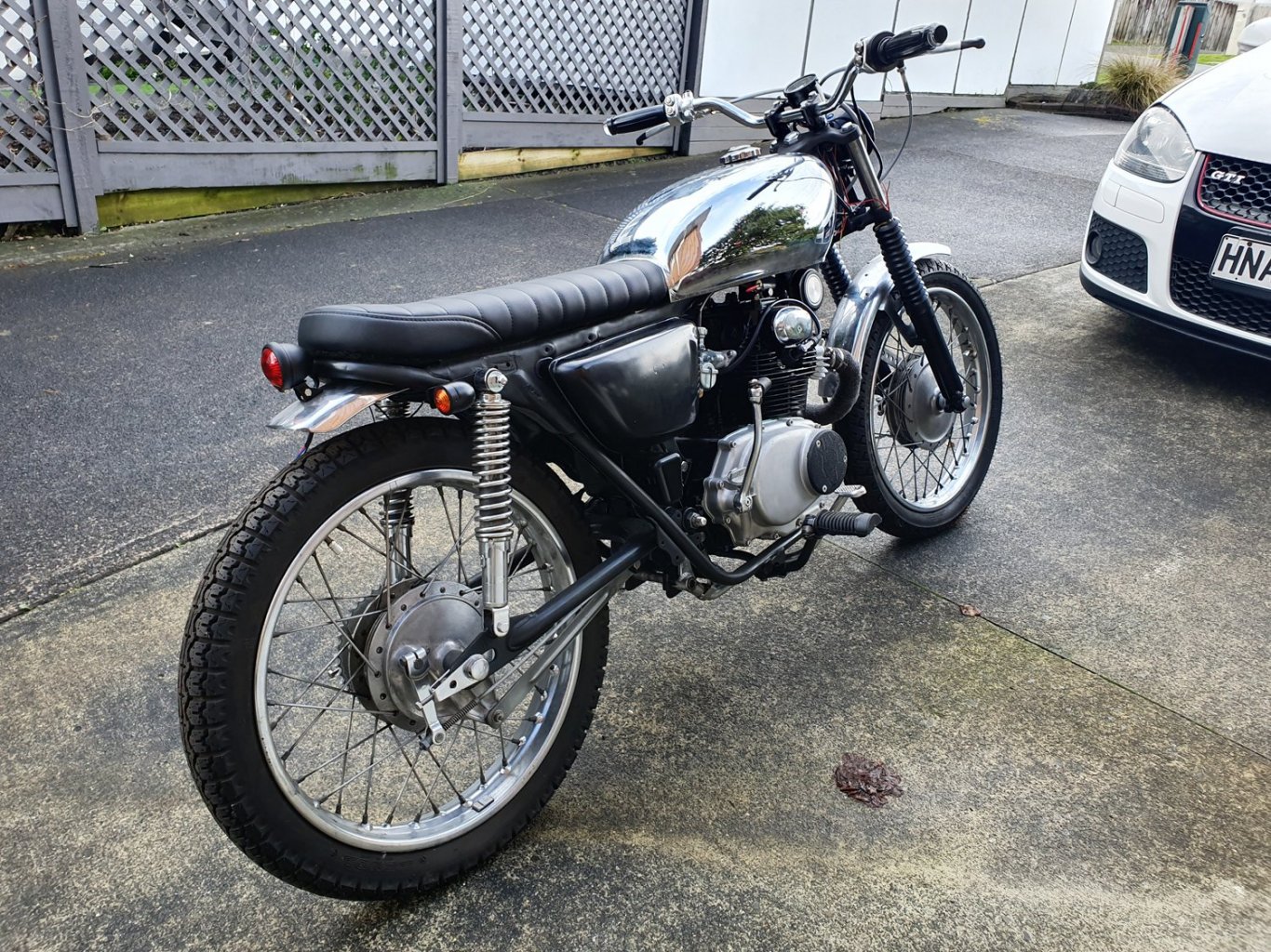

Popular Post kdotlowe Posted August 10, 2019 Author Popular Post Share Posted August 10, 2019 First time it's seen daylight in about 3 years. Have just discovered a leaky rear shock so I guess I have to throw some more $$ at it haha. 18 Quote Link to comment Share on other sites More sharing options...
