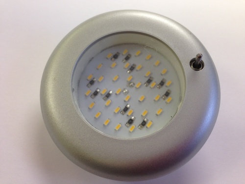

kempy Posted March 30, 2015 Author Posted March 30, 2015 Just for comparison, I grabbed one of these too see what they are like, Bright!, it's like having a small floodlight on the ceiling. Decided to go down another route as it was a bit over the top and I don't like the idea of an upside-down cigarette ash tray on the ceiling. Ended up grabbing a bunch of these with white surrounds, I can switch them off separately to the wall switch if it's too bright. 1 Quote
felixx Posted April 9, 2015 Posted April 9, 2015 those LED lights are great eh! I have 3 x 2W puck lights in mine and it is amazing bright! (although mine is much much smaller) Quote
