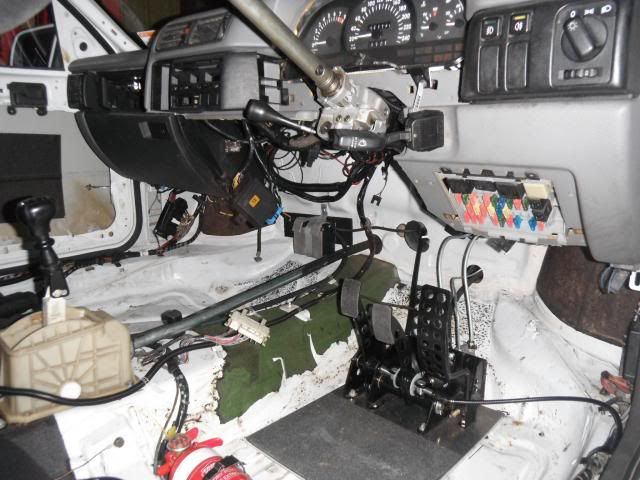

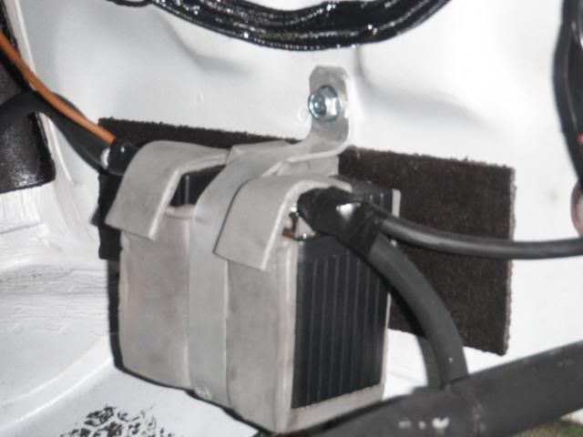

mikuni Posted September 4, 2013 Posted September 4, 2013 As per the other thread, I'm using a Shorai bike battery in my race car. http://shoraipower.com/ They are expensive, mine was around the $250 mark and it is a little undersized for a normal car, but bear in mind it is a race car. I'm removing all of the electrics except for the windscreen wiper motor and I've removed a blade to reduce friction. Headlight bulbs have been replaced with LED bulbs and I might take them out altogether. For a road car with electrics you would need a much larger battery, but most older cars should be fine with a small one. This is my battery To give you an idea of the size - that's the battery in the distance on the firewall This method is good to reduce cable lengths and weight, and my battery weighs 764 grams, when my car battery was 14kg and a small SLA battery was around 5kg. 1 Quote
