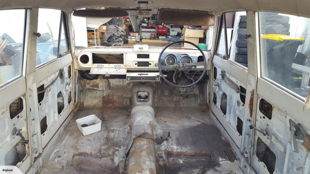

Bugger all progress. I have ordered new sills, boot floor and other repair panels for the boot from Ex Pressed Steel in the UK. The front panel is still an issue and I’ve been trying to get this Mk 1 in Tauranga that’s on Trademe. It’s an auto plus it’s deregistered but the guy that owns it still thinks it’s worth 5.5k. Ive offered him 2.5k but he’s not budging..
