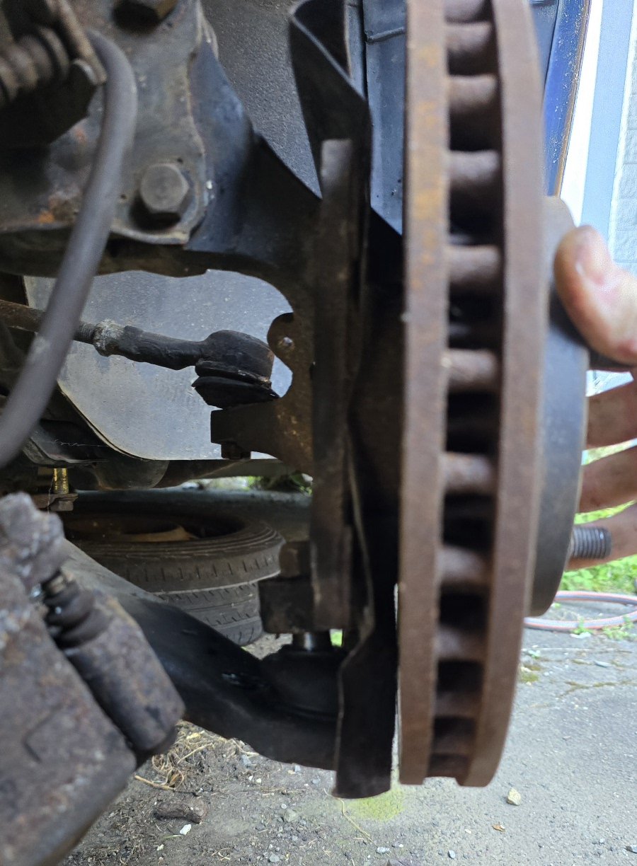

Found a 5 stud FTO at pick a part, read on an old forum that they are a direct bolt on.

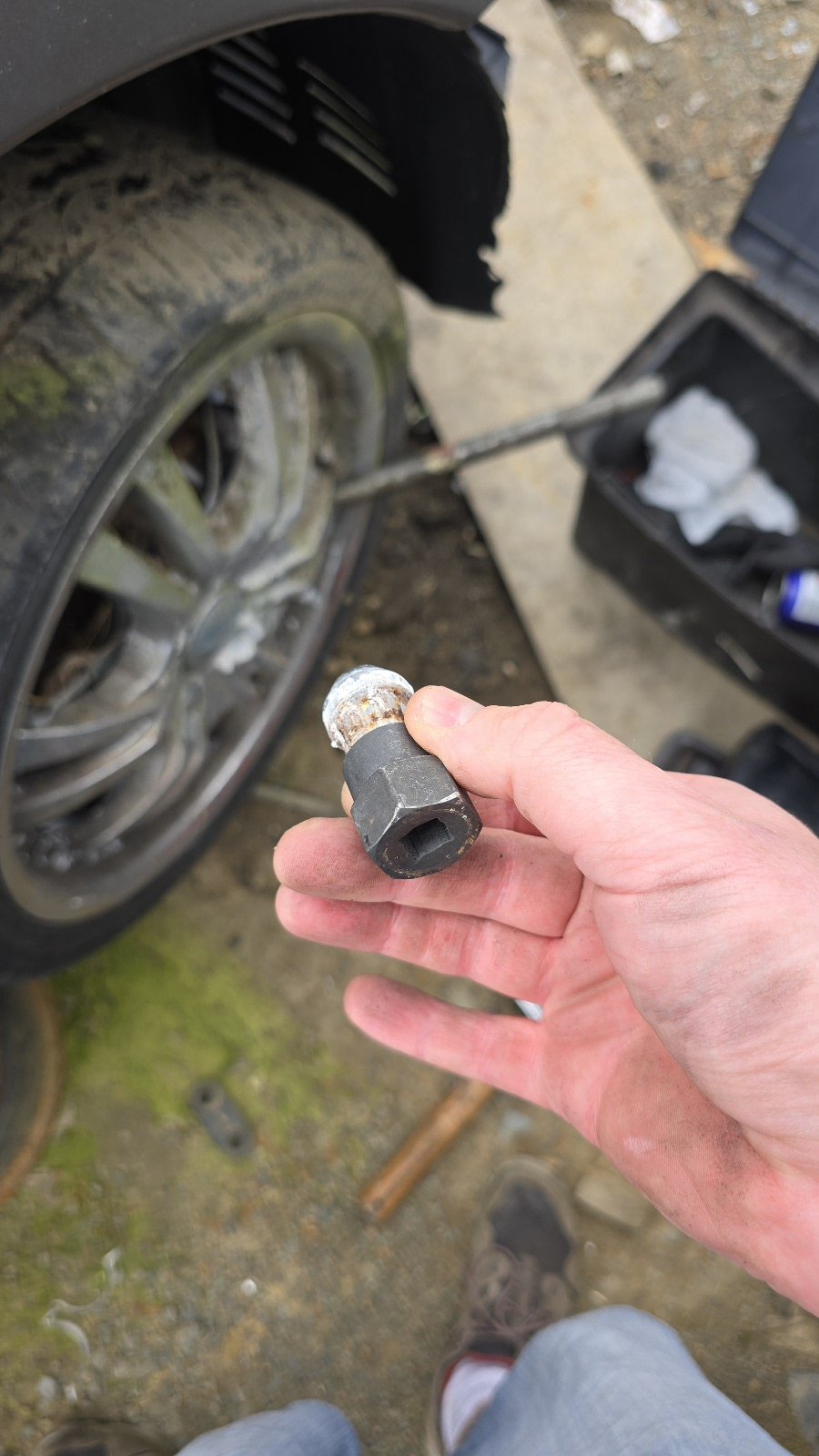

Went to go get them and found the wheels still on the car with lock nuts. Annoying, tried getting them off but ended up get a set of these lock nut removal sockets that you hammer on.
Went back a few weeks later and got them off.
All bolts on and correct width to mount to the struts, low ball joint is correct etc.
Interestingly the backing plate has 4wd stamped in it, even though it's a fwd FTO.
Out of interest I tried fitting some s14 280mm rotors and they almost fit. Centre bore is right but touches the back plate a bit. Easy fix but will most likely use mitsi rotors.

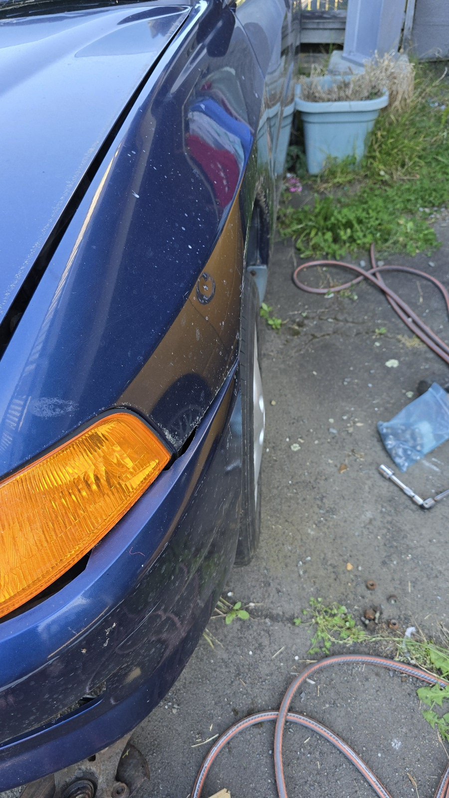

Also found a replacement monsoon shield.
