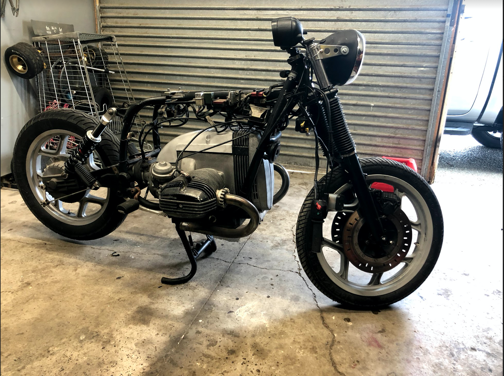

Popular Post Mitch.W Posted March 28, 2020 Popular Post Posted March 28, 2020 so I've always liked the look of these things and always wanted to own one and have been keeping my eye out for one to chop up for a year or so and this finally popped I up at a reasonable price. its rough cosmetically and has done 130k's but it seems alright mechanically (apart from standard bmw oil leak things) and was the right price most importantly. I've been hoarding parts slowly for this thing since I got it waiting for winter to roll around to start ripping into it, but this forced holiday thing kinda made me just rip into it now since I'm bored, I started off today by tearing the bike apart and pretty happy I found no horrible surprises, plans are to make a new subframe for it, some different tires, simplify everything as much as possible and make it loud and uncomfortable to ride. I didn't actually have any before photos, but picture a r80rt with a naked front end and massive 150mm banana handle bar risers that bring the bars to the middle of the tank and bars with a 5" rise on them too, and cracked plastics all round with a spray can paint job. what it looks like as of today, will pull the motor tomorrow and give it a coat of black, I slapped on the airbox delete on it to see what its like, last part I need at the moment is a 22mm 180degree bend but cannot seem to get one in this lockdown we have going on! need some peanut rocker covers, repaint the tank and detab and powder coat the frame, depending on how rich I'm feeling I kind of want a motogadget electrics setup, they are super nice units but are rather spendy. 12 Quote
