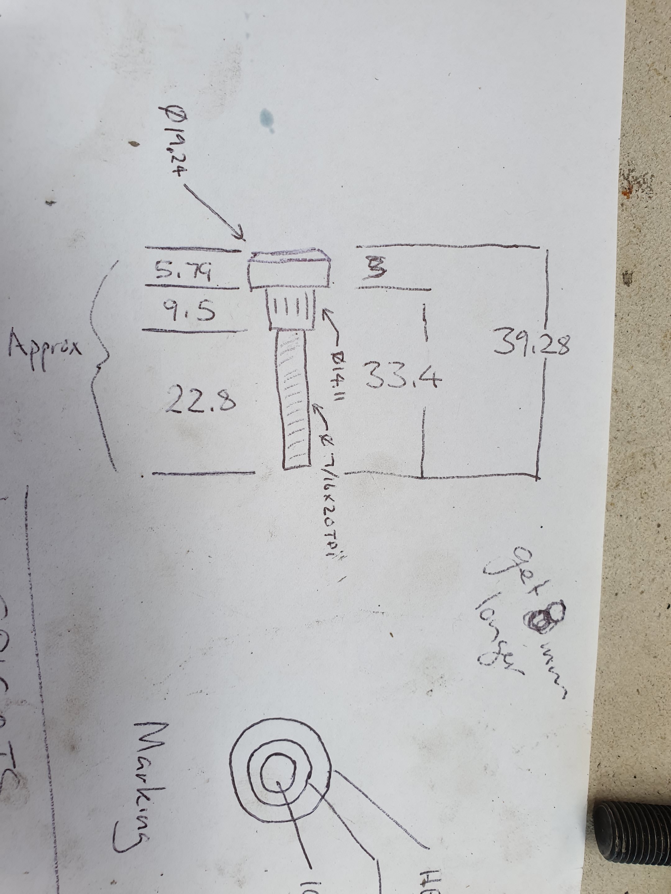

Kimjon Posted October 13, 2019 Posted October 13, 2019 This is what I've got in the front, I'm after 10 of these...but about 5-10mm longer. The rear is similar, but the spline section is much smaller. Haven't got measurements on hand. Thread is 7/16x20 on all of them. Also after 4x concentric hubs to locate my wheels on the hubs. Wheres a good place to find this stuff??? Google searching is drawing blanks in nz. Quote

Kimjon Posted October 13, 2019 Author Posted October 13, 2019 Okay - rears are sorted. Still after the front ones...soooo...anyone got a go to place? I've never thought of it before, but every old car with aluminum mags will likely need this done. Steel rims are only about 5mm thick, whereas aluminum wheels are more likely to be 20mm or thereabouts...so makes sense in hindsight. However I suspect, like me, most are oblivious to this. 1 Quote

Kimjon Posted October 18, 2019 Author Posted October 18, 2019 Fyi, for anyone in similar situation: Finding extended 7/16x20 with a GM sized knurl for the front is a struggle in nz. Ordering from USA works out about $60...but looooong delivery times. Or extortionate postage if you want them fast. Nice, or ARP etc from most places are about $17 each stud for a set. So $340! Conversion to metric was an option, just need to drill out the hubs a fraction, but would be easy to do. $90 for 20 studs, plus new metric nuts to suit another $40, was seriously considering doing this. However I found Earl's body shop has them for about $6 each...winner! Quote
