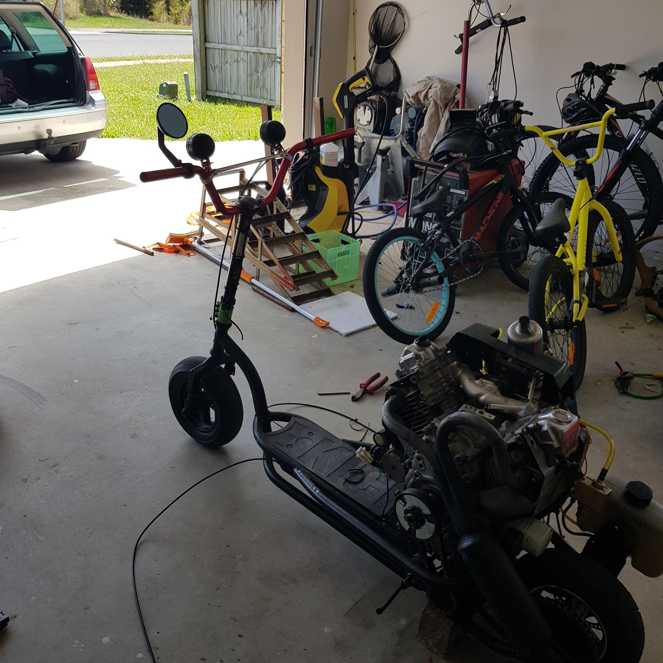

Muncie Posted January 7, 2019 Author Posted January 7, 2019 So i got creative today..... One last snap before plugging in the 9" Quote
Muncie Posted January 7, 2019 Author Posted January 7, 2019 No turning back now...... at this stage i decided you know what im sick of it having no deck room and flexing so made the decision to lenthen it 250mm Quote
Muncie Posted January 7, 2019 Author Posted January 7, 2019 What a dumb idea.... got there in end i wanted some decent rake and option of a seat so was worth it. Getting everything where it needed to be took fucking ages! The extensions are sleeved with steam pipe heavy as fuck but its solid as now. 1 Quote
Muncie Posted January 7, 2019 Author Posted January 7, 2019 Almost done its ridable everything is hooked up just misted it with black and called it a day. What a massive job. 7 Quote
