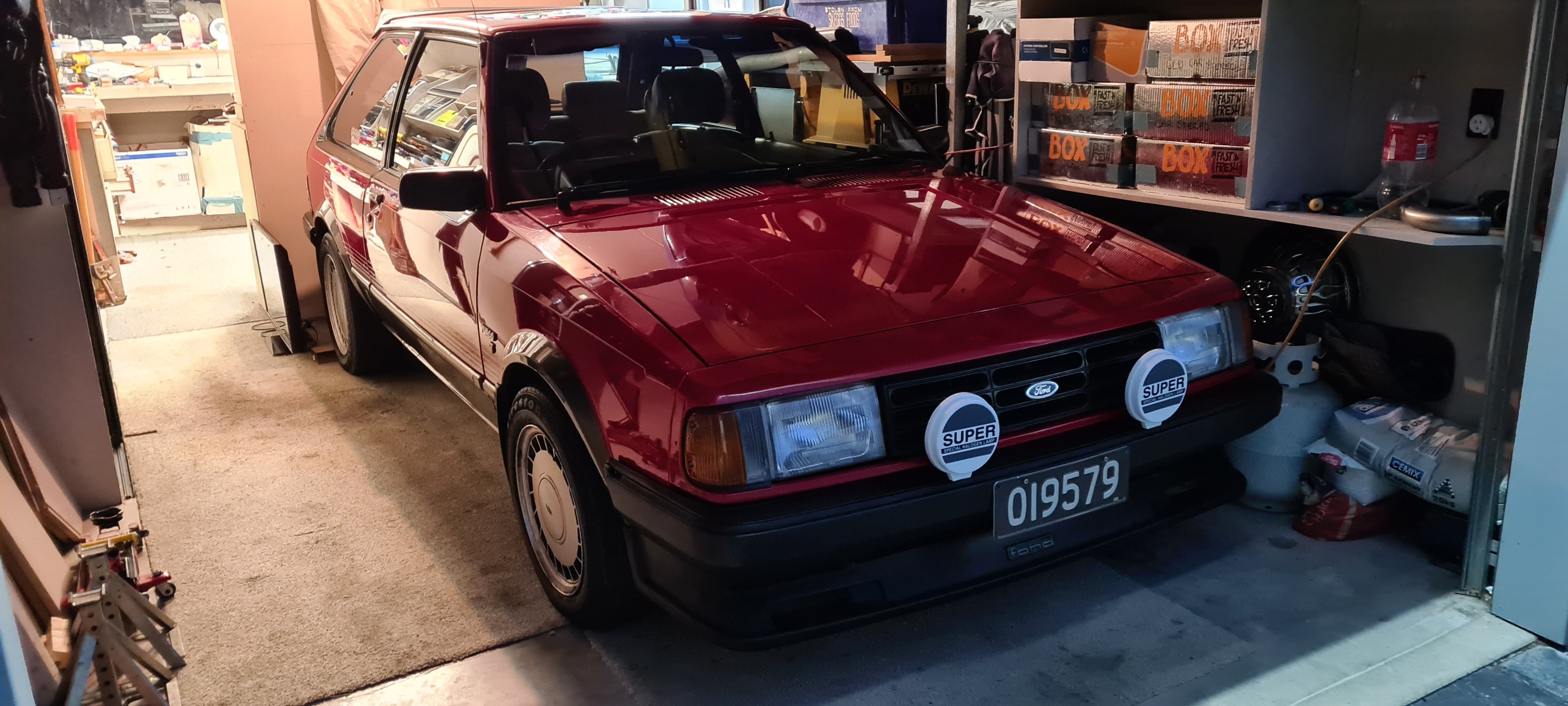

Popular Post Paulluap Posted October 12, 2018 Popular Post Posted October 12, 2018 Laser back on the road again for summer, with a matching car to now. 10 Quote

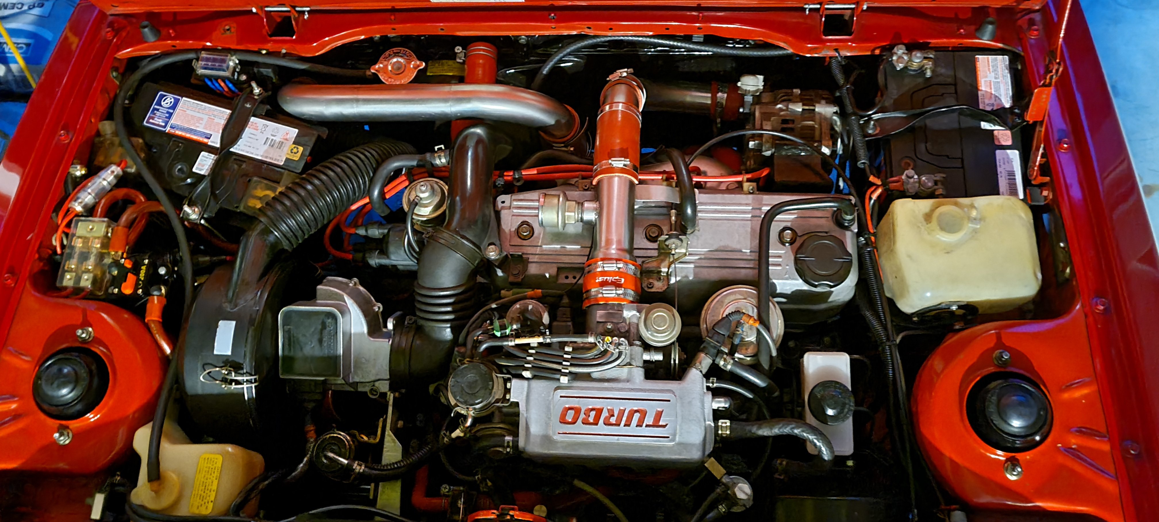

Popular Post Paulluap Posted January 20 Popular Post Posted January 20 Hi Guys Been awhile 🤔 but after nine years I finally have the original motor back in. Motor rebuilt E5T, all new water pipes, hybrid turbo VF10, rebuilt radiator. Stereo has an upgrade as well with a bit more motorised stuff 😄 1994 mini disc player which matches my 1995 head unit, new gauges, video and SD card music. 13 1 Quote
