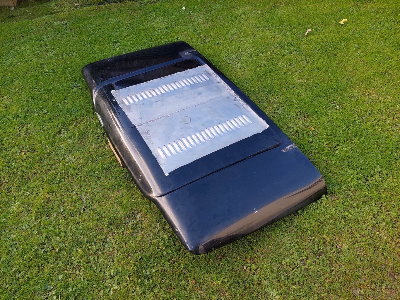

Alfashark Posted June 7, 2023 Share Posted June 7, 2023 Nah, he's throwing a radiator up the front. 2 Quote Link to comment Share on other sites More sharing options...
Raizer Posted June 7, 2023 Share Posted June 7, 2023 13 minutes ago, Tiger Tamer said: So the Imp engine is out of the rear and you have louvers in the boot which you call a bonnet, so it must mean you are going front engine ?. Front wheel drive ?. Front radiator conversion, have to let the hot air out somewhere etc. 3 Quote Link to comment Share on other sites More sharing options...
Alfashark Posted June 7, 2023 Share Posted June 7, 2023 Yeah, likely a lot less room up the front of an Imp compared to a Skoda Estelle but they survived fine without louvers or slots. Quote Link to comment Share on other sites More sharing options...
Tiger Tamer Posted June 7, 2023 Share Posted June 7, 2023 5 minutes ago, Raizer said: Front radiator conversion, have to let the hot air out somewhere etc. That has given me a idea for a heater for the Minx as I have lost the heater mount space by moving the Honda engine back as far as possible. Though I was hoping he was doing a high hp Turbo front wheel drive conversion 2 Quote Link to comment Share on other sites More sharing options...

dmulally Posted June 7, 2023 Share Posted June 7, 2023 15 hours ago, Alfashark said: Nah, he's throwing a radiator up the front. Correct. Installing the front mounted radiator with twin thermo fans and a davies craig water pump which deletes the thermostat. I have to convert to an alternator at the same time however to keep up with the new power demands. 2 Quote Link to comment Share on other sites More sharing options...
