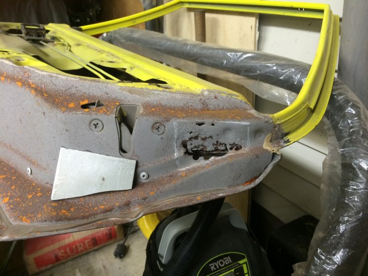

previous person who had done work on it used pop rivets to hold all the door rubbers in. only doing the spots that are showing rust atm best thing would be to unstitch the inside of the doors and redo all of it but thats a massive job. remeber you cant stop rust it will always come back in these cars all i can do is pervent it and fix the bits it has. -
Thought I better start doing some real work done on this car Like rust repairs Started out by making some patches for one of the doors so they can Be welded in One of the tricks I found on how to create a radius No screwdrivers were harmed in this event Got my Ol mate Jim to keep me going
