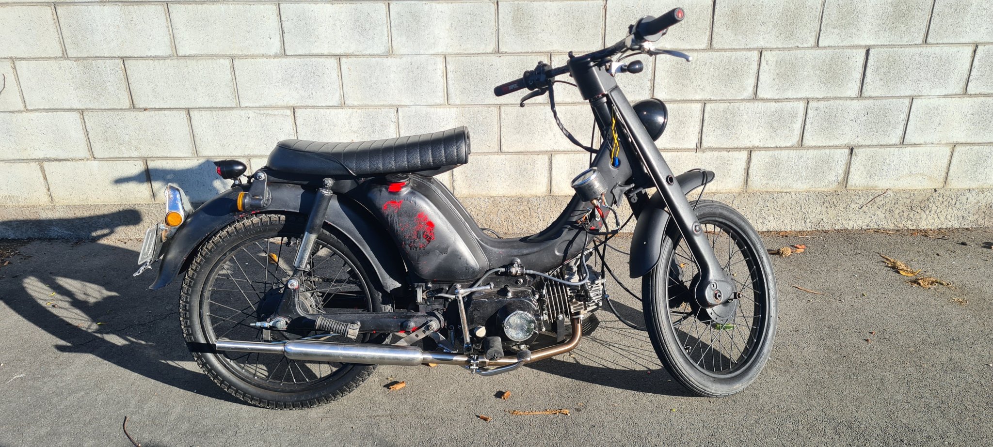

felixx Posted August 19, 2024 Author Posted August 19, 2024 Well after removing a kink in the fuel line, I put a new, less rowdy exhaust on it It looks betterand still does 50mph I guess thats as much as I can expect without changing sprockets etc 4 Quote

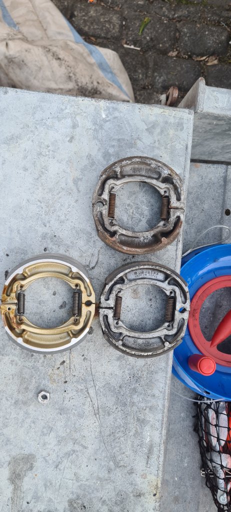

felixx Posted August 21, 2024 Author Posted August 21, 2024 Wheels off, new brakes fitted I am just waiting for Postman Pat to drop off 2x golden boys and tubes.. Old brakes did not seem too worn but hey new brakes, tyres, led bulb and indicators all at the same time is good. Quote

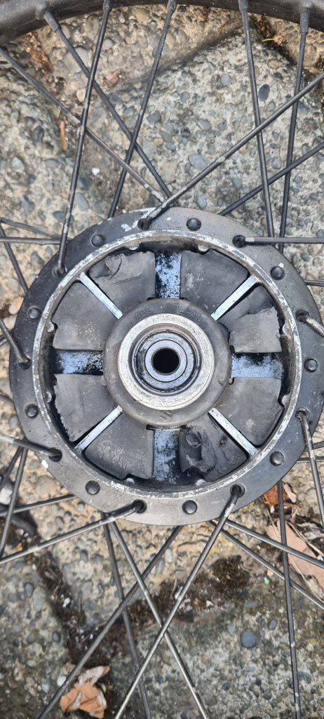

Raizer Posted August 21, 2024 Posted August 21, 2024 4 hours ago, felixx said: Old brakes did not seem too worn Neither did mine on my 140, till the glue bonding the friction material on completely let go and the front wheel locked solid lol 2 2 Quote

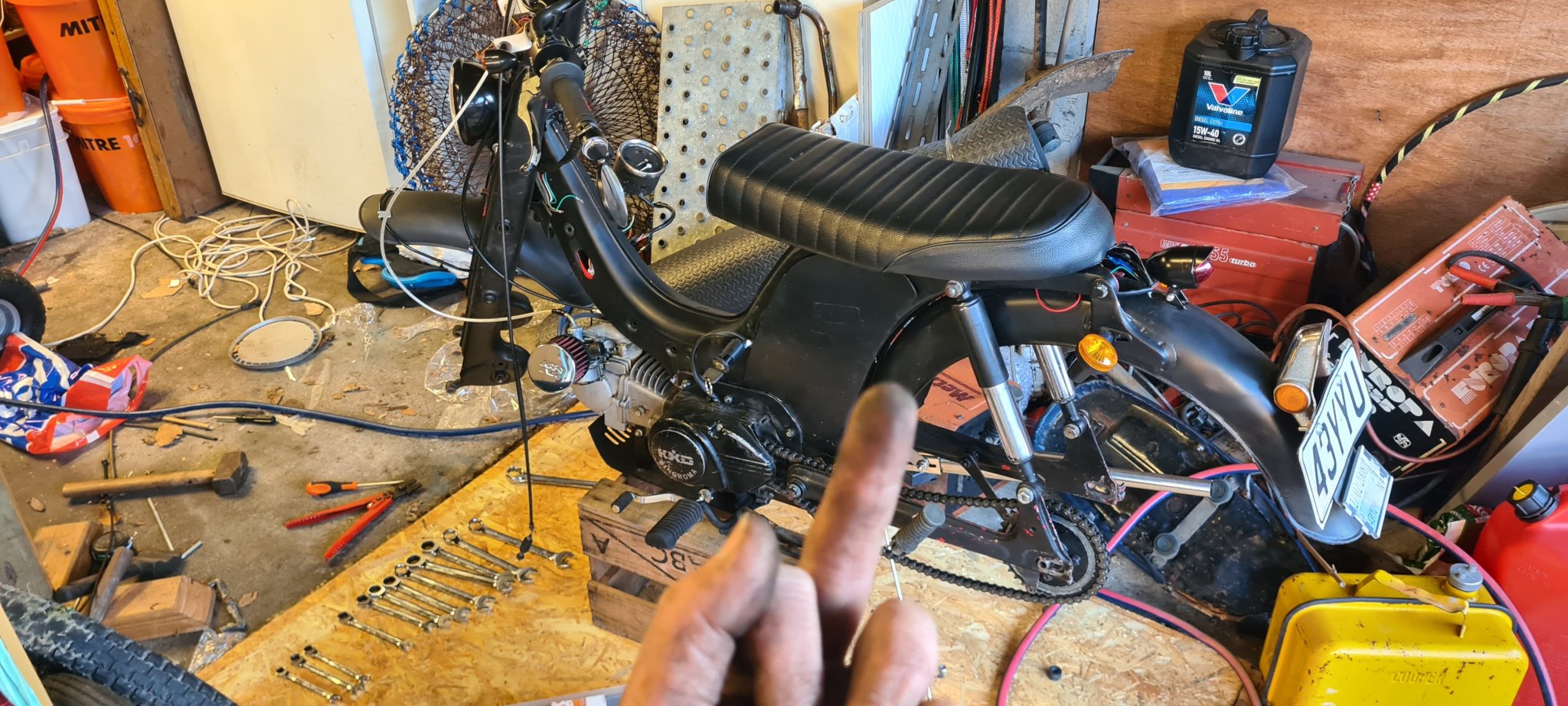

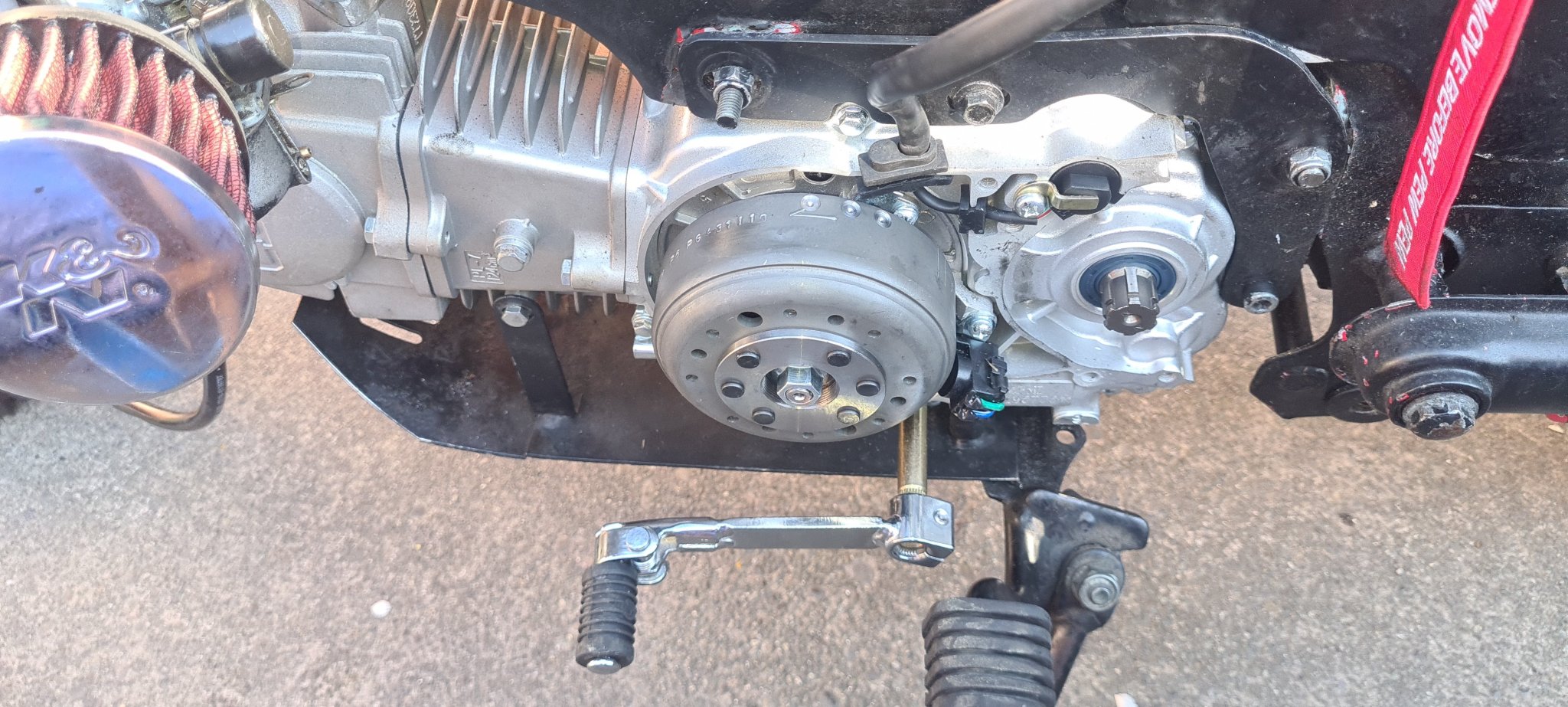

felixx Posted September 1, 2024 Author Posted September 1, 2024 So yesterday I was grabbing 4th gear in this when the front wheel locked up. (Will be checking brakes later), but I think my dront guard moved and fouled something. Anyway I flew over the bars and did the rolly polly thing. (One toe is purple and my upper body aches) Anyway on the 500m ride home(1st gear, 10kmh) I a fair amount of oil. (200ml drained in 10.min at home) Luckily I had a new, unrun lifan 125 put aside (well purchased on tuesday) So I jammed it in. It ran for 2 min on 1/4 throttle after a reluctant start. (Used ether) But the exhasust header got very hot and the bike wouldnt idle. I tried lifting ttheneedle 2 notches and cannot get her to start. I wonder if there is a timing issue or something Quote
felixx Posted September 1, 2024 Author Posted September 1, 2024 Also my new engine has 428 pitch sprockets, so I will go to.mbike and get a new rear and chain this week. New rear shocks are ordered. I will get some fronts from ali then all.mechanicals and electrics are new. Quote
GregT Posted September 1, 2024 Posted September 1, 2024 That hot pipe suggests it's retarded. Does it have a mechanical adv/retard or is it done in the ignition box ? I've struck a Suzuki setup where swapping the pickup wires over gave fixed full advance. All wiring correct ? Quote
felixx Posted September 1, 2024 Author Posted September 1, 2024 How do I check the timing? Im pretty ignorant. Motor is lifan and loom is all lifan /china spec. Quote
GregT Posted September 1, 2024 Posted September 1, 2024 See if there are any marks on the flywheel. T forTDC F with possibly two marks -full advance one end and idle/retard at the other. Then put a timing light on it. As a minimum it should advance as the revs rise. If it doesn't I'd contact the seller and see about a swap. Quote
felixx Posted September 1, 2024 Author Posted September 1, 2024 Those marks are on the flywheel. But I cannot get her running to use a timing light. I guess I better get a bloke in lol Quote
felixx Posted September 4, 2024 Author Posted September 4, 2024 Well @GregT came round and we got her running. But only with the choke on. Thank you @GregT. I appreciate your help Idle speed screw all the way in, so idle should be fast.. Quote
Raizer Posted September 4, 2024 Posted September 4, 2024 You likely just need a bigger pilot jet. Or better still a non China carb. Quote
felixx Posted September 4, 2024 Author Posted September 4, 2024 I cleaned the carb again. Got it going better but she whistles. Is that inlet or exhaust?? Quote
GregT Posted September 4, 2024 Posted September 4, 2024 I thought it was inlet. An air leak would explain a lot. Quote
felixx Posted September 4, 2024 Author Posted September 4, 2024 12 minutes ago, GregT said: I thought it was inlet. An air leak would explain a lot. Will try to tighten the bolts more .. dont want to damage studs Quote
GregT Posted September 4, 2024 Posted September 4, 2024 Nothing wrong with a good coat of RTV each end of that manifold. 1 Quote
