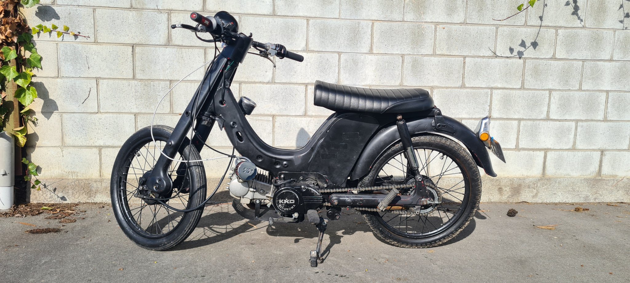

So I acquired this tonight..
It looks like a beast
Facebook marketplace special..
Just need to pick up an extra link on the chain and a couple of bits.
Reg on hold as 50cc.

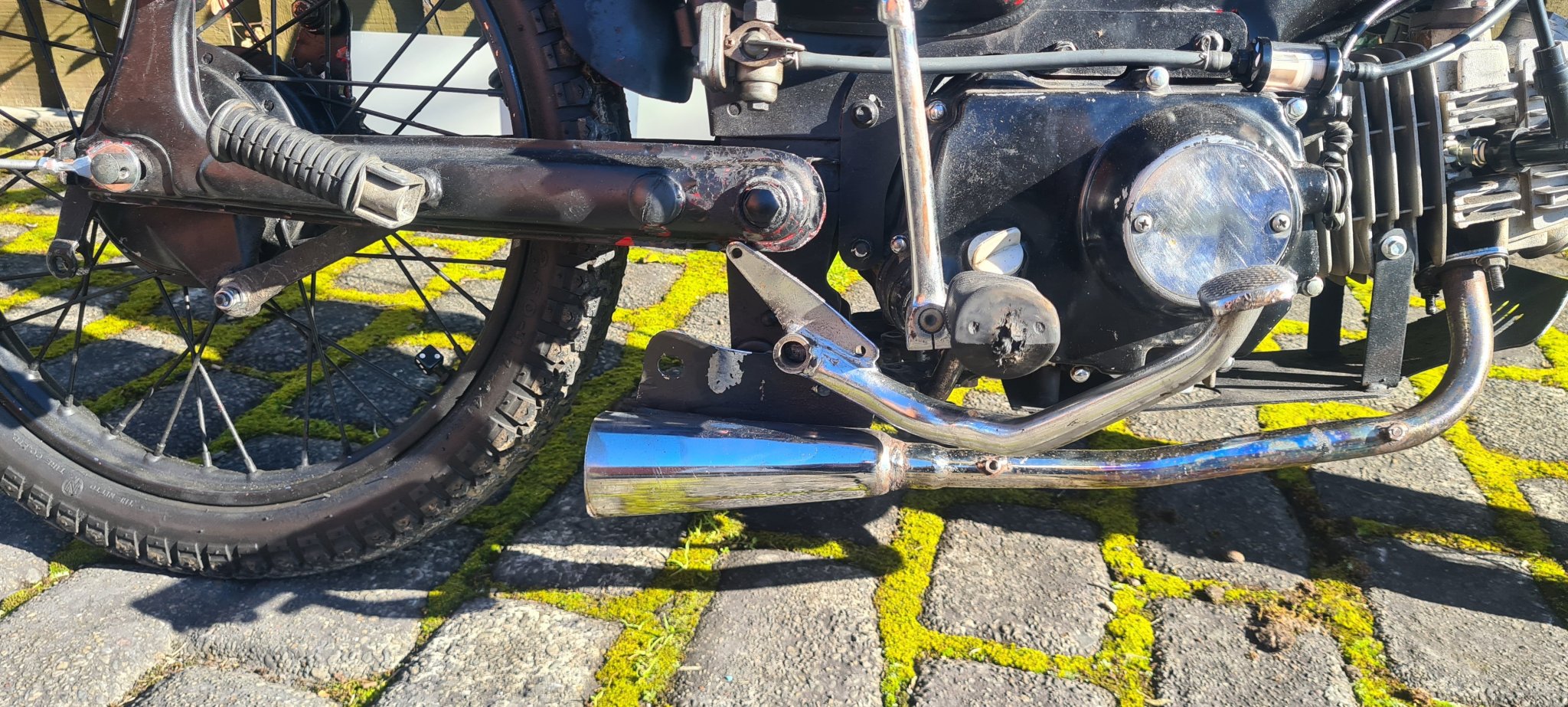

Also does anyone have an exhaust for a f50 as mine has had all the baffles removed (loud pipes save lives but this is very loud)
Max rowdy installed...

Well I have it running.
Front and rear brakes work.
Quiet exhaust pipe fitted (for now)
Fuel petcock un clunged and fuel filter on the right way
Just went for a wee zip and its fun...

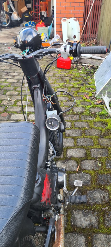

However it has a kxd pit bike engine and I dunno how to wire lights into it
I decided the headlamp and speedo mount looked pants and 3/4 of it was missing so I deleted it.
I made some flash harry mounts for the new light bucket and threw it on.
Next up.. what to do with the speedo.
I fabbed up a prototype mount out of scrap.
It kinda works so I will make a tidier one  this week

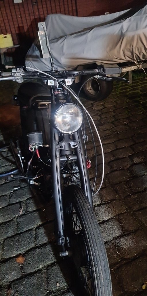

Lowered the headlight.
I think it looks better down there

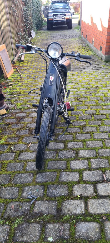

New tail light arrived
I will mount it tomorrow night. Just waiting for my bar end indicators to arrive.

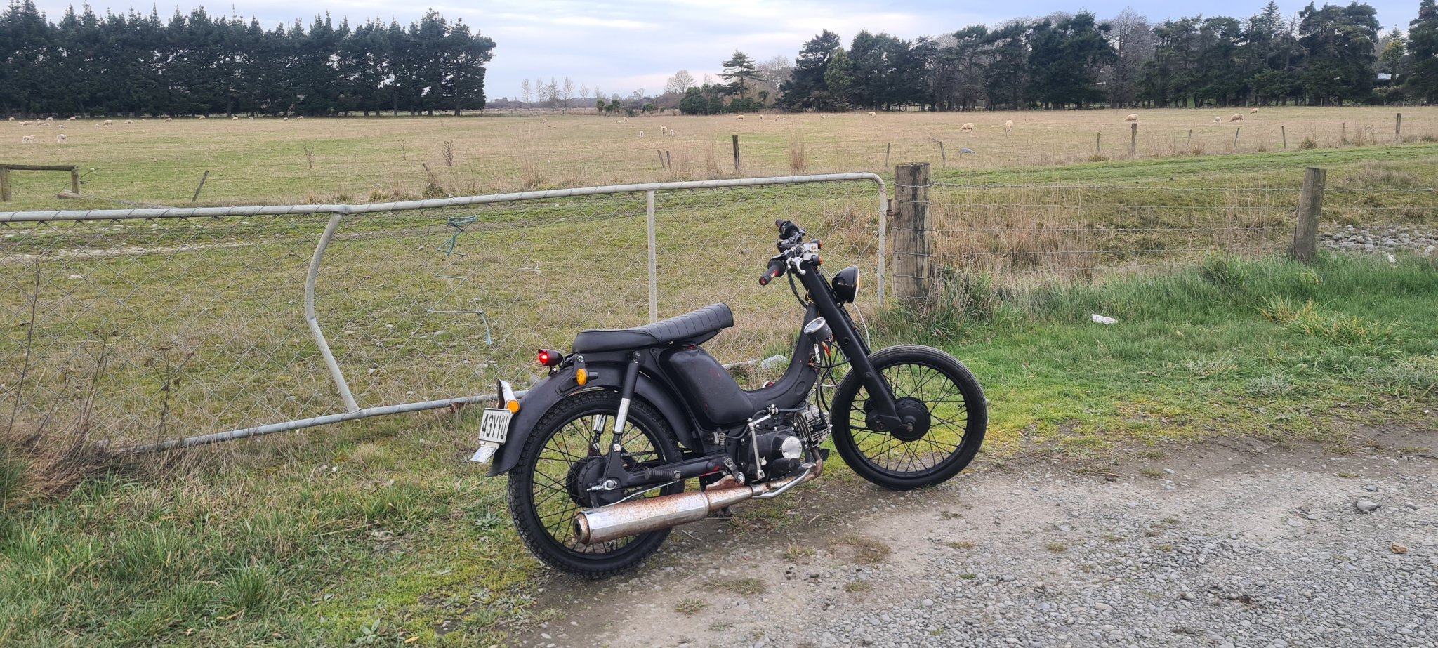

I registered her today. First time since 2008
Getting help from @mo999, (thank you good sir!)with the electron transfers tomorrow morning. Monday I will order golden boys and brake shoes, new front brake cable and lever, perhaps a shorter throttle cable then ride the wheels off her.
  • Thanks 1
So @mo999 is a king!
Black widow has lights and stuff. I am impressed.
Next up is tyres, brake shoes and in the near future front shocks. I guess if Im doing fronts I should do the rears too.
Anyway here she is registred and legal
