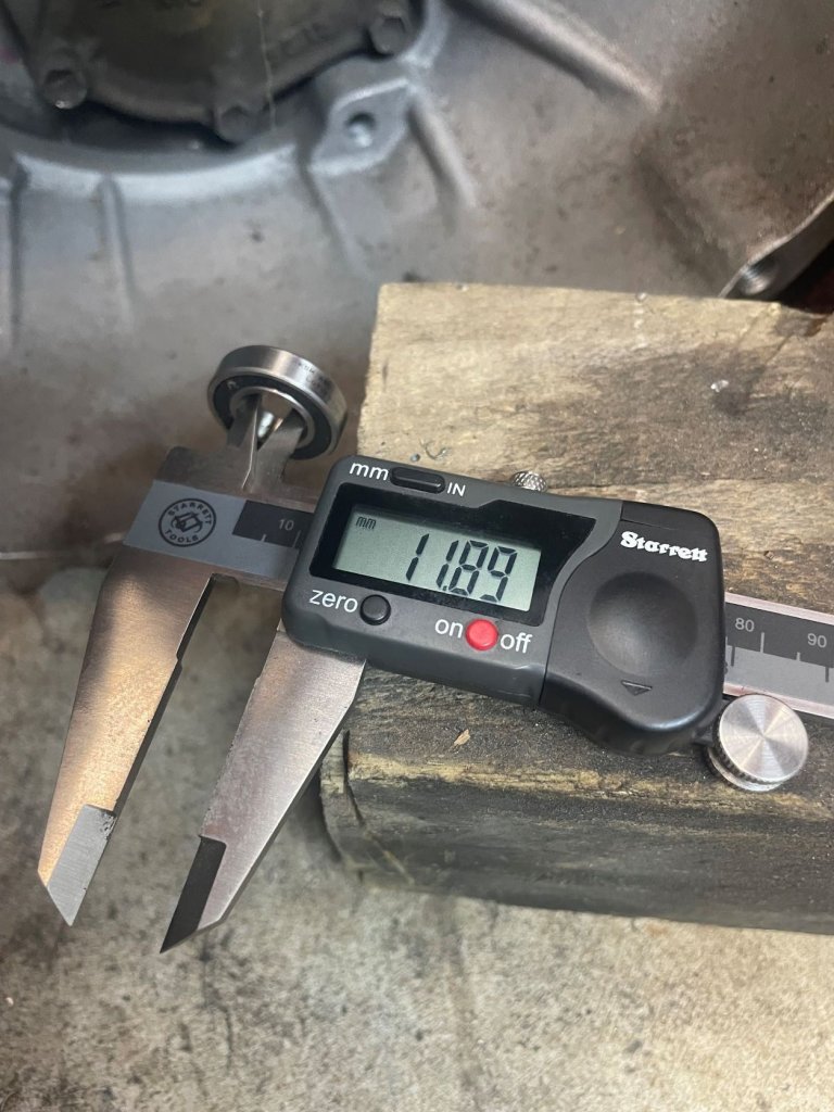

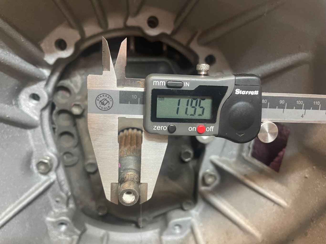

Small miss fit with the input shaft bearing to deal with. These are the bearings supplied with the bell housing for a Toyota R151 gearbox.
Best way to go about it would be a help.
Cheers TT
Makita hand lathe. chuck the driveshaft into the box, slap it in gear and get someone to spin it while you expertly lathe it down with a flap disc.
I have personally used this method before and that particular setup is still ticking along 18 years later.
Or take the bearing into your local bearing shop and try and get one matched up

Just buy the right bearing. Looks like it should be 12mm.  Likely less than 10 bucks even for a decent quality one. What on earth is 10.89mm anyway??
Don’t mod the gearbox as then it’ll be wrong/different for ever more and catch you out next time (guess how I know that!)

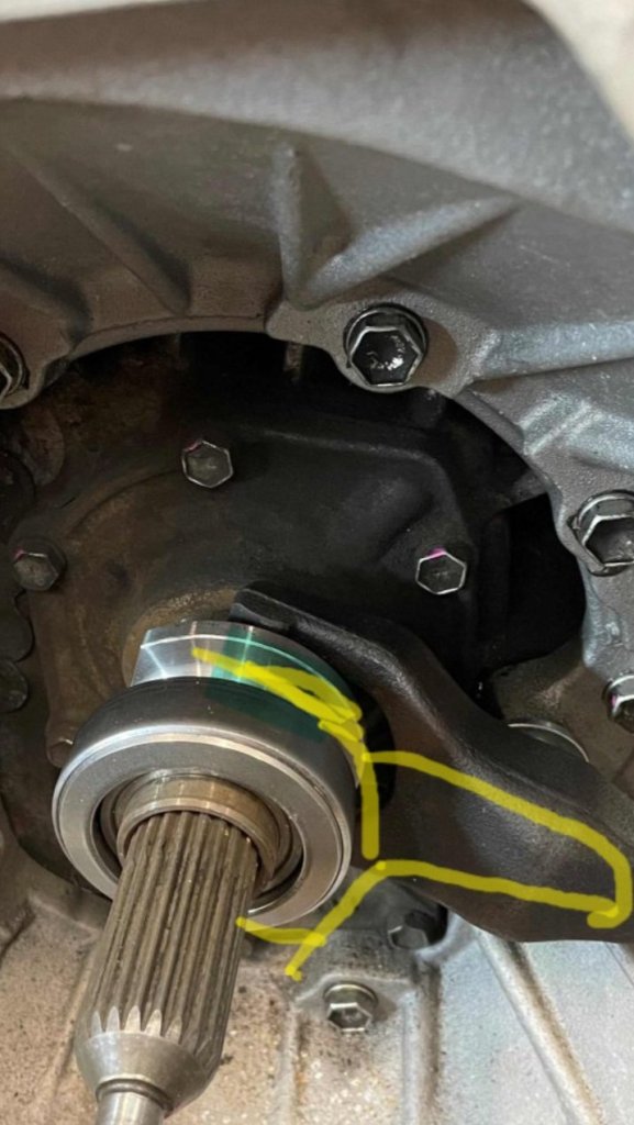

It kind of looks like the release fork should be in the groove forward of the bearing, as per crude scribble attached? Not right at the back?
Also on my Honda I shimmed the pivot ball outwards, although I had the opposite problem with fine tuning of the clutch engagement window.. this may or may not be an option?

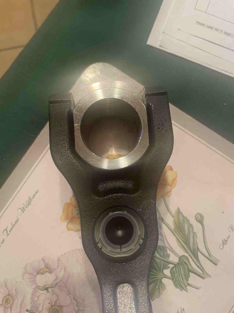

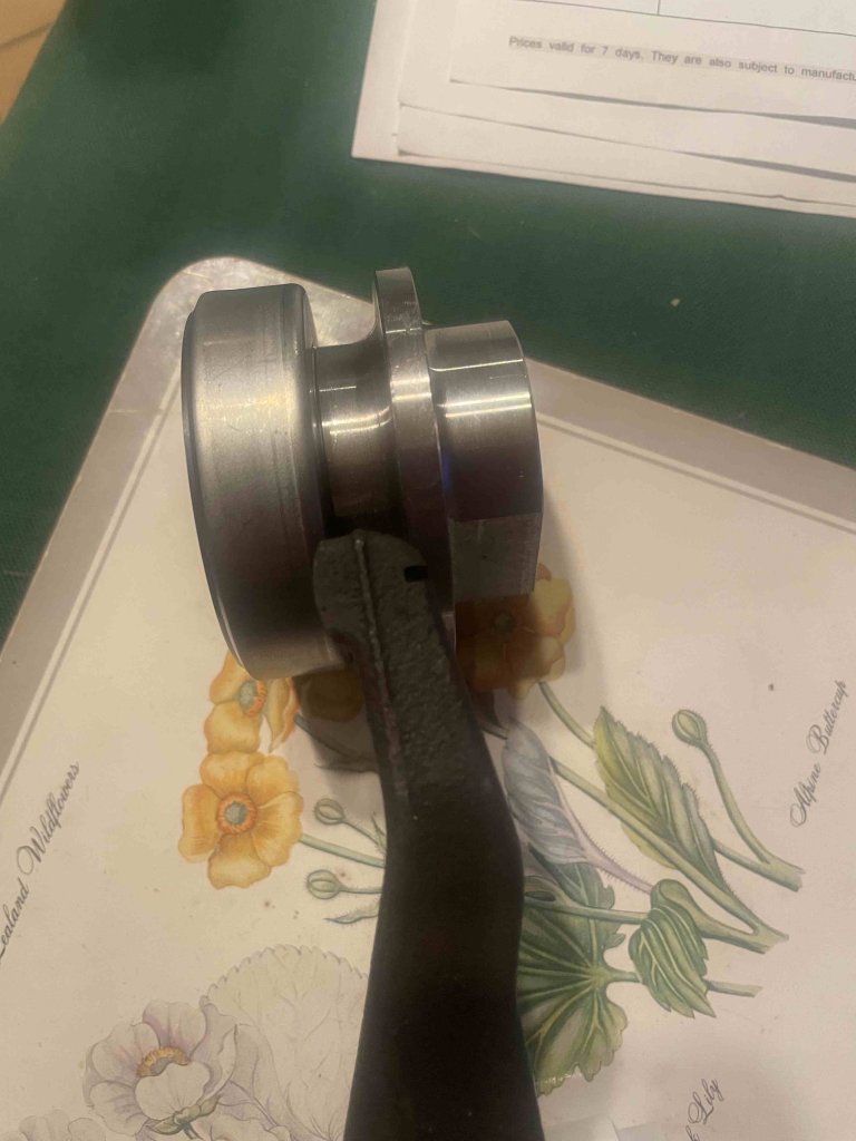

Thanks for your replies.  It doesn't look right does it but these are the supplied parts. It can't fit in that space and if it did it would be putting the load directly on the back of the bearing. I have sent them photo's but according to the instructions these parts should work.
I bought all the parts over a year ago from Niteparts so I sent them an email end of the day yesterday, and received a reply first thing this morning :thumbleft:.
It seems all is well and I need to trim the cyl rod to length. The piston should be pushed into the bore about 2/3 of it's length and then trim the rod to length. That was the info i needed to get it the correct length.
