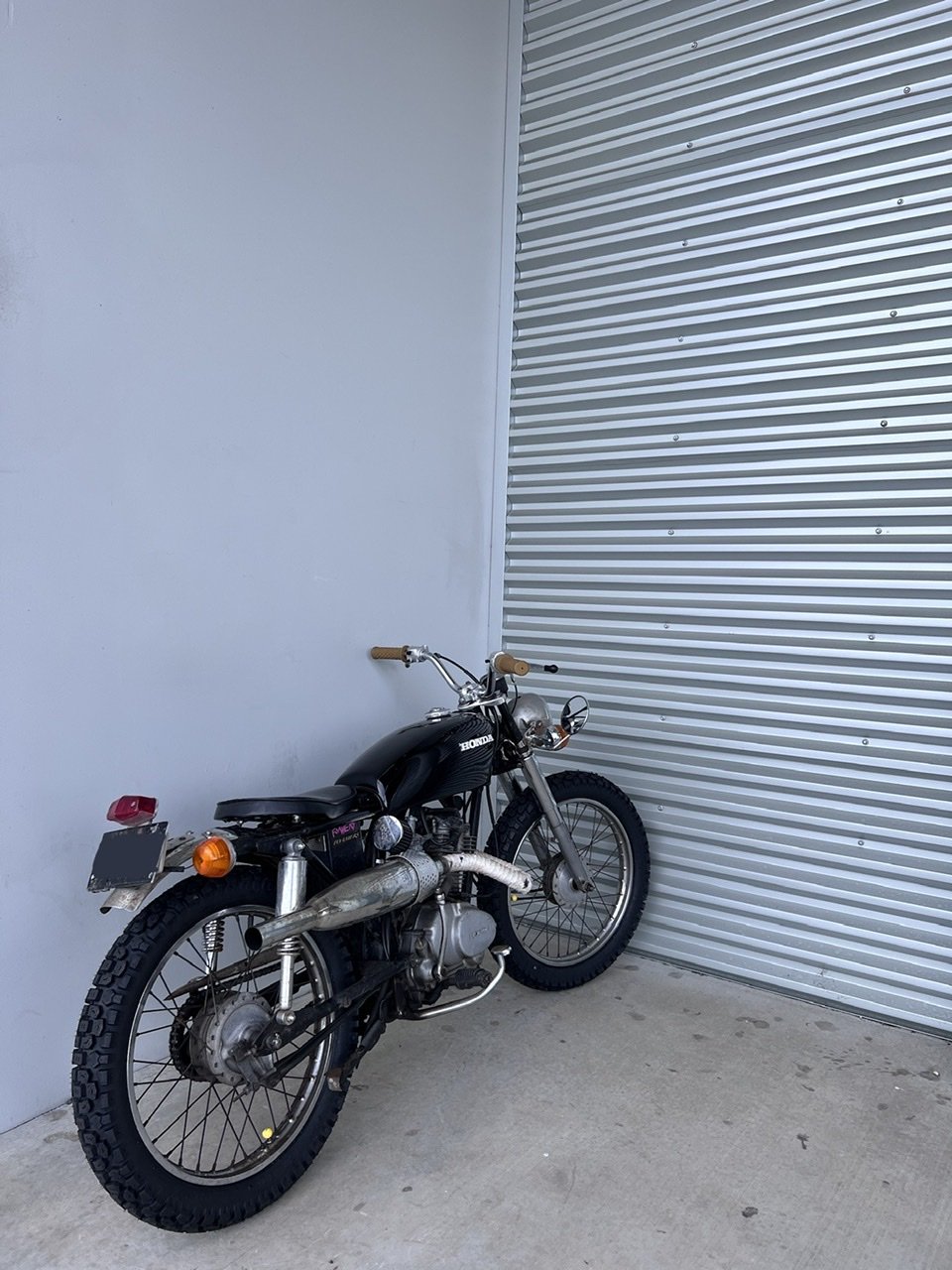

Popular Post Shakotom Posted October 27, 2021 Author Popular Post Posted October 27, 2021 Update: Cb360 ended up dropping a cylinder on test ride around the block just before Christmas resulting in missing out on getting it back on the road for summer 2021. carbs got sent off for ultrasonic cleaning, and I’ve started slowly souring parts to fix the issues and might actually tear it down to the frame and give it a proper tidy up (leave tank etc patina) instead of half as get a wof and ride it. However, messaging a mate on Monday about something else resulted in a ‘I’ve got a Cg125 I’m thinking about selling sitting here’ message. Shot over for a socially distanced viewing and ended up riding this home. Plan is just ride this and enjoy it while 360 is on the back burner. It’s a 1976 Honda CG125, classic rego, black plate, came with Original rego papers and owners manual. It was an original bike that was cafe racered by a local artist and has a few quirky features, Narrow bars, Pea strainer exhaust heat shield, Spoon handles to hold up the chain guard. Its rad, just jammed a new chain on it, changed the oil and fixed an exhaust leak. now to just ride it as much as possible. *wtb -CB100 gas tank….. 13 Quote
Popular Post Shakotom Posted October 30, 2021 Author Popular Post Posted October 30, 2021 Went for a hoon this morning. Narrow bars, Radially grooved tyres and gravel make for a interesting time. 17 1 Quote
Shakotom Posted May 19, 2022 Author Posted May 19, 2022 I have been using the CG as a commuter, the narrow bars are great for lanesplitting however not the most ergonomic. I visited a mate for a beers and bike yarns after work and got sent home with a old pair of chrome riser bars which I promptly modified to allow internal cable routing to reuse the original handlebar controls. which took way longer than it should have. 1 Quote
Shakotom Posted May 19, 2022 Author Posted May 19, 2022 I fitted the handlebars to the bike and at the same time the pair of Shinko SR244 in 18x3.00 sizing tyres I had ordered turned up. The handlebars have given a much more comfortable riding position (grips were just cheapies to check a colour idea) and the SR244s are starting to lean it towards the aesthetic Im aiming for. 5 Quote
