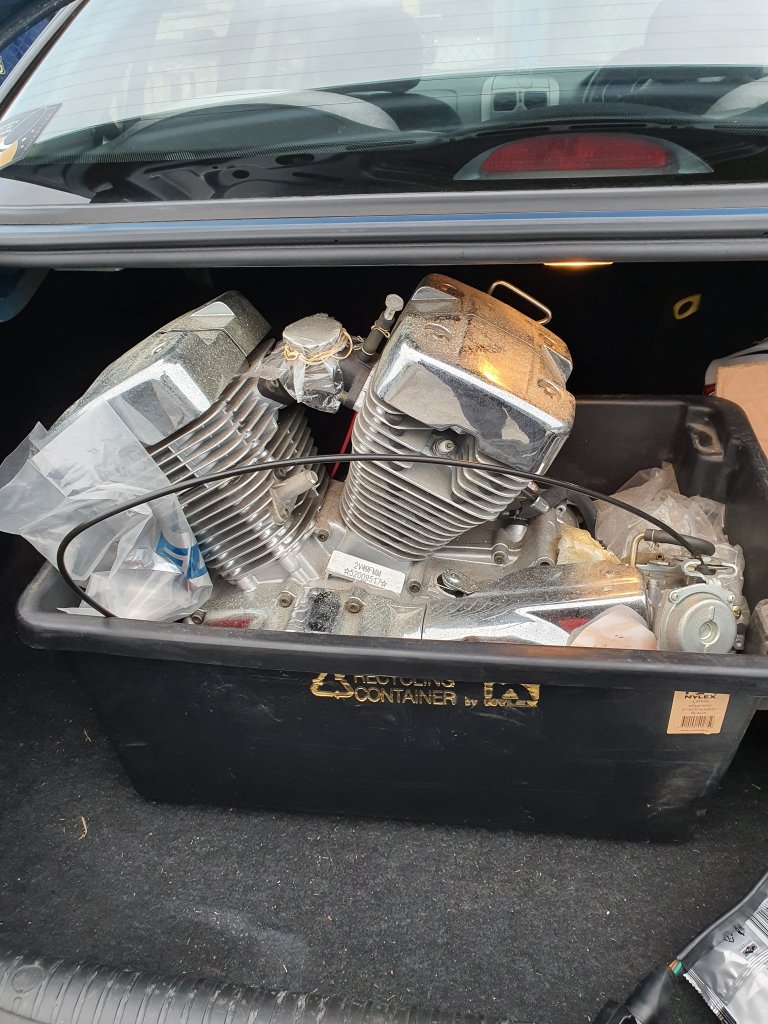

Well this just got placed in my boot its brand spanking new all the parts are still in boxes for my favourite price of nothing.
I have no idea what I'll do with it yet suggestions welcome.

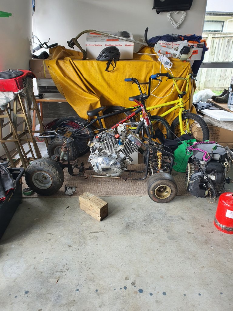

Needed some motorvation to get this going though haven't had a great deal of luck finding a wiring loom diagram that matches up to the colours on this loom, off by miles!
Brain fart occurs today just hotwire the CDI and jumper lead direct to the starter. 2-3 attempts and it runs well no exhaust or airbox so the carb isn't 100% on point but it runs on 2 and revs quite well.
First run ever for this engine.
Whoop motivation! Time to order more parts now i have an engine that will move something.
Thinking about making the top of frame open around engine as the vtwin once all polished up will be a real feature.
Plan in my head is to brace the front an rear of frame to engine mounts so the engine becomes a semi stressed part of the structure, will replace the bottom tubes with something meaty like 25mm box section as that'll help with getting everything flat for mounting.
Decided to shove engine forward too for minimum wheelies max wheel spin. Got eye out for a set of extra wide go kart rear wheels.
Have found a blank 520 sprocket too which sorts the rear axle, big chain im used to 420 pitch which i chew through with monotonous regularity on my other projects.

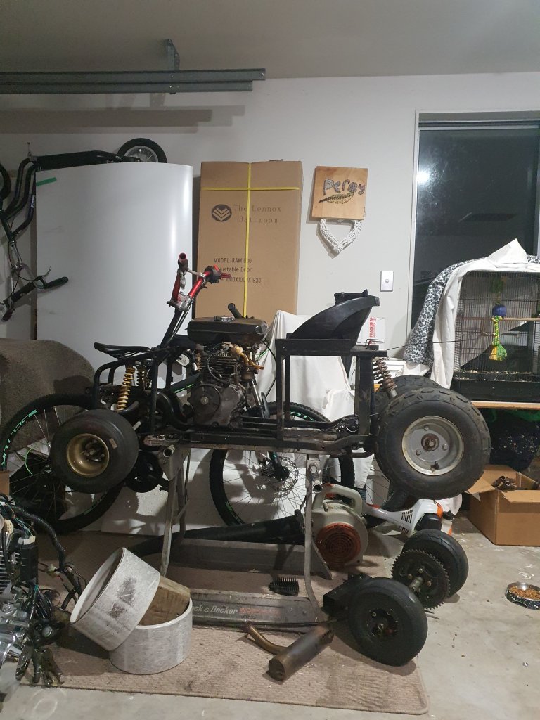

Something has happened. Ive combined this with my sons now retired motorized mobility scooter as he just got to tall for it but it had a very stout chassis.
Quad front is welded on seat will be dropped down heaps and moved back,
axle placement will settle where it functions best and gives enough leg room.
Robin engine will go on to work out kinks but vtwin is been sat in as i go so it fits for when im happy its all going to work.

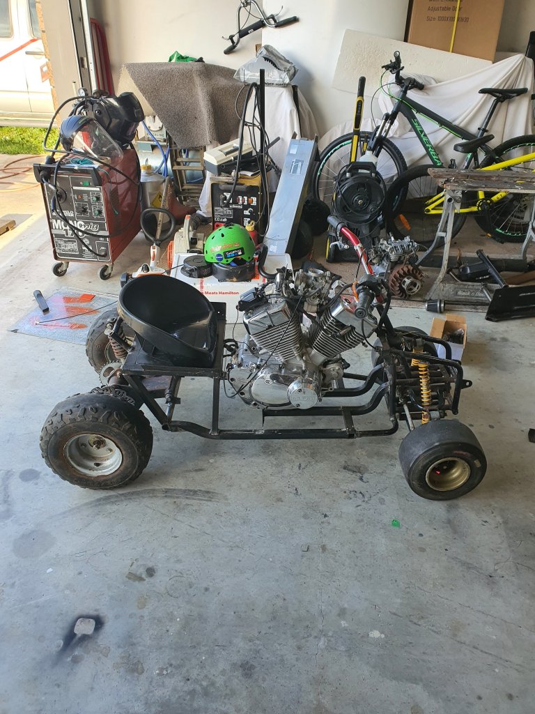

Its on its wheels again suspension all working bit of a squat going on.
Fully welded up too its ridged as fuck with the mobility scooter chassis as a base.
Was considering bars going back to seat from front suspension but doesn't seem to need it at this stage theres no flex.
Plenty of room around engine for legs too stretch out.

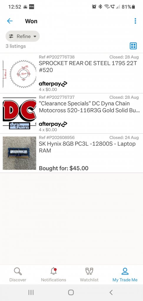

Found a random 22 tooth sprocket in 520 pitch that will bolt straight on from Moto1 been looking for ages and bugger me the chain was on special too! Couldnt believe my luck.

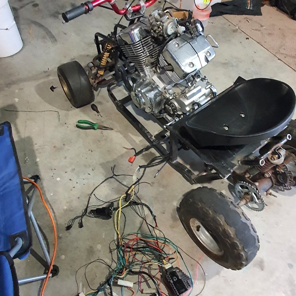

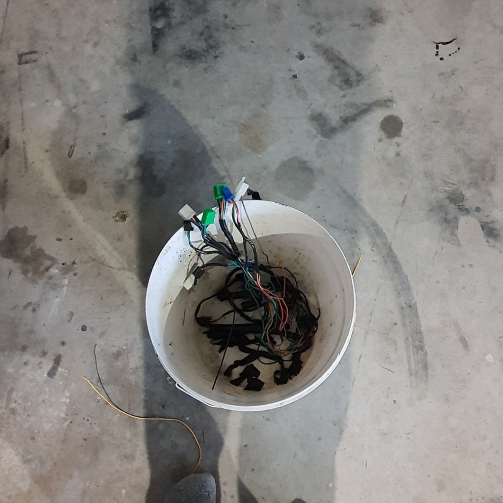

Might unravel wiring loom today and pull out all the lights and gauge wiring it wont need.
Surge of enthusiasm this arvo thinned out the wiring to engine only. Recon i can take more out theres no stand interlocks or anything so can unpin that stuff as well.
Figured out how to mount engine solidly now ive got chain and sprocket sorted i can align engine and zap it in.
