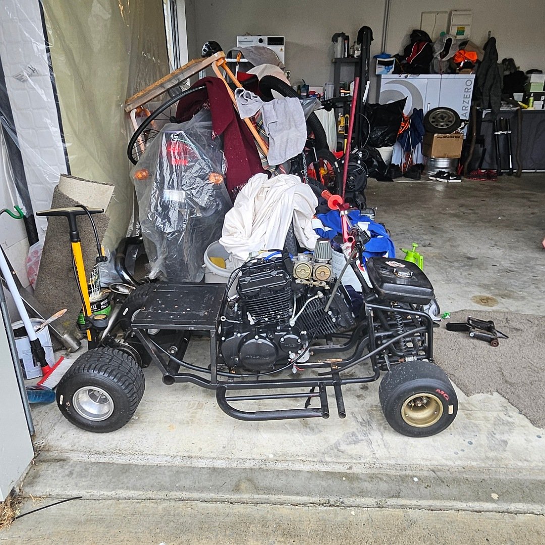

zach_munce Posted January 24, 2025 Posted January 24, 2025 Pulled the Lifan to bits blown head gaskets. My plan is put it in a coffee table since it's all chrome. Have started mocking up the jack shaft gonna 420 from the motor then 520 of the jack shaft to the axle, shifted motor as far forward as it'll go to try put some weight on the front Quote
Muncie Posted January 26, 2025 Author Posted January 26, 2025 Thanks to @MaxPower for donating from his stash this thing has received another bike engine, I was going to put the engine in my Moped but It fit this so bloody well it was meant to be so many things fit from the old engine. @zach_munce cleaned the frame up today it's been through so many changes it had old mounts everywhere for things that are long since gone. All of those are gone now and degreased ready to make now one's. Even the VROD Pipes aren't miles off from fitting. Its one of my favourite projects I've made its now too small for me or Zach however it was made for the weight of an adult so whatever its just small. 2 Quote
