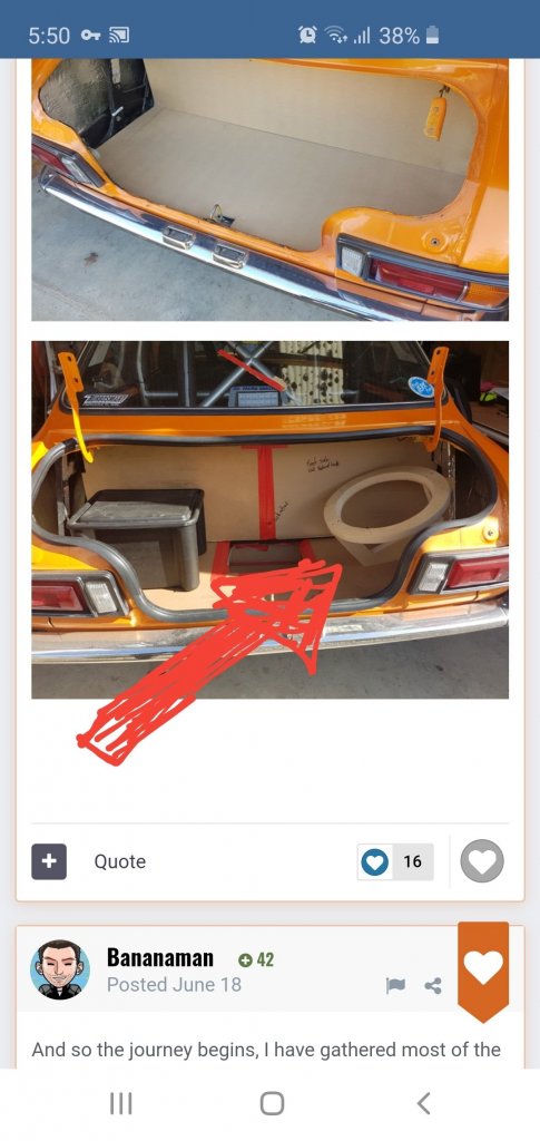

Kimjon 5,327 Posted July 3, 2020 Report Share Posted July 3, 2020 Even a toilet in the boot, you've thought of everything! 1 Quote Link to post Share on other sites
Bananaman 170 Posted July 30, 2020 Author Report Share Posted July 30, 2020 Never thought of it that way @Kimjon could re purpose that once I have finished the power upgrade for when I scare myself and crap my pants. @ProZac credit where credit is due. Finished the first bit of the boot loom recently and rate what you did for HPA very highly thanks. Would love to pick your brain over a couple of other areas in the wiring side of things if your up for it. 1 Quote Link to post Share on other sites
