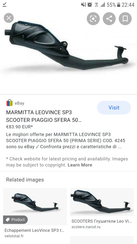

On 05/07/2020 at 19:05, rumrum said:
ah poo, i have a leo Vince sp exhaust to suit minarelli jog style for sale soon
What’s the details on this....
(snake)
