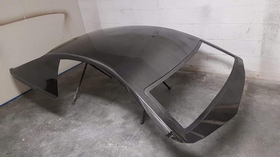

Popular Post Roman Posted April 9, 2020 Author Popular Post Posted April 9, 2020 This guy! Bloody hell I cant believe someone can trim the edge of carbon that nicely. Then align it too. Amazing. 12 Quote
Evan Posted April 9, 2020 Posted April 9, 2020 I imagine that was made with prepreg? Which would make alignment possible 1 Quote
NickJ Posted April 10, 2020 Posted April 10, 2020 Have you used spray tac Roman? helps immensely with getting cloth to stay where you want it. 2 Quote

flyingbrick Posted April 11, 2020 Posted April 11, 2020 On 10/04/2020 at 10:23, Roman said: This guy! Bloody hell I cant believe someone can trim the edge of carbon that nicely. Then align it too. Amazing. the trick is to not use scissors. They lay down masking tape over the inside face of the cut first and use a pizza cutter style tool to get perfect cuts. 2 Quote
