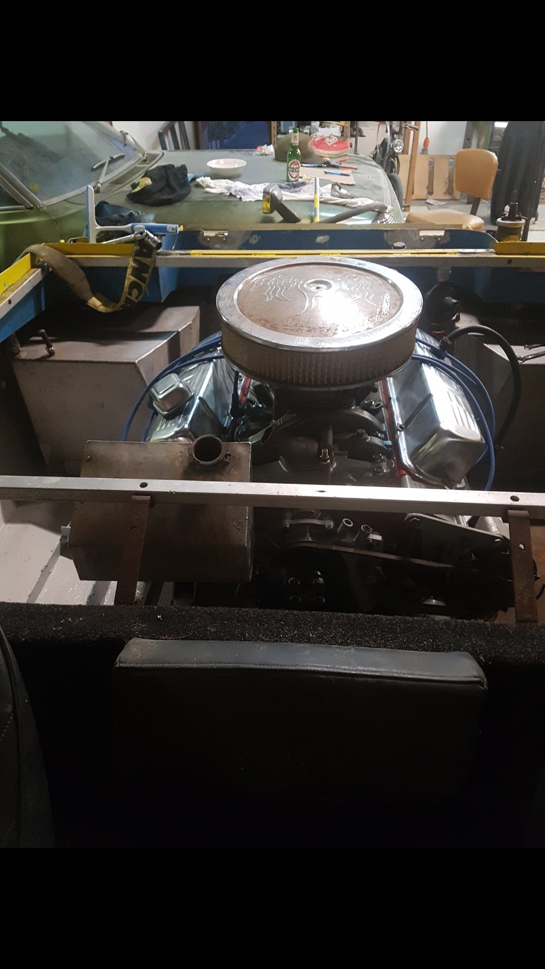

Popular Post 73crownwagon Posted December 15, 2018 Author Popular Post Posted December 15, 2018 Had to call for back up today. @sentra smashed out the header tank which was a proper cunt of a job! And @retep130 made a mess of my wiring and complained of his Wu Tang hangover. Was a solid day 17 Quote

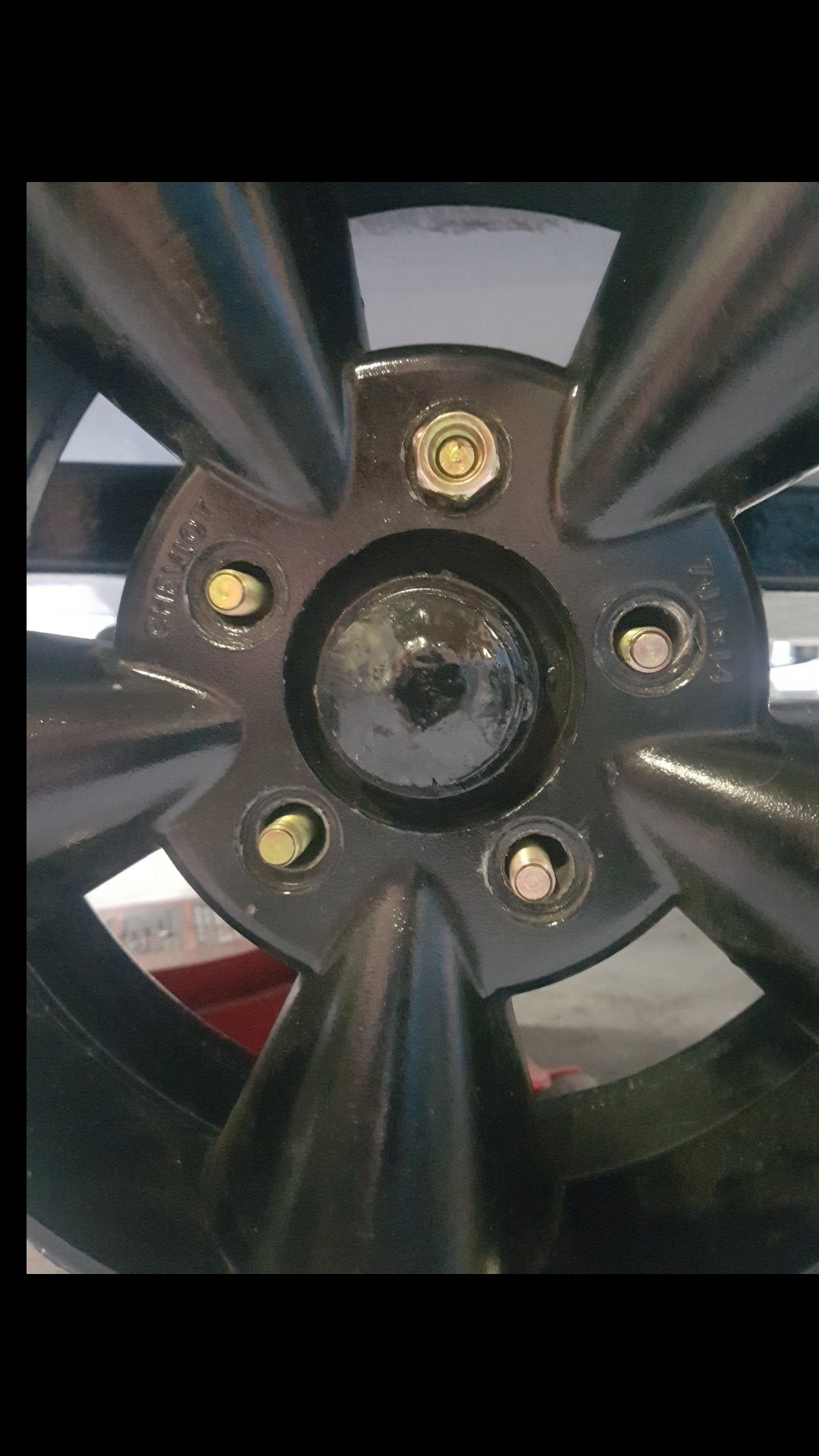

73crownwagon Posted December 17, 2018 Author Posted December 17, 2018 So had a slight set back today. New studs and nuts showed up for the cheviot hustlers and that's when I realised the stud pattern isnt correct for the hub... I'm guessing the rim must be 5x110? Hub 5x114 falcon. 1 Quote
73crownwagon Posted December 17, 2018 Author Posted December 17, 2018 Did get the wiring working today tho which was good took a couple hours messing around since someone had it wired up funny. Other then that I got this stainless grate that I'd like to sink into the engine hood to get some air flow. Should I put it on the front or on the top? 3 Quote

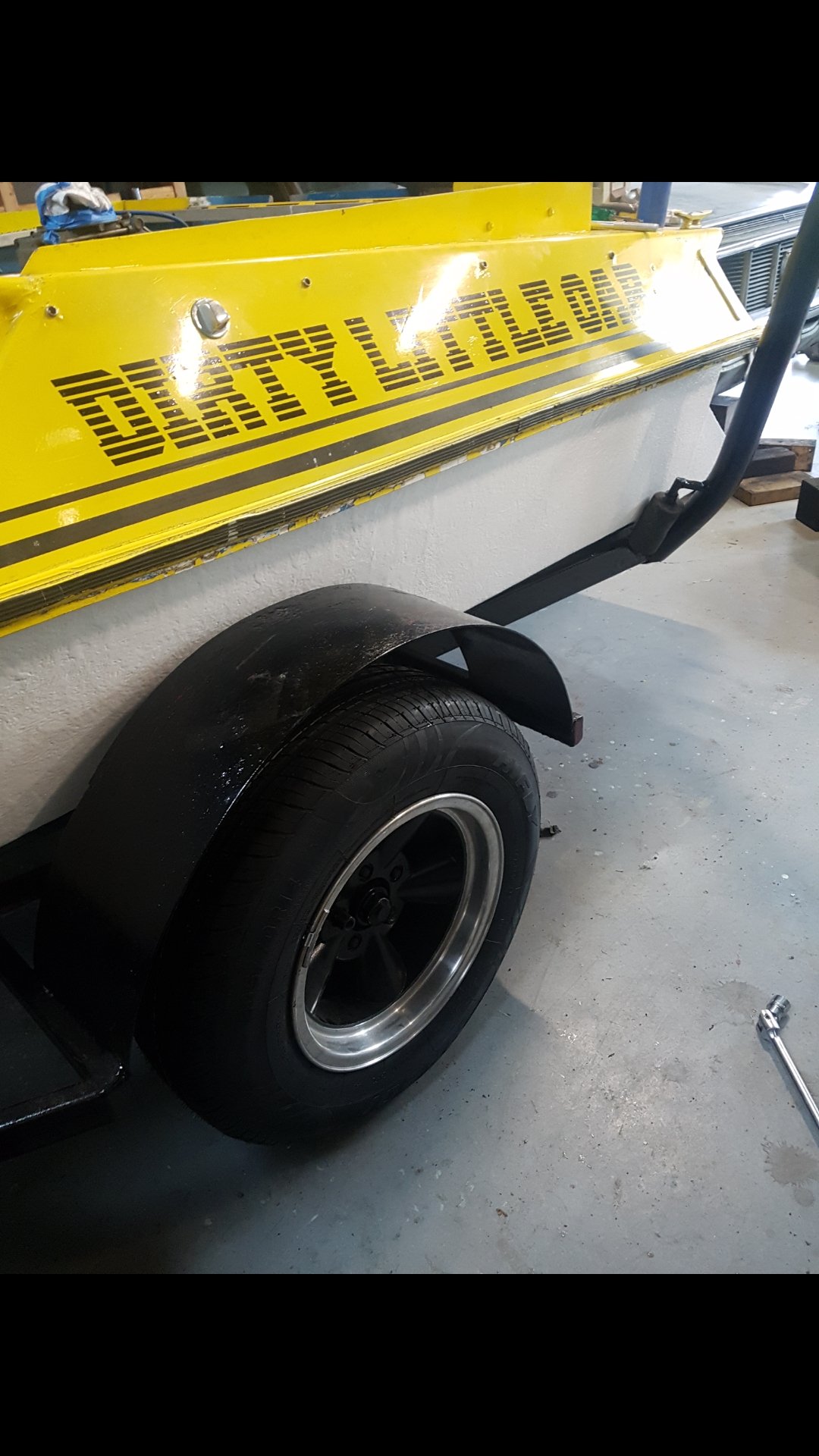

Popular Post 73crownwagon Posted December 17, 2018 Author Popular Post Posted December 17, 2018 Situation with wheels sorted. Ran them in the milling machine this morning to slot them out 1.5 mm then whipped up some press fit centering rings. 18 Quote

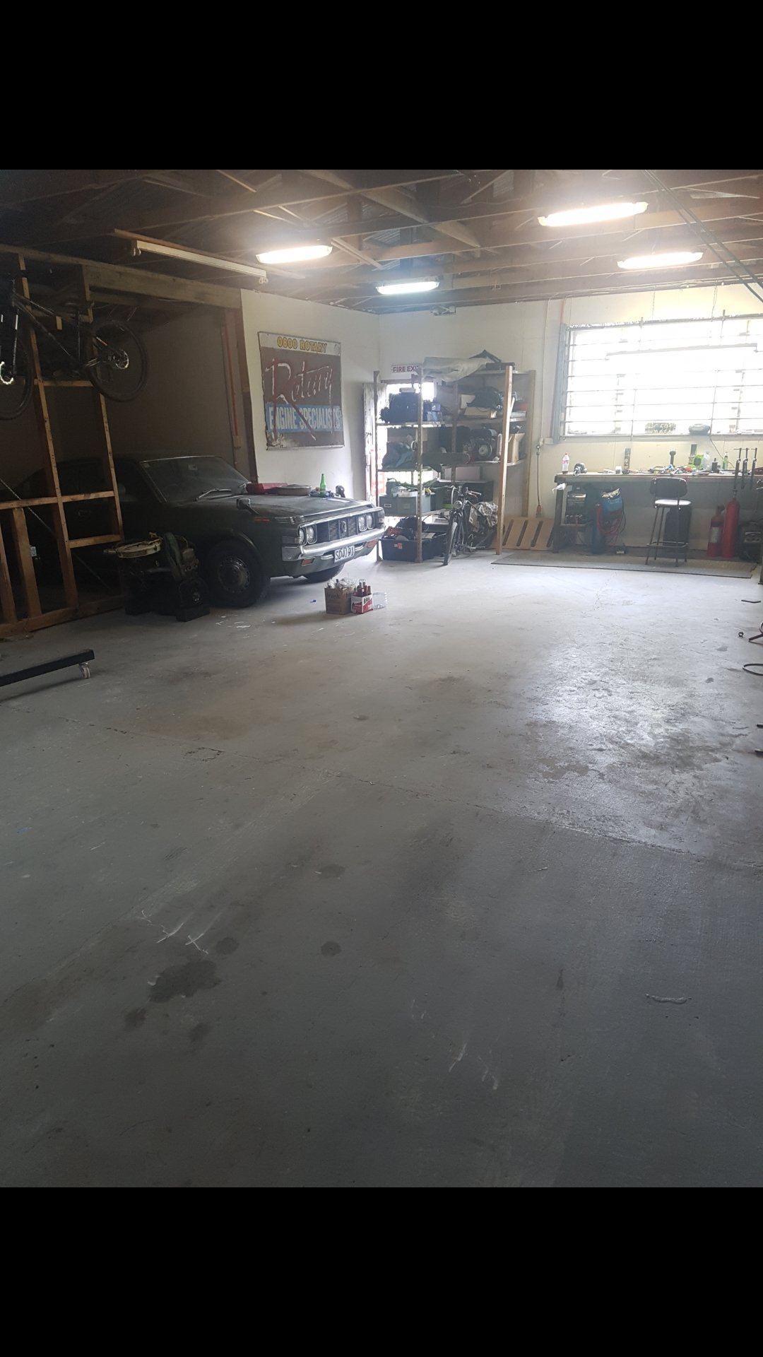

73crownwagon Posted December 19, 2018 Author Posted December 19, 2018 Shoddily tig welded on the work machine a quick stainless t junction for a tell tail line out the back of boat. Having a night off boat tonight going to use the time to clean the garage this past week I've made a pretty solid mess in there need to put all my tools back on their places to carry on next few days 1 Quote
73crownwagon Posted December 19, 2018 Author Posted December 19, 2018 Was solid good decision to have night off and clean garage. Can crack back into final calibration tomorrow night 6 Quote
