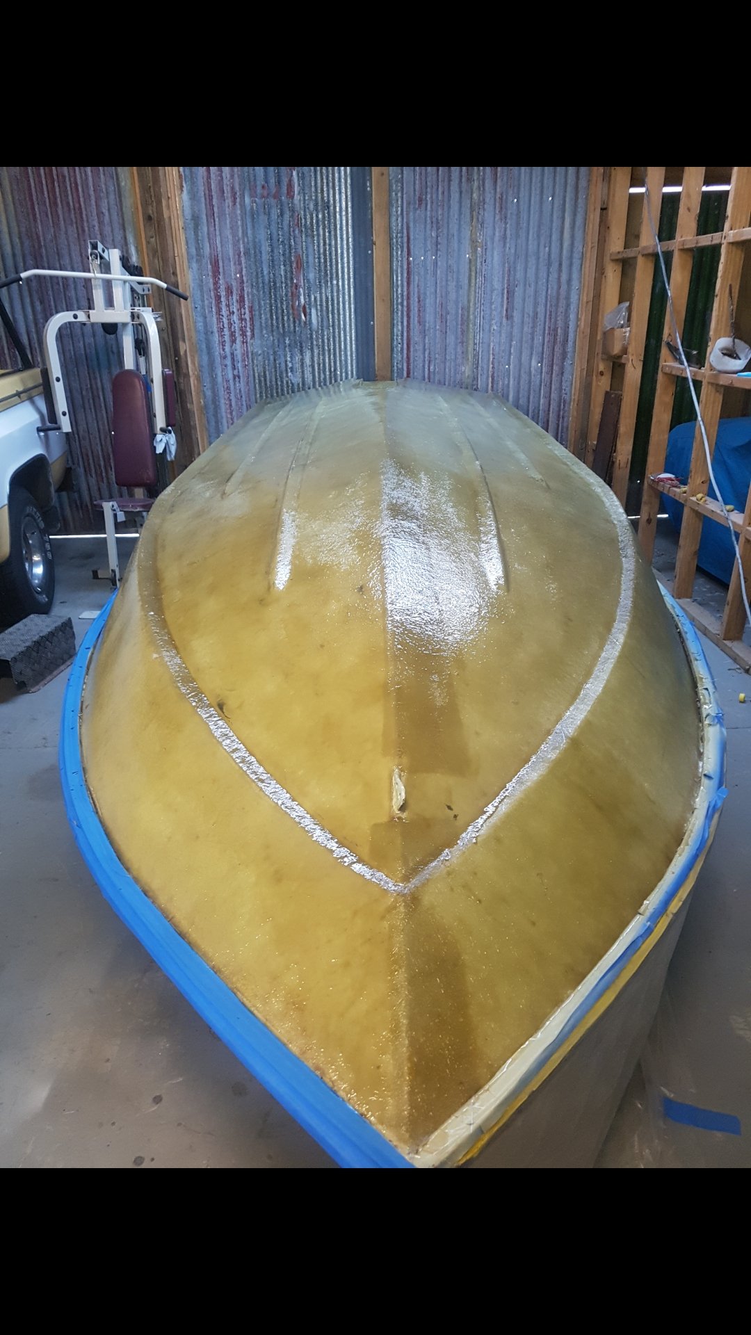

73crownwagon Posted November 20, 2018 Author Posted November 20, 2018 note to self, fibre glassing is a cunt of a job. 6 Quote
Popular Post 73crownwagon Posted November 20, 2018 Author Popular Post Posted November 20, 2018 Morning check. Am happy with what I accomplished last night. Few more afternoons like that and she'll be good as gold. 13 Quote

73crownwagon Posted December 1, 2018 Author Posted December 1, 2018 So got one side done this morning but unfortunately ran shy on resin for the other side this was 1.15pm today. Called the fibre glass place in mt Wellington to see if open yes they were till 3pm. It's now 430pm and I'm back at home with more resin and about to crack back into it. I live about 1 hour 15 from fiberglass shop. I also bought some white marine paint whilst I was there. 8 Quote
73crownwagon Posted December 1, 2018 Author Posted December 1, 2018 I'm really glad I'm not a perfectionist 5 Quote
