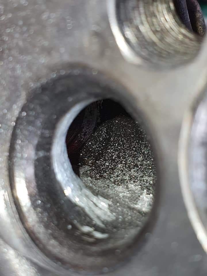

Muncie Posted March 26, 2020 Author Posted March 26, 2020 Heads all stripped down stoked to find inlet is factory CNC ported (fuck yes) exhaust is a bit shit though, I'll tidy that up do a valve grind and put back together. Found the valve seats clearly weren't sealing well obviously has been left sitting for years and got some surface rust. 3 Quote
Muncie Posted March 26, 2020 Author Posted March 26, 2020 Boom it runs! Took all the sharp edges out of inlet as well but overall these heads were mint! Lapping in valves took some work but did eventually come up really good. Started first pop normally takes some cranking. The part thats been attacked with the angry end was a hard edge that extended out really choking the exhaust. Once i had that opened up and smoothed out the rest of the port was actually pretty good, i opened up the port at the flange to match the exhaust and called it done. 4 Quote

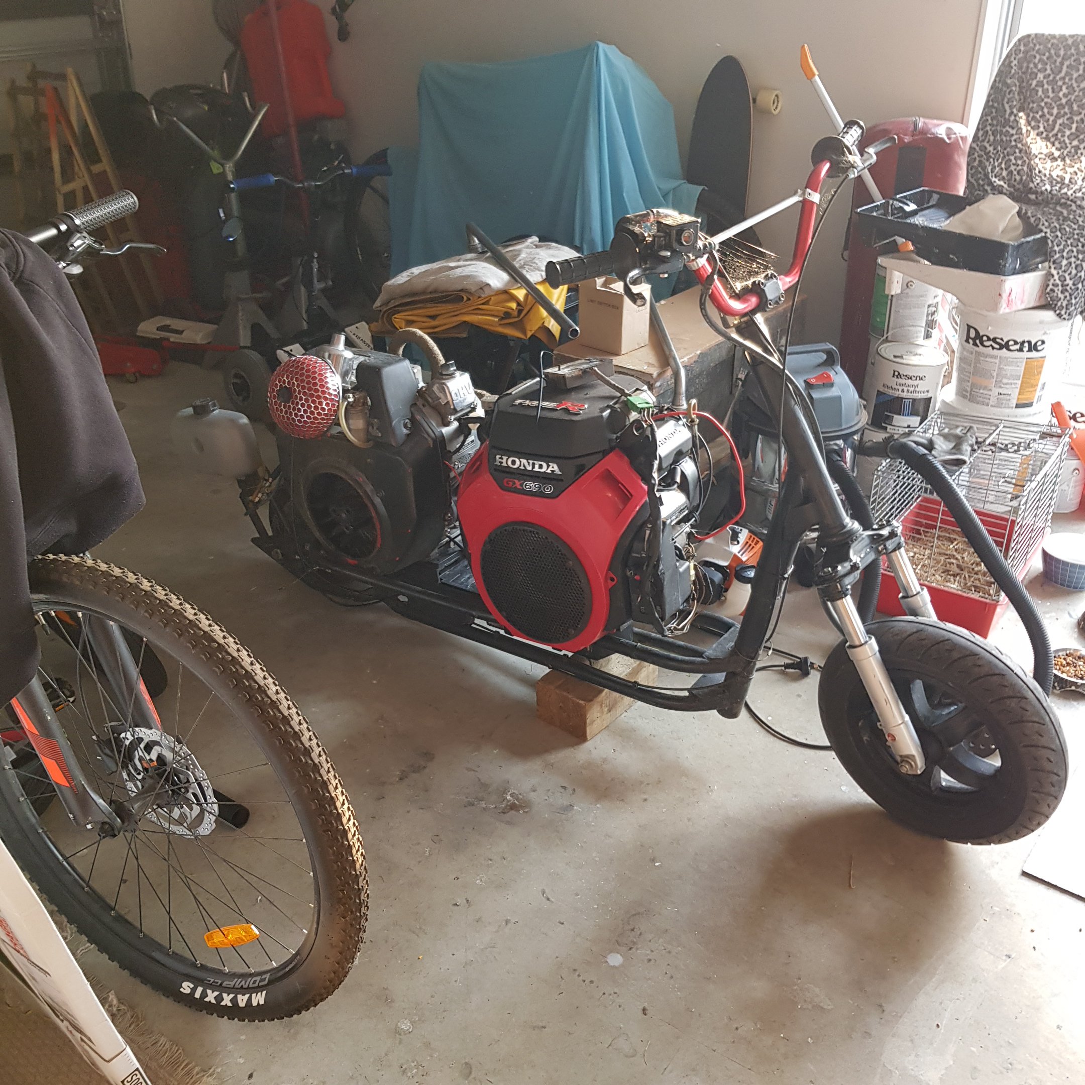

Muncie Posted April 2, 2020 Author Posted April 2, 2020 Did pointless shit this morning..... got up at 5am so i don't end up sleep fucked when i start my new job on 14th. Hopefully can use this as lunch bar transport. Headlights for no real reason other than i had soldering iron plugged in and got carried away. Oh and fixed the dodgy deck that sat jacked up for ages after i welded bracket in wrong place a year ago. If i bung indicators and a tail light on and sneeze a bit im sure i can get this registered. 1 1 Quote
Muncie Posted April 7, 2020 Author Posted April 7, 2020 Discovered as much fun as standing up is when the front wheel comes up you want to sit your ass down real fast, Only problem is you had a choice of the SU carby or the exhaust to sit on so i started scratching my head and remembered i still have factory airbox. Typical honda its so over engineered you can drop a bomb on it........ or a 90kg human. TLDR ? I threw the guts out few nips with grinder and it now fits and doesn't interfere with the carbs return springs, surprisingly makes a good seat. Will add some foam and a vinyl cover job done 3 Quote
