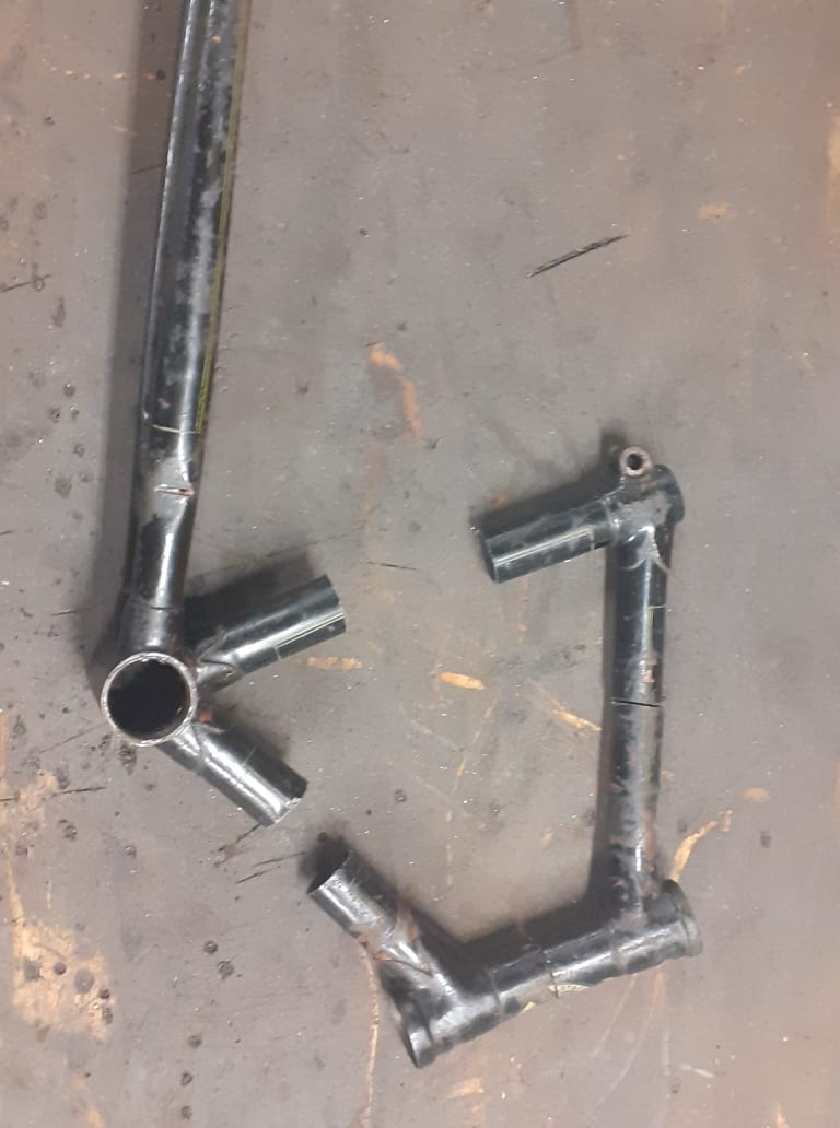

Popular Post Valiant Posted February 28, 2021 Popular Post Posted February 28, 2021 Time to make this into more than a wall hanger. Condensed. Further condensed. I found some secrets from the past. One of the lugs has been cracked in a couple of places. It pre dates the crash as both cracks have braze in them. I've ground the cracks out but I cant decide whether to tig weld them now or to leave them as is and fill them with braze when the tubes get brazed in. Anyway I have this .8mm wall chromoly tube from another project I decided not to continue with. So with a rebuilt frame, wheels, and all the old components cleaned up it should work out nicely, 18 Quote
