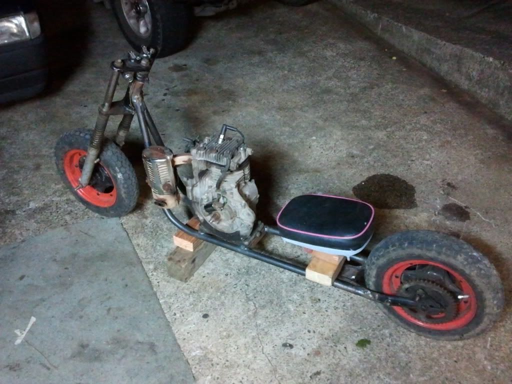

mark105 Posted May 22, 2012 Author Posted May 22, 2012 grabbed the chaly Jase mentioned ^ there and put this together tonight. Quote
japawagons Posted May 22, 2012 Posted May 22, 2012 your engine is round wrong way g Nah it's not, if you spun the engine around and ran direct drive the wheel will spin backwards, so he's running a jack shaft... Quote
sentra Posted May 23, 2012 Posted May 23, 2012 im missing something cool here cause sprockets/jackshaft wont change the rotation direction are you using a geardrive to power the jackshaft? Quote
Steelies Posted May 23, 2012 Posted May 23, 2012 depends if kirks 'wrong way' was referring to rotational direction or driveshaft end in relation to rear wheel sprocket Quote
Ned Posted May 23, 2012 Posted May 23, 2012 if it's the sprocket being on the wrong side, surely you can rotate the wheel? it is round/symmetrical after all? Quote
Yowzer Posted May 23, 2012 Posted May 23, 2012 Quite sure it is the wrong way around, as that is the flywheel side showing. Intake / exhaust should be on the back of the engine. Unless it spins the opposite direction to my Honda, which I doubt. Quote
KKtrips Posted May 23, 2012 Posted May 23, 2012 not if its a freehub Freehubs lock up when spun clockwise - if thats a freehub then it will be one going fast backwards bike.. TL:DR.. engine AND wheel are round the wrong way.. edit - I just noticed its a motorbike wheel and hence there will be no freehub - they are both still around the wrong way though.. Quote
Beaver Posted May 23, 2012 Posted May 23, 2012 fuck you guys are useless. its obviously FWD and rear wheel steer. pilot sits on their knees and steers with feet. engine is rear mounted for better centre of mass. 10-5 for president. Quote
KKtrips Posted May 23, 2012 Posted May 23, 2012 The thought of that causes both my throat to tighten and my anus to quiver like a dog who just ate the roast chicken off the bench.. Quote
sentra Posted May 23, 2012 Posted May 23, 2012 pretty sure tenfive knows this and is sniggering at us. Quote
Yowzer Posted May 23, 2012 Posted May 23, 2012 pretty sure tenfive knows this and is sniggering at us. Hehe, nah... Engine mount now requires chopping and rewelding Quote
KIRK Posted May 23, 2012 Posted May 23, 2012 depends if kirks 'wrong way' was referring to rotational direction or driveshaft end in relation to rear wheel sprocket engine runs clockwise so pto needs to be on other side is what i ment sproket on wheel can be on either side depending on how you conect it to the engine edit: when i say clockwise i mean from the pull start/flywheel side. Honda says 'counterclockwise from the pto side'. Altho maybe you could buy these old things in backwards running form. used to be able to buy a few engines like that. Quote
japawagons Posted May 23, 2012 Posted May 23, 2012 Yeah so Ten Fizz must've had a long day at work and I'm pretty sure my brain is just underdeveloped. The engine is very clearly just mounted backwards... Pretty sure he's planning on flipping the engine and rear wheel and still running a jack shaft regardless.. Quote
