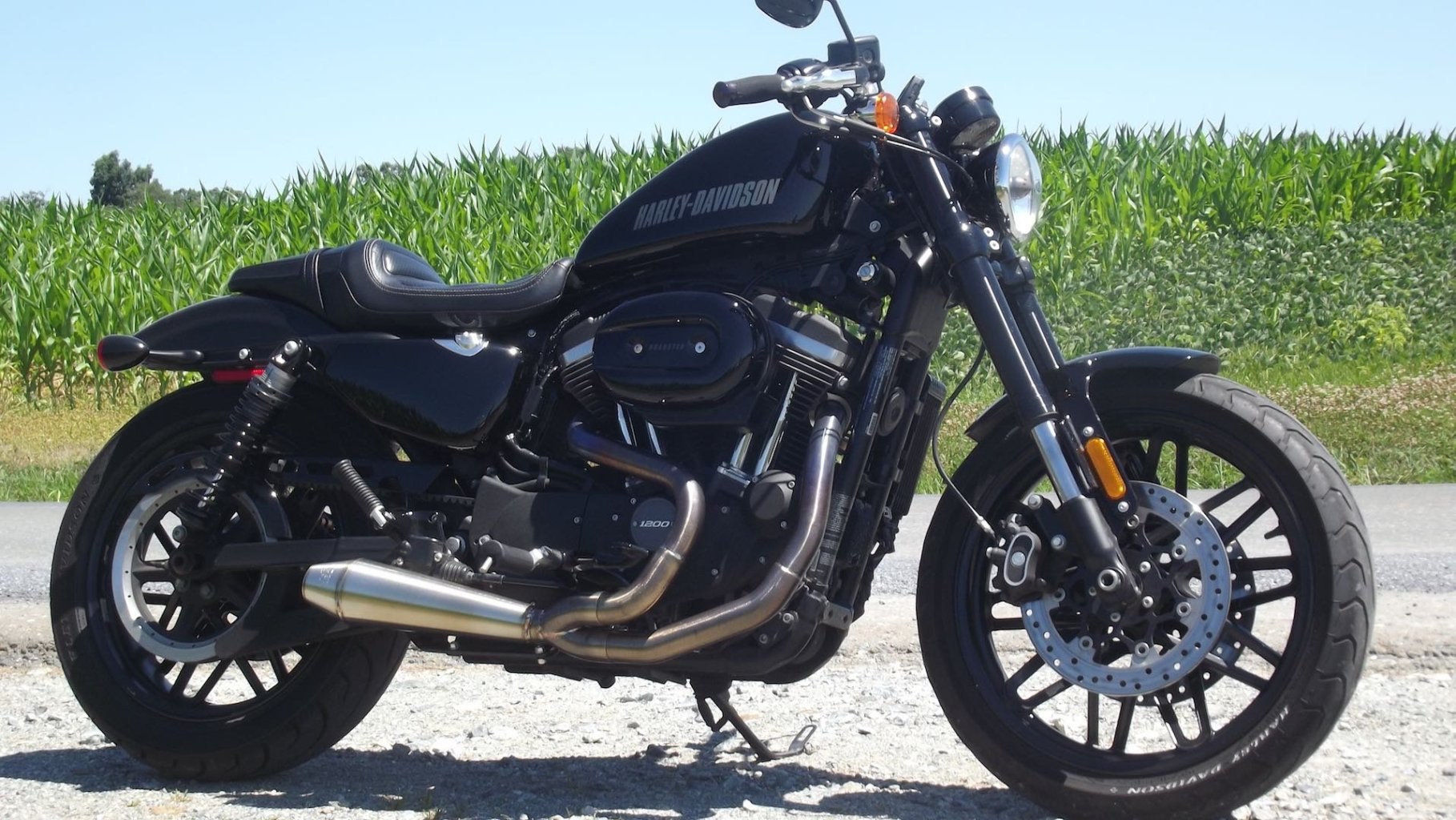

Popular Post thegreatestben Posted August 5, 2024 Popular Post Posted August 5, 2024 It’s not old but it looks old right? I saw this baby while I was in Greece having dinner and thought it was one of those deals which is almost too good to be true. Facebook marketplace, located in Fielding. Mutual friend: @CaMpylobacter. Hmmmmm that could go either way tbh…. As it turns out the dude was a punishing boomer but also a decent guy which CaM backed up. In fact the WOF’s happened to be issued by Adsett Heavy Diesel and the bike was described as minty mint and the price was <$10K with not even 10,000Km on the clock. Arrived back in the country and headed up to the ‘ding. Bike was as described and a background check came back all good too (bike is ex Aus, thought maybe dodge but nah just came over with the previous owner. Rode it home and almost went deaf. Has been fitted with some short shots and you just couldn’t escape the sound. It’s also got some extra goodies in the form of a Bluetooth FP4 fuel tuner, k&n drop in filter and a upgraded h-d gauge cluster. Boy howdy it goes like a champion when you give it the beans but it’s pretty agricultural at regular speeds through out the 5 speed box. Main use is to commute so I really would like it to ride a little more civilised and my 2008 sporty was a lot slower but lovely to chog along without much fuss. Getting in touch with V&H who make the fuel tuner and pipes, they recommended fitting some optional baffles to quiet the thing down but would also give it more low end power at the sacrifice of the top end - Ideal as that solves two problems with one stone! So the tweaks begin: 13 Quote
thegreatestben Posted August 5, 2024 Author Posted August 5, 2024 Baffles come in two flavours, quiet and super quiet. I didn’t find too many examples or reviews at first but helpfully I ended up finding an old forum post where someone bought the quiets and ended up going for the super quiets and even those were rowdy. Looking at the pics you could probably add some more holes to the super quiets to make them into the quiet baffles. They’re not cheap but convenient and fit is spot on. The cheeky buggers at Boyd’s sent me a lightly used one which wasn’t ideal but to their credit they have sent me another new replacement. Didnt realise there’s technically already a baffle in them when I went to get the job done. You have to partially remove the heat shields to access the button head screw securing each baffle in place. Existing noise makers: Super Quiet: Pretty easy job once I had both new ones in hand. This is the “lightly used” one I got at first: stripped threads on screw and baffle to boot! Quick change of the flash tune to update it with the baffles which is super easy in the App! Haven’t ridden it yet but already noticeably quieter and the tone is a bit nicer but that might just be due to the fact my eardrums aren’t bleeding. The Mrs reckons it’s way quieter from the kitchen haha Have bought a couple new bits of gear to stay safe as well. Carbon fibre helmet has been a great purchase, at 1.2kg it’s much lighter than any other I’ve previously had. 8 Quote
thegreatestben Posted August 6, 2024 Author Posted August 6, 2024 First ride - SLOW Did make it alot quieter, smoothed out low end considerably but it's dulllllll. It's super slow up top, Might keep these for WOF's and just invest in some better noise cancelling headphones. These are the quiet versions of the baffle, I can modify the existing ones to have more speed holes: 1 1 Quote

thegreatestben Posted August 12, 2024 Author Posted August 12, 2024 4 hours ago, CaMpylobacter said: hells yeah old mate could smoke in the shower with that schnozz. nice bike he had and didn't ride though right? meanz Lol. I think it had only done 500km since 2020 I think I've done double that already. It is a nice bike, especially for the money. I ripped the baffles back out and the solution is definitely to wear noise cancelling earbuds It is so much fun to hoon with the loud pipes. Quote

thegreatestben Posted August 17, 2024 Author Posted August 17, 2024 Baffles I bought are very restrictive but I could easily make them into the less restricted ones by adding some more holes. Or I could delete the part which makes them not straight through. It’s fine with decent headphones but it’s bloody loud for everyone else so wouldn’t be surprised if I got a ticket one day. the bike came with standard pipes, the original mufflers and a set of screaming eagle slip ons. The more I ride the bike the more I like how rowdy it is though… it does go quite well when giving it the beans. 2 Quote
