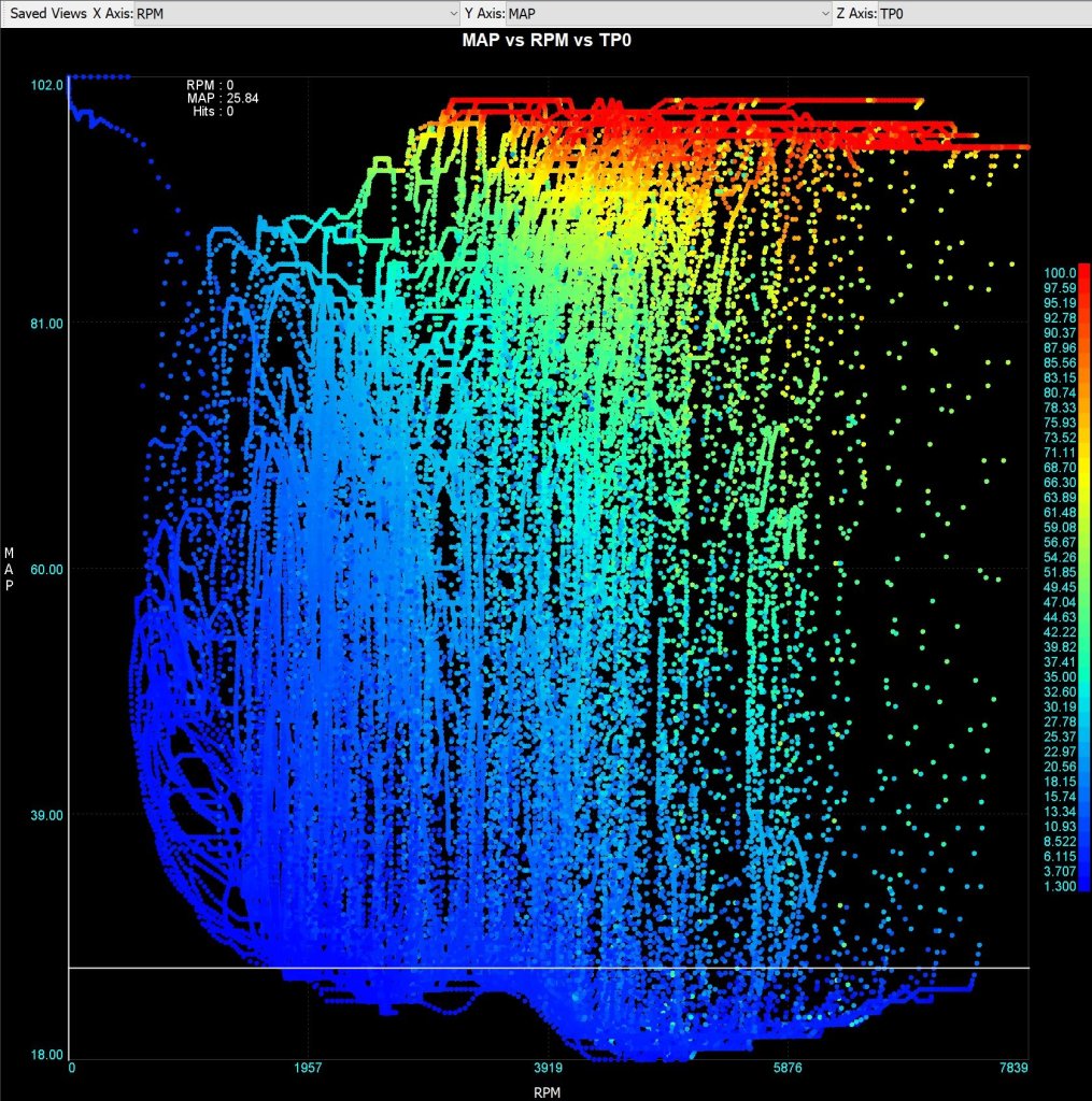

WORROY7 Posted February 7, 2024 Posted February 7, 2024 I have a 3sge in my FRASER 7 with ITB. I have captured some engine data MAP, RPM, TPS SPEED. Before I return to the dynometer I am seeking opinion of the MAP signal and if it collates close to a single throttle body. The Dynamic range over the 6 km run was 18 Kpa to 92 Kpa . I have inserted two images from the trace. ECU is haltech Quote

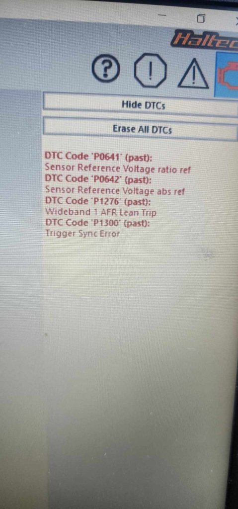

R3spct Posted February 11, 2024 Posted February 11, 2024 They allow for map sensor to be used as a baro sensor, if you use it as map sensor then you need an external baro sensor. BUT the new firmware insists on using the map sensor for something, and looses its shit if you try use it as a baro sensor, and needs map for something even tho my old tune everything is ref to tps. Tried to sort it but car wouldn't run right no matter what i did so rolled it back to old tune. I get check engine lights all the time for things that cant be referenced or searched, lots of abbreviations that dont link back to anything in the software of help files, so i just dont have a bulb in check engine light on dash anymore. Haltech hardware is fine, generally its a ok product, I've just had a really shit run with trying to do something different, (running ITB's with a poor vac signal for map), and the so called "support' is rubbish. Annoys me when Skid Factory, who get tens of thousands of product free, go on about how fantastic the support is. They have cell phone nos for the top techs in Aus., in NZ the agent here doesn't seem to know much, and I've literally waited weeks for a response. The AFR lean trip is impossible to track on logs, despite many attempts to log different things, the ecu only logs things you tell it to log. I know its a lean spot somewhere, but it doesn't trigger a check engine light, so cant log when the fault happens to see where on the map it happens. The other 2 voltage ref and voltage ration items ive got zero idea what they are, as the help file just lists all the codes with nothing about what they are. Quote
WORROY7 Posted February 11, 2024 Author Posted February 11, 2024 Hi R3spct What ECU model from Haltech are you using? I have used E11 and now I am using the elite 2500. Prior to this I used Kalmaker with GM ECM as used in VN Holden. I am not using the internal Map. I have connected by MAP box to an analog input. No trouble codes. This is why I built the MAP box so I can get good vacuum signals. I would agree the support is not as good as it was. I recall calling haltech Australia from the side of the road when running the E11 many years ago. However my most recent ticket remains unanswered. It may be since Haltech was acquired by Race Winning Brands inc the support enthusiasm has diminished and the forum has disappeared. kpr said In most cases with Itb's, just throw away your map sensor and tune in tps vs rpm. I disagree with this, I am running 45 TWM (Borla 2900 series) and I have a good steady with dynamic range MAP signal this provides the other axis for the BASE table. Quote

Roman Posted February 12, 2024 Posted February 12, 2024 Hey @WORROY7 you should consider buying a copy of Megalog viewer HD. This way rather than viewing the results as a time plot, you can show it on an XY graph with different things as the axes which will give a clearer view of things. If you can export your log file as CSV or similar and send it to me I'll post you some graphs if you want. If an NA motor is doing low 90 KPA at full throttle then I'd be very seriously looking at why it's so choked up on the intake side. If it's more than say 3kpa below atmospheric pressure then it needs a better inlet. anyway, here's an XY plot of a beams 3SGE engine using a factory plenum with a MAP sensor connected. Quote
WORROY7 Posted February 12, 2024 Author Posted February 12, 2024 Hi Roman Yes I got a copy of the software last night after by haltech data viewer would not load a large file. I have a scatter xy map and it does not look like the one you show. I do not think there is a restriction it is just the way my software is reading the 4 pressure sensors. Fantastic image it gives me something to work with. Thank you. I would be interested in correspondence. I will post my image once I worked out how to use the Mega log viewer HD. Quote
