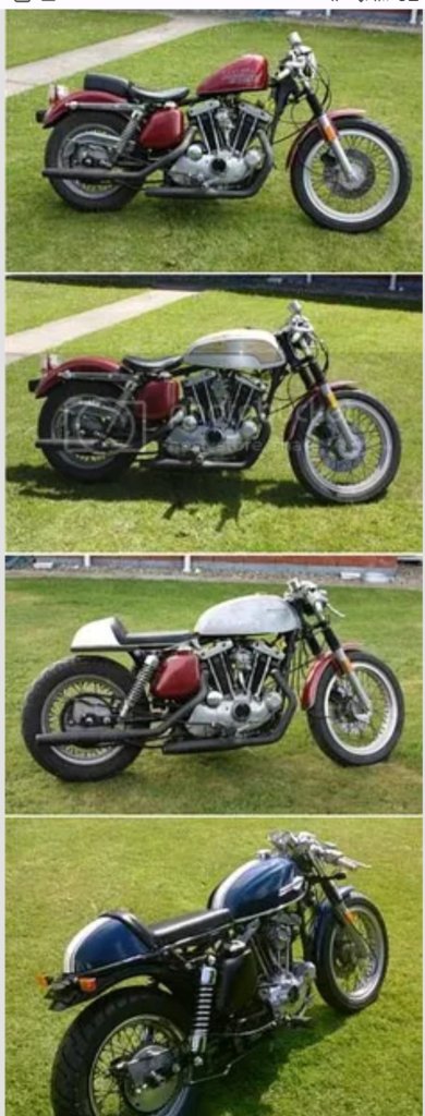

Kimjon Posted January 9, 2023 Posted January 9, 2023 Epic bike, more photos of it beforehand please? Quote
Lord Gruntfuttock Posted January 9, 2023 Author Posted January 9, 2023 Had a whole build thread but photobucket turned into a dick. Started thus... 4 Quote
Popular Post Lord Gruntfuttock Posted January 9, 2023 Author Popular Post Posted January 9, 2023 Then sorta... 17 1 Quote
