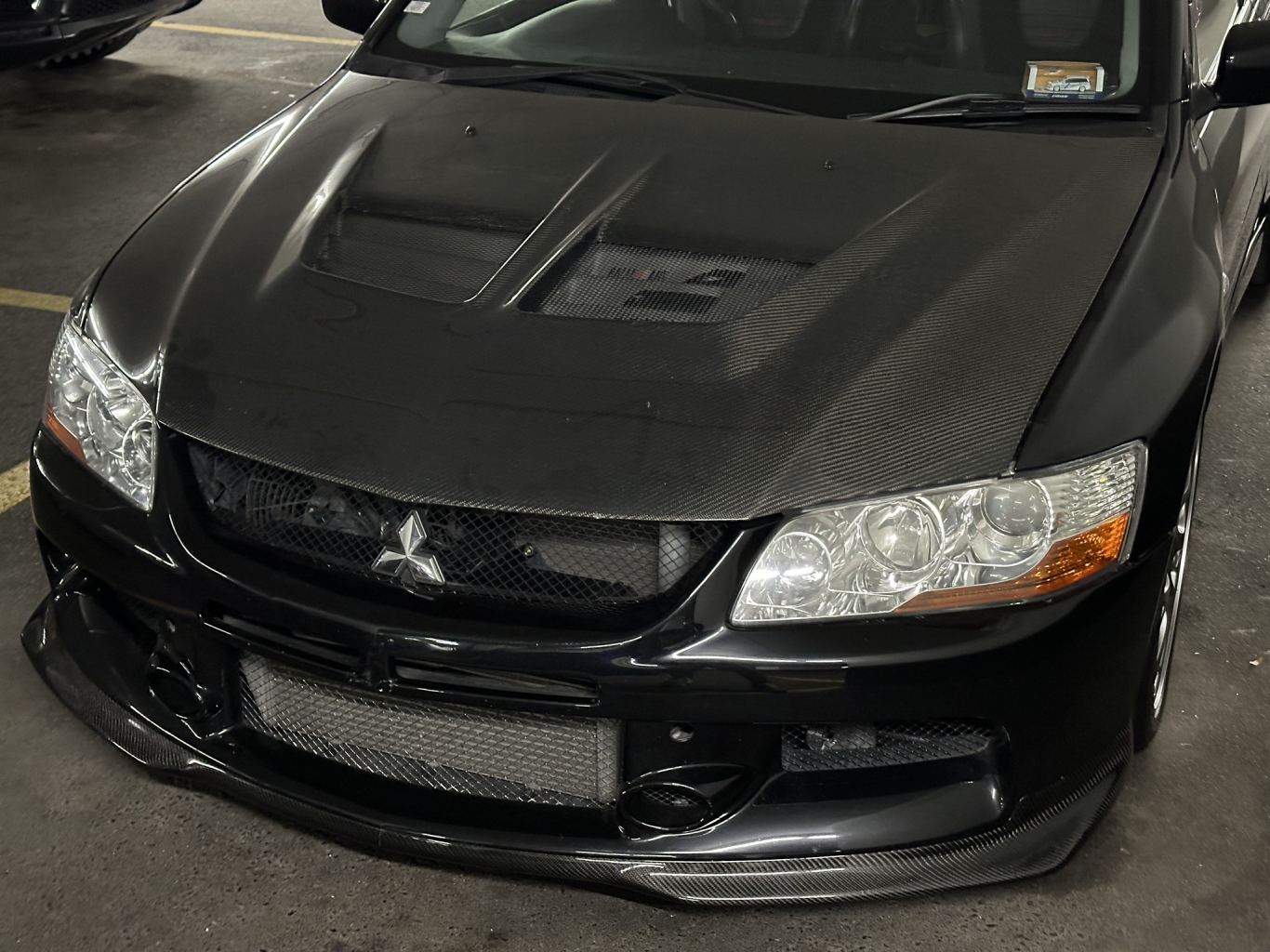

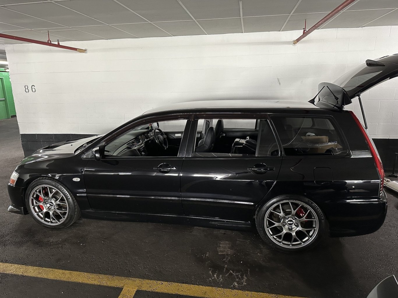

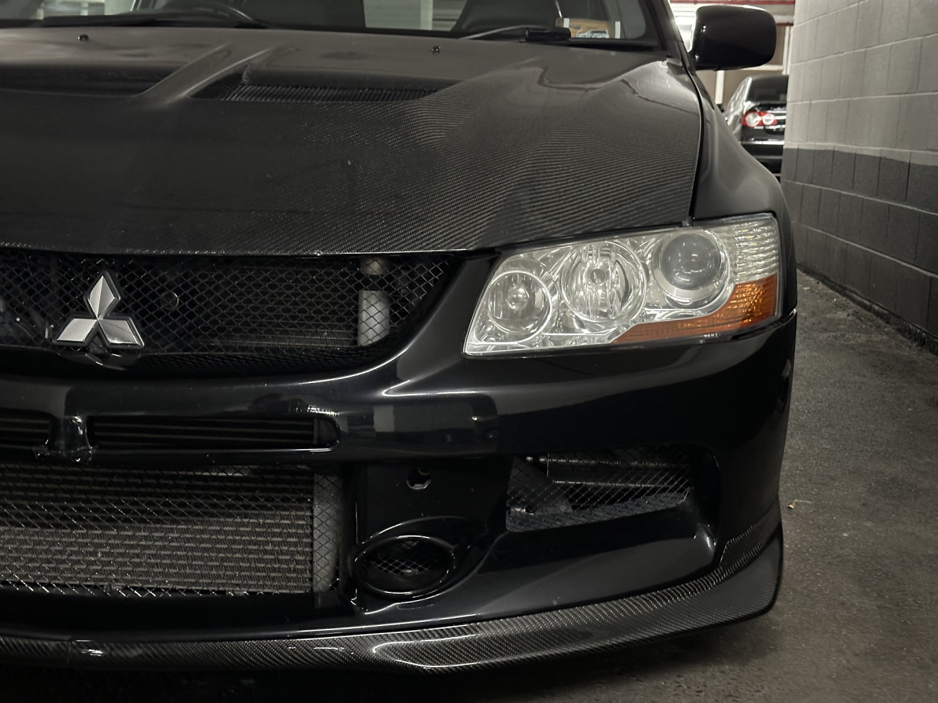

Finally got around to fitting the Ralliart CF front lip. I ended up cutting it in half in order to transport it from NZ to Canada so will tidy up the join properly in time, but for now it's hardly noticeable. I'm going to place a Ralliart sticker over top of the join anyway to hide it further
Probably my ultimate daily driver, nice work man. Crazy that you're mid-field with this, still feels like EVO IX were the fastest thing out there... must be getting old!
  • Thanks 1

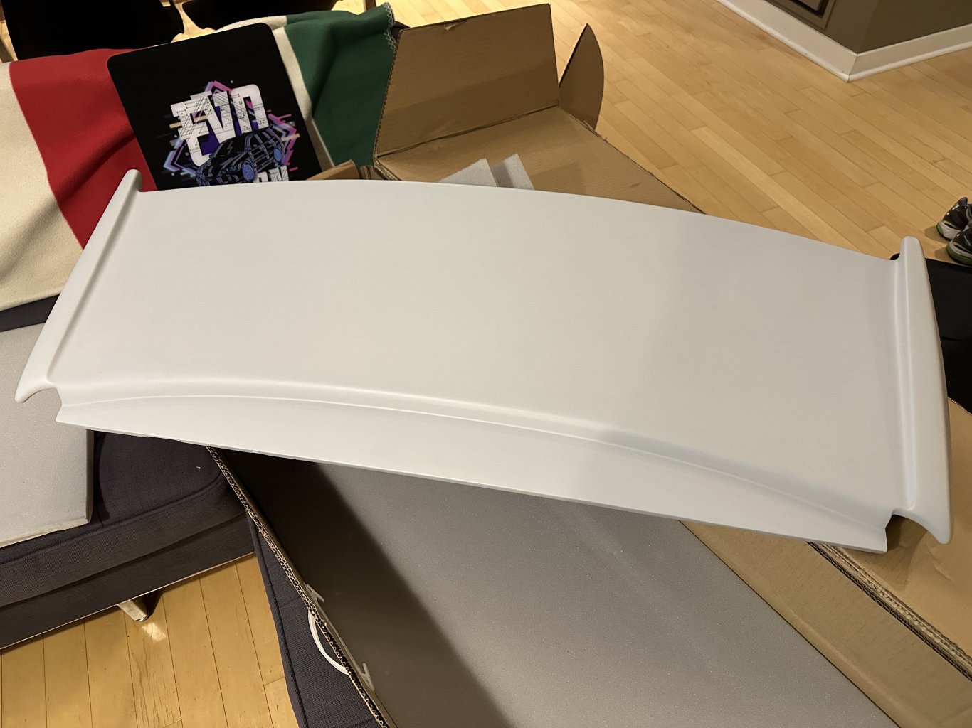

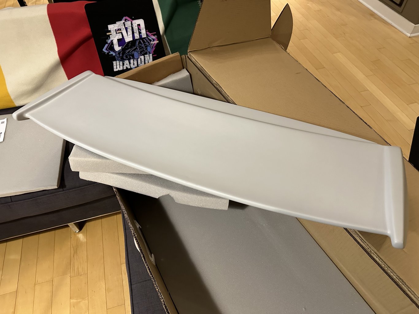

big wang arrived all the way from Sri Lanka. Canada customs definitely had a big nosey at what it is.
So what is this 'Kenstyle' you may ask? It is a Japanese manufacturer of a rear spoiler that was originally destined for the Lancer Cedia in the early '00s, before the Evo Wagon was released:
Out of the other wings available, such as the Ralliart which is big $$$ and hard to find
and the Varis which has now been discontinued and even more harder to find
The Kenstyle is by far my favourite - though it does have a caveat (as does the Ralliart) in that it requires fitting a regular Lancer wagon spoiler because they attach to the regular model spoiler rather than the larger Evo wagon spoiler. I did end up finding a genuine Kenstyle in NZ but it did not include the base model Lancer spoiler (which I have since found thanks to @Bluebird_U). I still was faced with the more serious and expensive problem of getting a rather large wang from NZ to Canada. Unlike the Ralliart CF front lip I was able to get away with cutting right in the middle at its smallest and least noticeable point, I can not do the same to the spoilers.

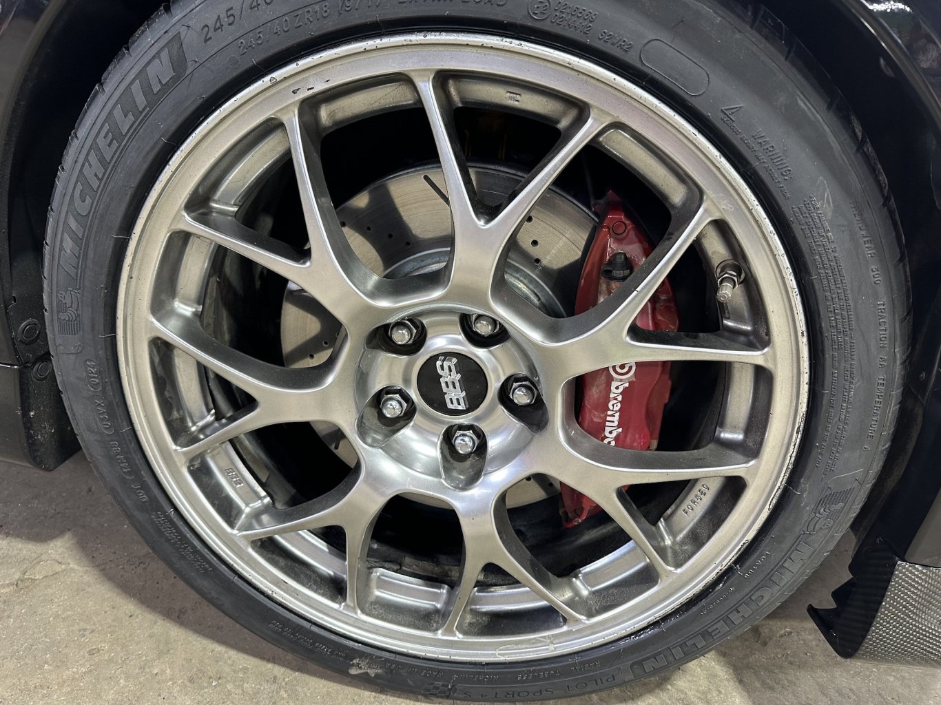

definitely more of a driver limitation than car limitation haha - I did have to drive the ~650km back to Toronto from western Michigan and didn't want to ruin the car haha. Being on all season tyres that started to feel super mushy once some heat got into them didn't help. I've since fixed that by getting a set of Michelin Pilot Sport 4S's earlier this week:
  • Like 8

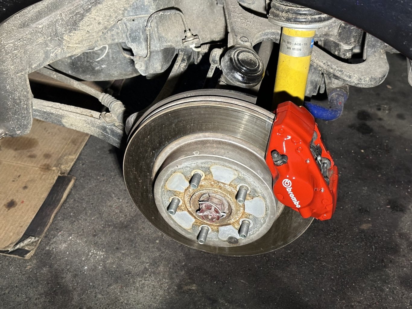

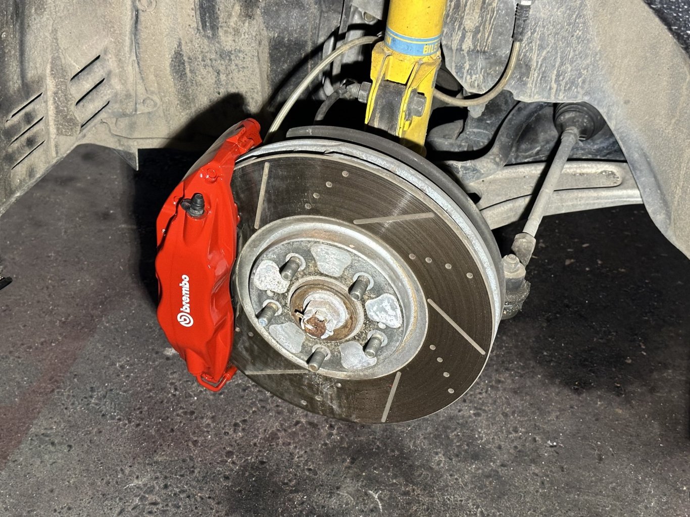

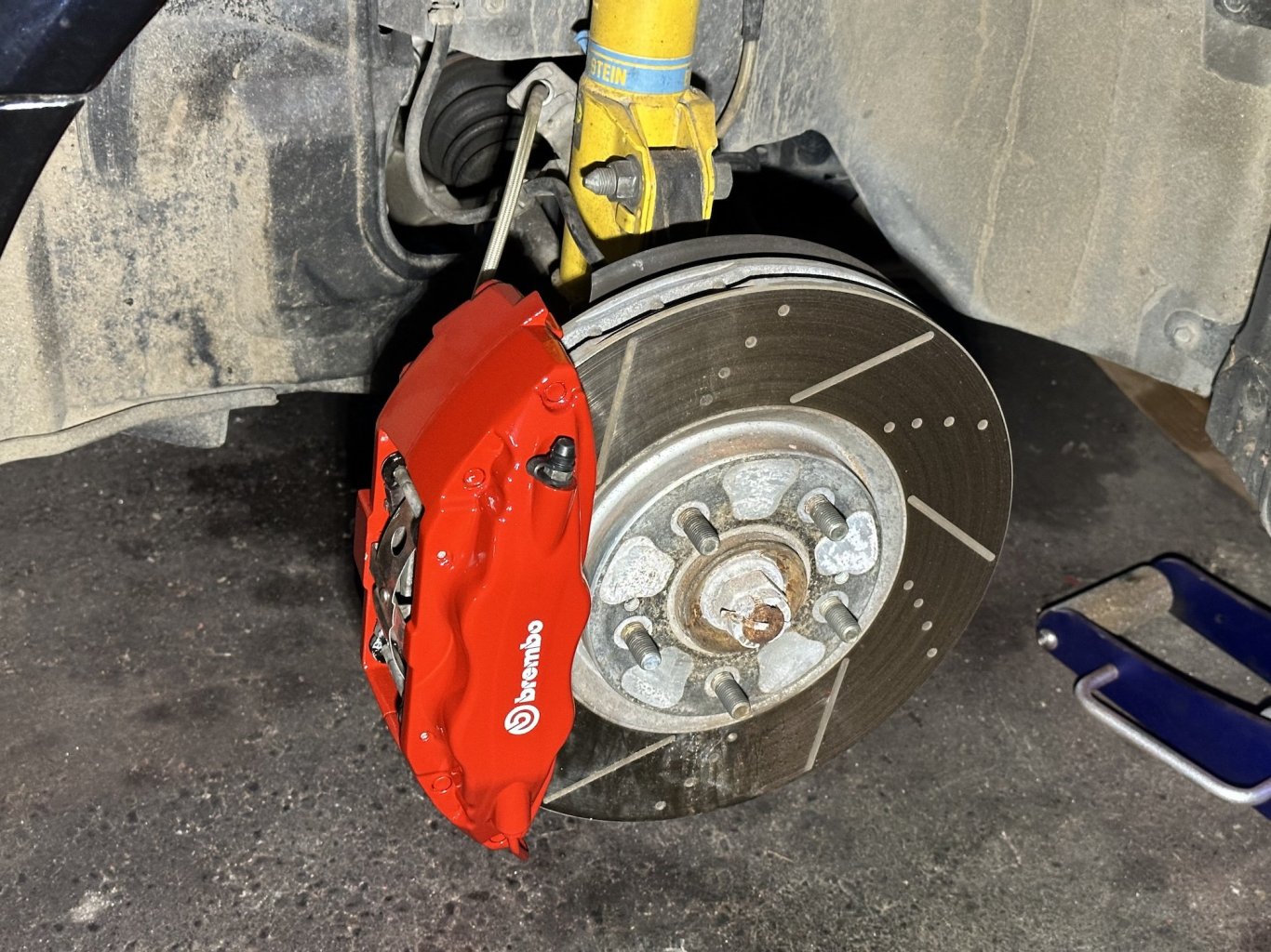

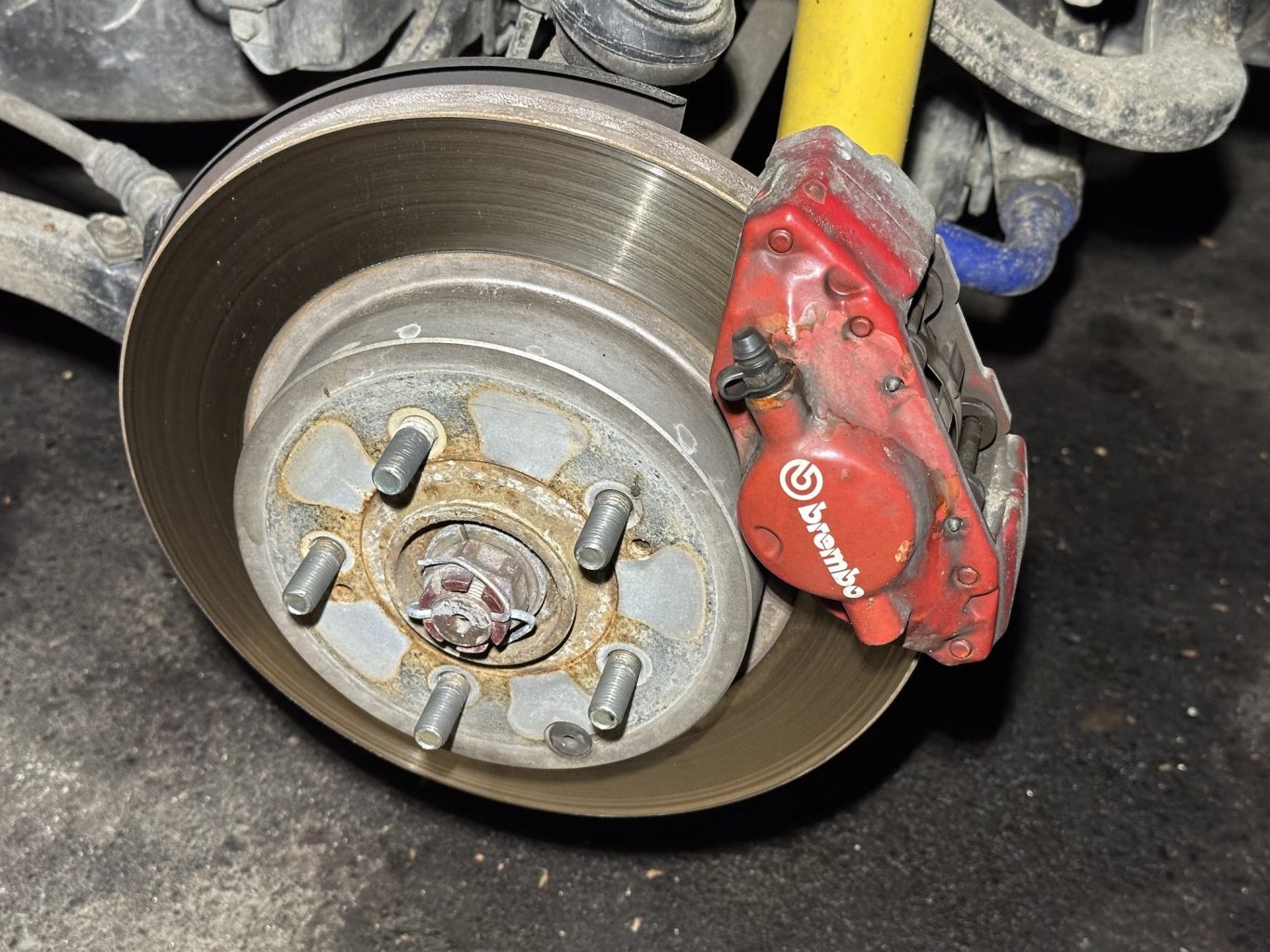

In the meantime, here's pics of the brake caliper refresh - old and crusty:

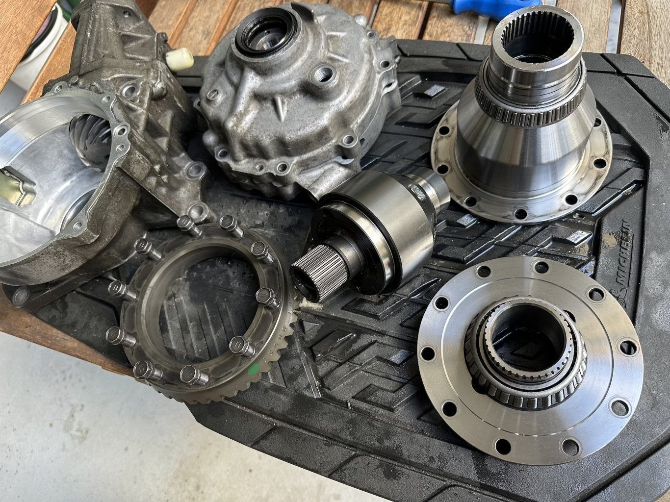

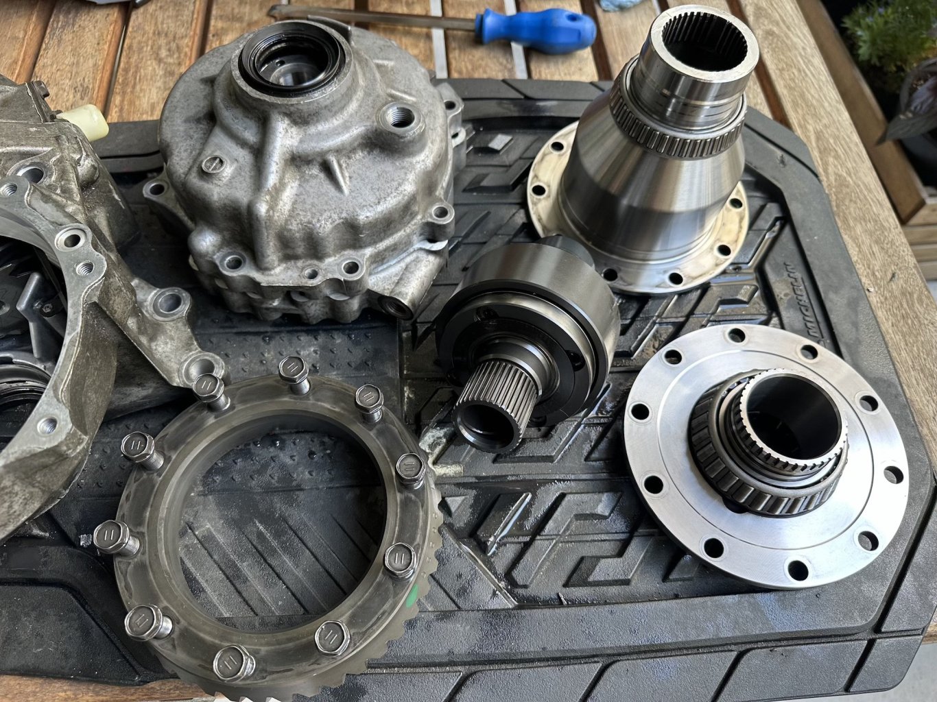

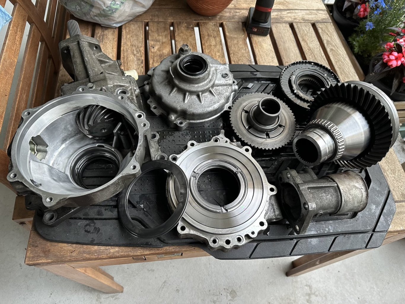

So just to sidetrack and sych myself up to hurry up with the manual swap (gotta tear down the donor 6 speed box to inspect and replace 4th gear hub if needed), I decided to pull apart the donor transfer case (from a JDM Evo 8 RS) to inspect and clean up. This is the transfer case disassembled to its main core components - the ring & pinion gear, active centre diff clutch pack and hydraulic actuator, and the front differential assembly:
  • Like 8
And this is the front diff separated revealing the factory RS helical LSD unit which looks to be in good condition with no cracks showing... yet. The front diff housing is a major weak point for the CT9A Evo and I am seriously considering upgrading to something like a Wavetrac or Quaife while I have it all apart.
  • Like 6

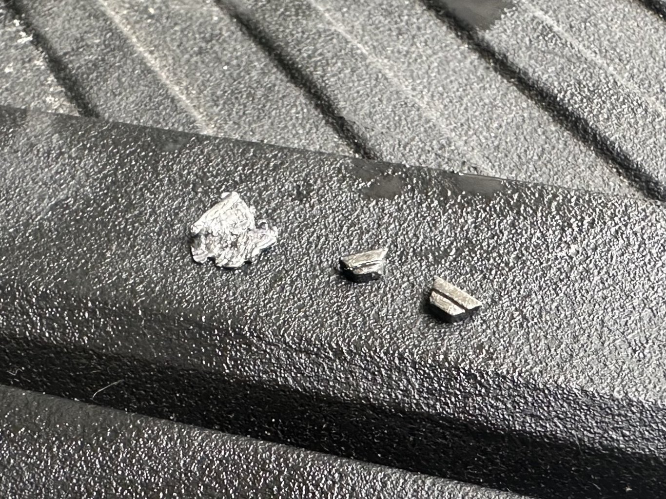

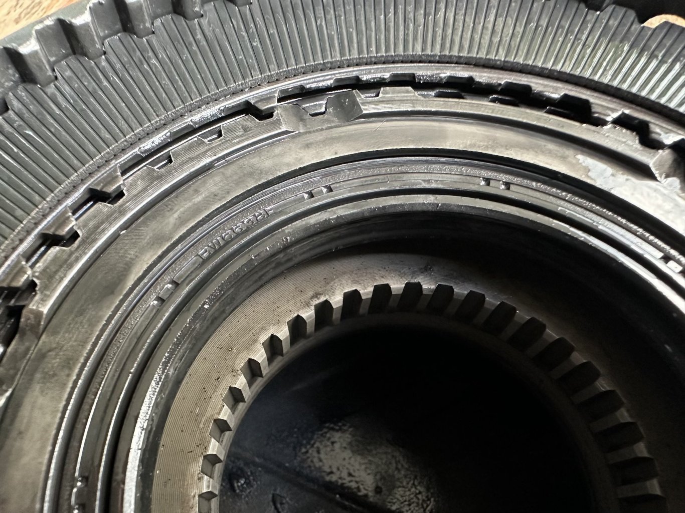

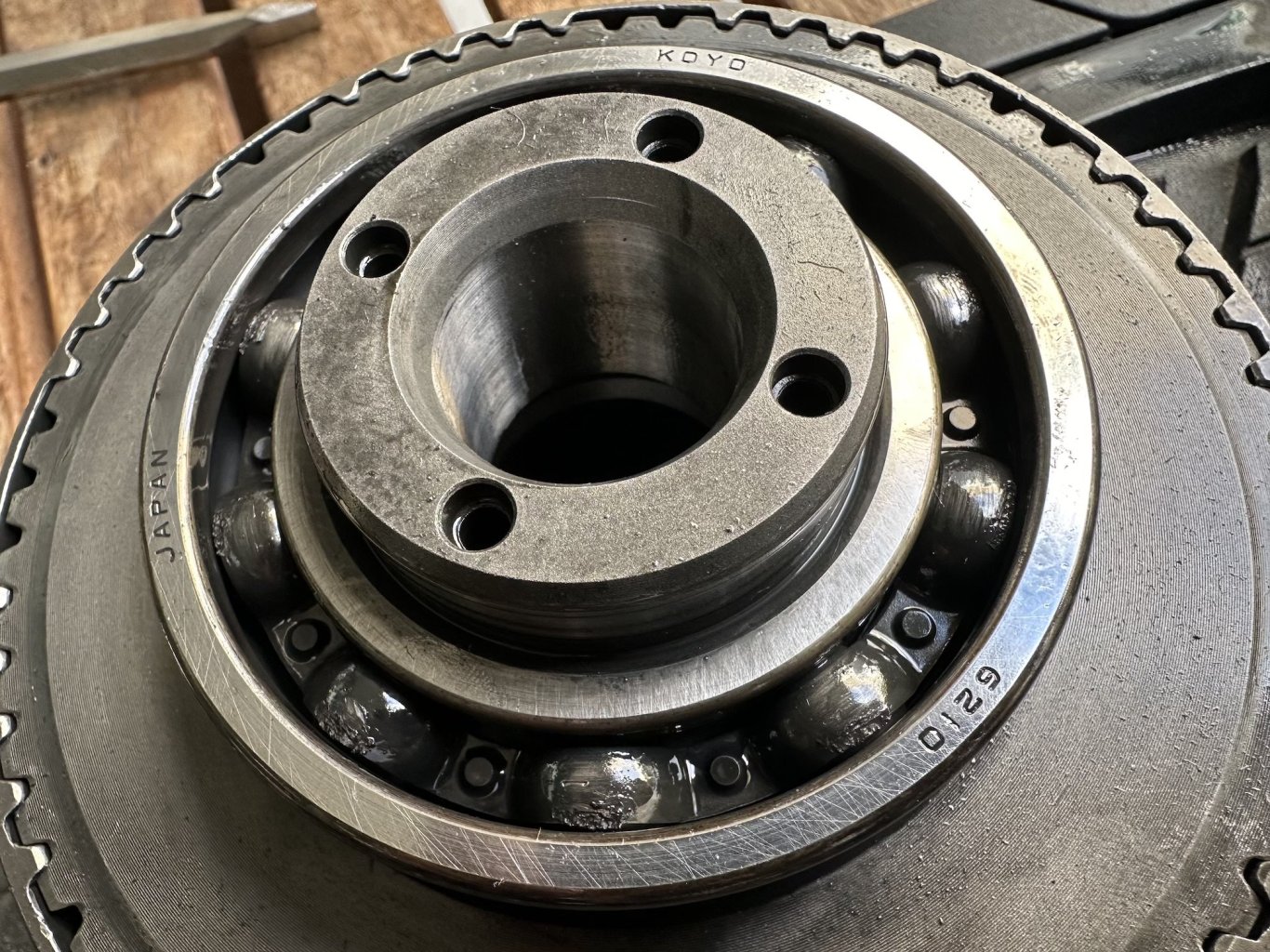

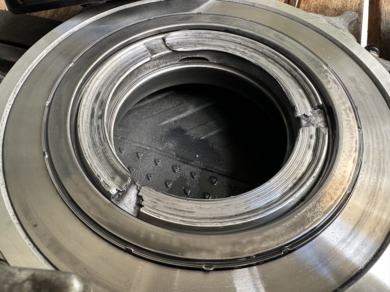

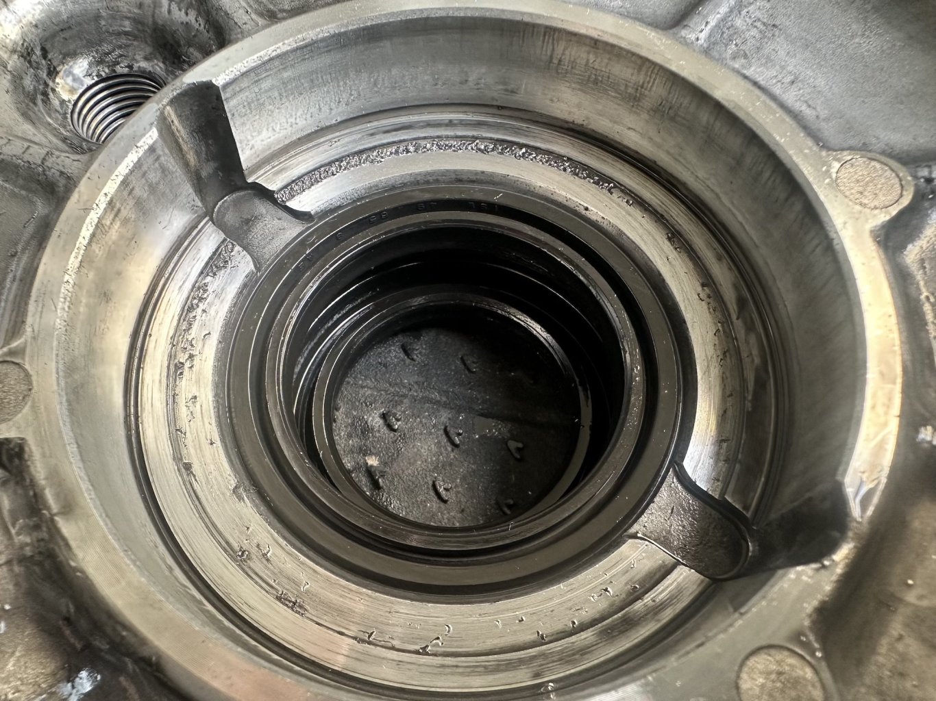

Not all is well however, I noticed some debris stuck inside - some aluminium and some dark metal. Thankfully the ring & pinion are fine with no damage whatsoever, but I wish I could say the same about the transfer case end case where the bearing sits and the bearing itself
