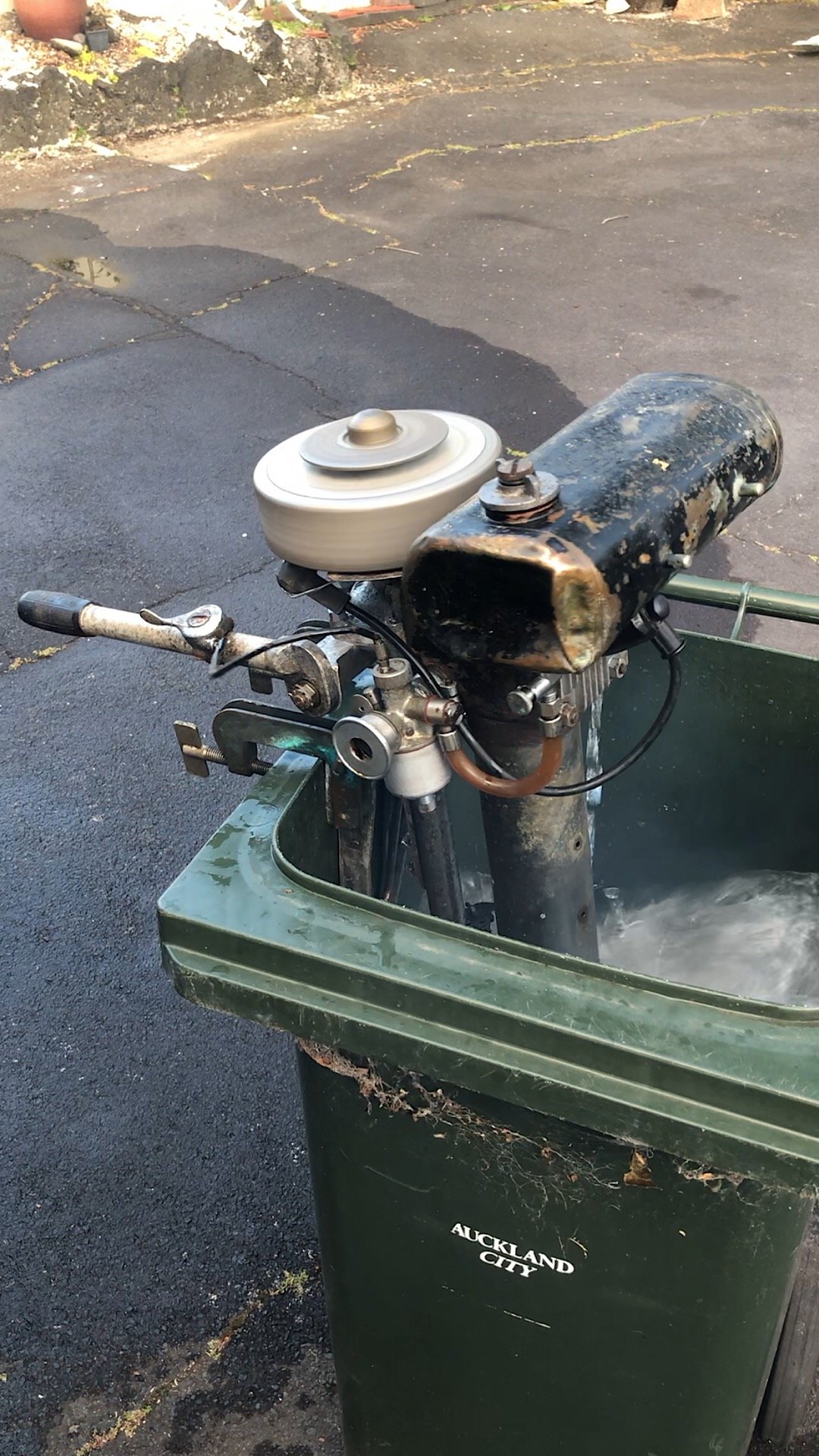

Popular Post Abarth Posted November 12, 2018 Popular Post Posted November 12, 2018 Picked up an old British Seagull outboard off Trademe a couple of weeks ago. This is a 1961 Century 100 model which packs about 4hp. Pretty rough condition dents in the tank and surface rust everywhere. First step was to get it running as it had sat for many years and the sellers weren’t sure if it worked. Got it home, added fuel and first pull it sat there idling like a champ. Stoked! Perfect for cruising round in the dingy for summer. Next is paint.... 18 Quote

Lord Gruntfuttock Posted November 13, 2018 Posted November 13, 2018 I want a seagull now. Don't even have a boat. Just wanna pull apart then run it up in the wheely bin. Looks ace... 8 Quote
Abarth Posted November 13, 2018 Author Posted November 13, 2018 Thanks fellas, they are really cheap on trademe, people seem to leave them for ages in the back of a garage then sell them in unknown condition. Its hectic in the wheelie bin at full throttle haha Runs a hearty 10:1 oil petrol mix so I got some Ipone two stroke oil, smells like strawberry when it’s running which adds to the lol factor. Is this the next summer OS event; Seagull dinghy races? I can picture the spanies now. Edit: Video inspo!! 8 Quote
