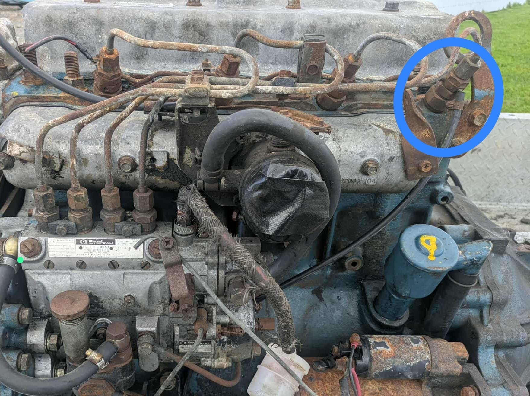

dmulally Posted September 28, 2025 Posted September 28, 2025 Hello all Nissan ED33 from a bus. Does anybody know what this line is that is hanging off the back of number 4 injector? Quote
Mof Posted September 28, 2025 Posted September 28, 2025 It's a return line, you see it goes to a banjo off all 4 injectors. 1 1 Quote

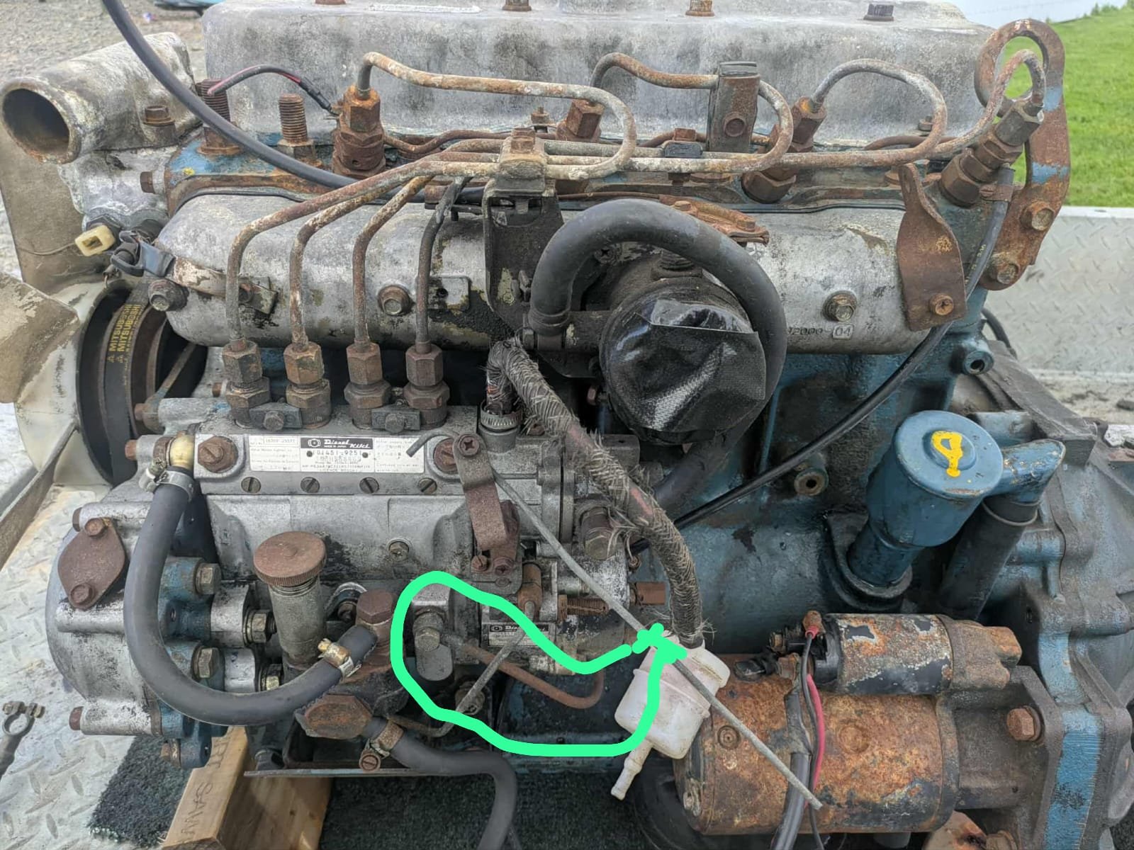

dmulally Posted September 28, 2025 Posted September 28, 2025 3 hours ago, Mof said: It's a return line, you see it goes to a banjo off all 4 injectors. Ta. It's blocked up so I didnt know what it did. If that's the return line, what is the line at the back of the injector pump with the small white filter on it? I thought that was the return. I got the engine running with a hose into a erry along with the inlet hose into the same jerry so couldnt see which was doing what. Runs like a bag of shit but I dont think it has been running in 30 years so it is what it is. 3 Quote
Mof Posted September 28, 2025 Posted September 28, 2025 The injector returns to the fuel pump. At full throttle if the pump is supplying more fuel than the injectors can handle then it returns. The fuel pump has a return also back to the fuel tank 2 Quote

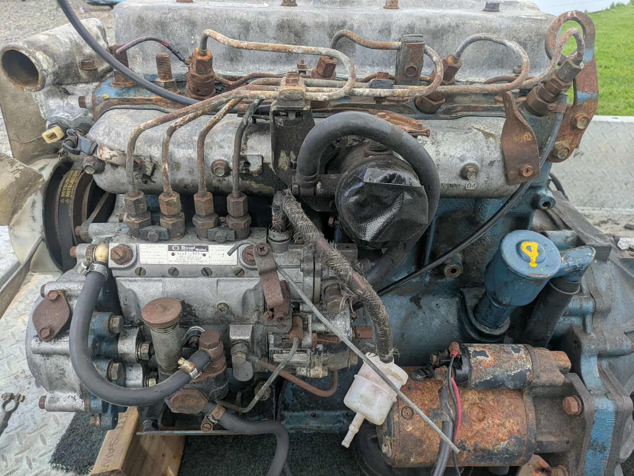

dmulally Posted September 28, 2025 Posted September 28, 2025 15 hours ago, Mof said: The injector returns to the fuel pump. At full throttle if the pump is supplying more fuel than the injectors can handle then it returns. The fuel pump has a return also back to the fuel tank Ta. Do you know roughly where on the pump the small line from the injector goes to? Would it help if I took a few happy snaps? Quote

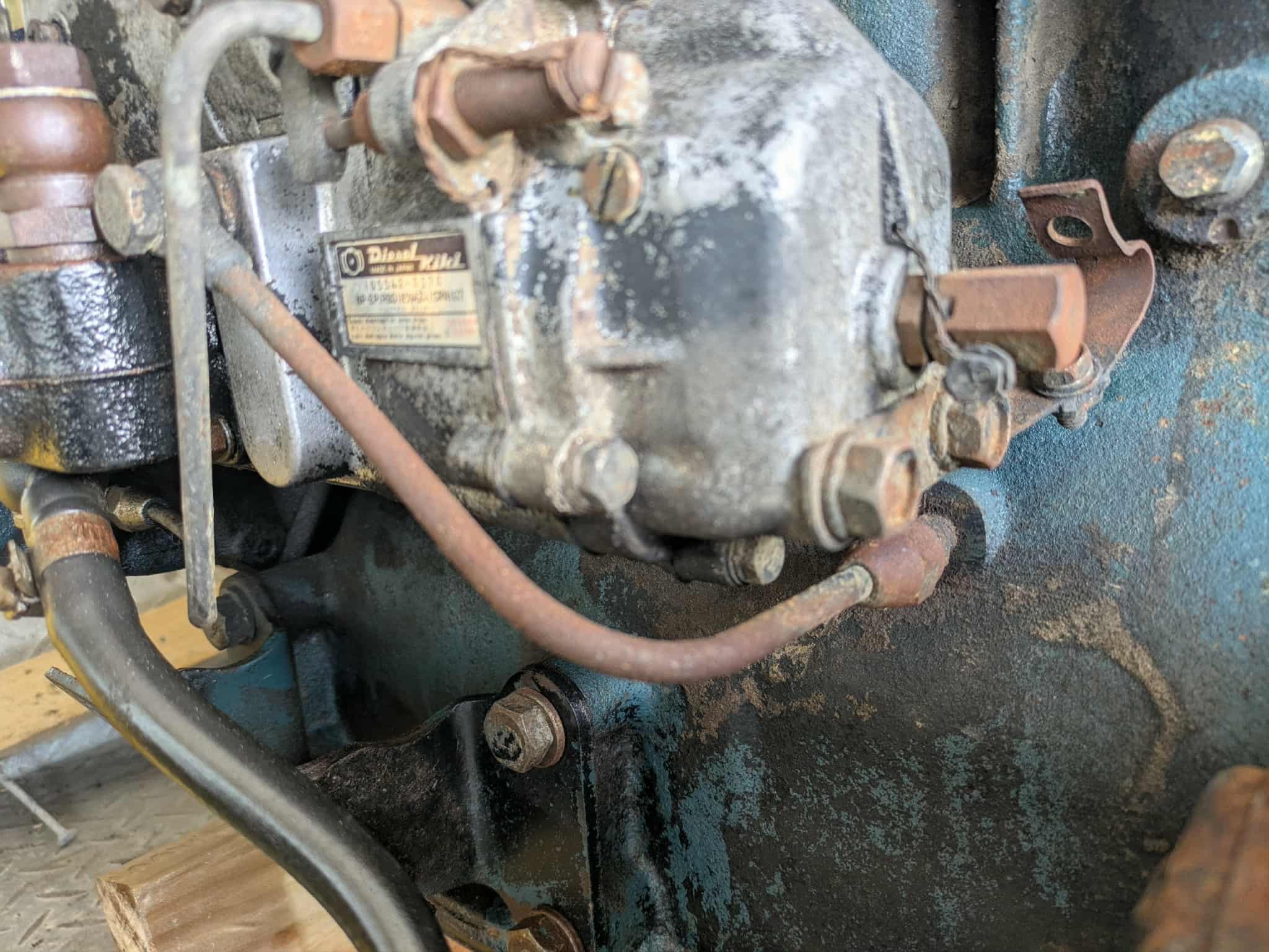

Raizer Posted September 28, 2025 Posted September 28, 2025 11 minutes ago, dmulally said: Ta. Do you know roughly where on the pump the small line from the injector goes to? Would it help if I took a few happy snaps? I'd say that one. Quote
dmulally Posted September 28, 2025 Posted September 28, 2025 39 minutes ago, Raizer said: I'd say that one. That one goes into the block. Quote
Raizer Posted September 29, 2025 Posted September 29, 2025 35 minutes ago, dmulally said: That one goes into the block. Ah interesting, on several others that's the spot for the return. 1 Quote
dmulally Posted September 29, 2025 Posted September 29, 2025 What I might do is unclog it at the end and when it's warmed up give it the jandal to see if anything comes out. If it does I'll loop it back to the fuel tank somehow. The only problem I'm worried about is if when revving it out the smoke that comes out will bring unwanted attention from the ladies. We all know what soot gets. Quote
Mof Posted September 29, 2025 Posted September 29, 2025 4 hours ago, dmulally said: Ta. Do you know roughly where on the pump the small line from the injector goes to? Would it help if I took a few happy snaps? Yeah that's as far as my memory goes. There must be a little hose tail or something back there for it to go to. Tbh I never took a lot of pumps off, heads and injectors yes. 1 1 Quote
Hemi Posted September 29, 2025 Posted September 29, 2025 Man I'm jogging my memory hard but it doesn't go to a 2 way banjo does it? Just straight back to the tank with the return One outlet on banjo for main return, one tiny one for the injector Quote
dmulally Posted September 30, 2025 Posted September 30, 2025 13 hours ago, Hemi said: Man I'm jogging my memory hard but it doesn't go to a 2 way banjo does it? Just straight back to the tank with the return One outlet on banjo for main return, one tiny one for the injector Perhaps. It's just chopped off and clogged full of ancient oil and grease at the moment but I did think about plumbing it into a T piece on the return line from the back of the pump. Quote
