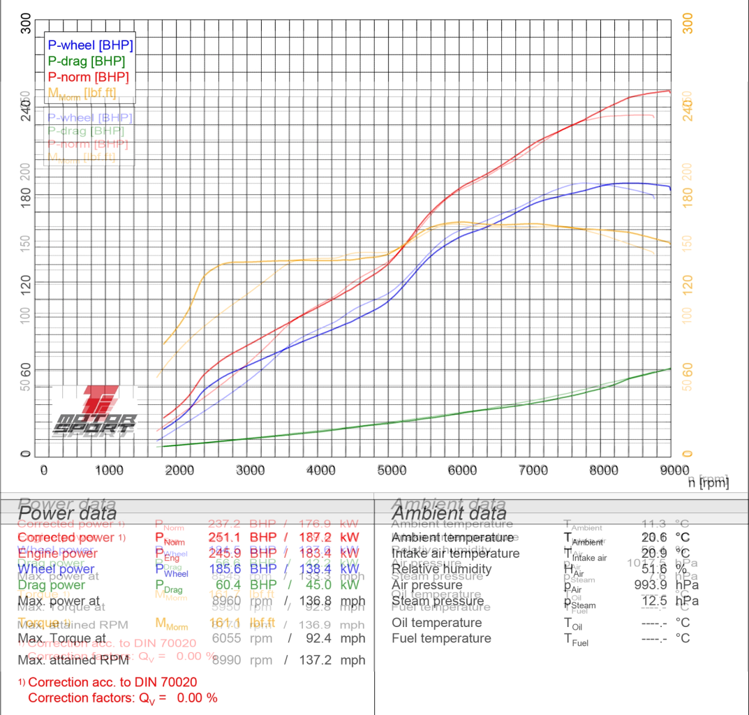

Roman Posted May 21, 2023 Posted May 21, 2023 Okay soooo They had 184.5 wheel horsepower. Then fitted ITB, and now they have 185.6 wheel horsepower. So a 1.1 horsepower gain in real life. But they now for some reason have 60.4 horsepower drivetrain loss instead of 56.6 horsepower drivetrain loss. Did someone pour sand in the gearbox when doing ITB swap? haha. This is why I hate "at engine" power figures. 3 1 Quote

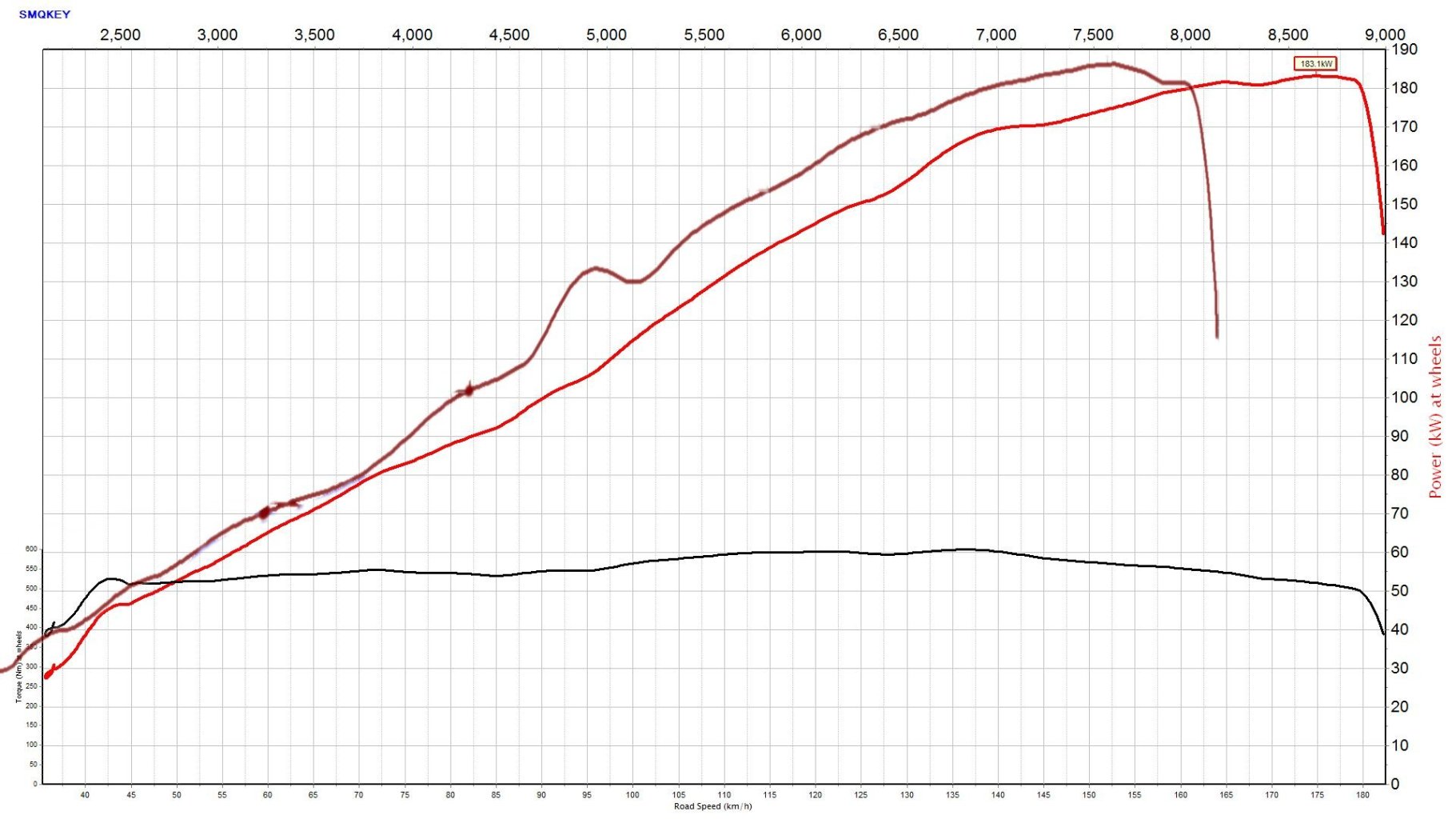

Popular Post kpr Posted May 21, 2023 Popular Post Posted May 21, 2023 As above, I have been looking at some of the stuff they post. as been playing with a k24. They quote all these different gains in bhp, but the wheel hp on the same graph says something different. also mega driveline losses. Ive roughly overlaid the graphs blue is the wheel hp. red "engine" power. light lines stock intake, dark itb. Looking at the wheel power. the stock intake manifold would be a quicker car. unless you could run between 8000 & 9000 rpm the whole time. even then wouldnt be anything in it. Why, The itb's will probably flow more. but the runners are way to short to make any jam over the whole rev range. stock inlet will be running out of flow and or slightly too long to make power at 9k ITB's only work good if you dial in the runner length and have the flow to go with it. Seems to be super common with K series stuff. even the factory inlets. They are too short with big runners. or long with small runners. I think those itb's you have will be a touch on the small side. possibly ok. but can get away with over sizing the intake a bit. not so much under sizing it. if make the runners small enough to gain in the bottom end (talking rpm you will never use in circuit car) will lose top end. if a bit too big, not much happens. not trying to lecture you, just wouldn't be fun to have to do it twice if you didn't have to. This is the intake i just made for k24. Big long runners. gains everywhere over RBC honda inlet. which is spose to make more peak power that the stock ep3 one they compared the itbs too. 8 3 Quote
Hyperblade Posted May 22, 2023 Author Posted May 22, 2023 19 hours ago, Roman said: Okay soooo They had 184.5 wheel horsepower. Then fitted ITB, and now they have 185.6 wheel horsepower. So a 1.1 horsepower gain in real life. But they now for some reason have 60.4 horsepower drivetrain loss instead of 56.6 horsepower drivetrain loss. Did someone pour sand in the gearbox when doing ITB swap? haha. This is why I hate "at engine" power figures. You have to love the drivetrain loss going up just at the end of the graph to produce a nice curve, very convenient for them... To be fair the ambient temperature was different on the day. But yeah, people need to stop with BS made up figures. 16 hours ago, kpr said: As above, I have been looking at some of the stuff they post. as been playing with a k24. They quote all these different gains in bhp, but the wheel hp on the same graph says something different. also mega driveline losses. Ive roughly overlaid the graphs blue is the wheel hp. red "engine" power. light lines stock intake, dark itb. Looking at the wheel power. the stock intake manifold would be a quicker car. unless you could run between 8000 & 9000 rpm the whole time. even then wouldnt be anything in it. Why, The itb's will probably flow more. but the runners are way to short to make any jam over the whole rev range. stock inlet will be running out of flow and or slightly too long to make power at 9k ITB's only work good if you dial in the runner length and have the flow to go with it. Seems to be super common with K series stuff. even the factory inlets. They are too short with big runners. or long with small runners. I think those itb's you have will be a touch on the small side. possibly ok. but can get away with over sizing the intake a bit. not so much under sizing it. if make the runners small enough to gain in the bottom end (talking rpm you will never use in circuit car) will lose top end. if a bit too big, not much happens. not trying to lecture you, just wouldn't be fun to have to do it twice if you didn't have to. This is the intake i just made for k24. Big long runners. gains everywhere over RBC honda inlet. which is spose to make more peak power that the stock ep3 one they compared the itbs too. Yep, here's another brilliant one from them, I'm sure you've already looked at it. https://www.tegiwaimports.com/blog/?p=2443 I got caught out by this one when I brought my current ultra street manifold, i'm much more careful looking at these things now. Lecture away! (happy for anyone too), I always like considering all the possibilities and discussing this stuff with people who have actual real world experience. I agree slightly larger ITB's would be ideal so that you have a bit of wiggle room, but the feedback I've had is the normal Jenvey ITB's worked the best on a dyno(on built k20 in CRX) when comparing multiple different types, so if i match them in design I'm confident that it should perform at least better than the skunk2 intake I have currently. But I'm limited by what you can easily get off motorbikes due to the pricing, I had a look around at other options, but nothing stood out. However I do have a couple of other things planned to throw into the mix. Outboard injection. Variable velocity stacks (I'm on the hunt for a standard S1000RR airbox to get the mechanism) Intake will be using ram air to create pressure through filter and into air box. I have heaps of room to play around with lengths of stacks (which will be 3d printed so not expensive to make). Do you have any good calculators you use for working out lengths of intake runners? I also need to find the measurement of valve to intake flange to use in them. Just for reference car normally runs between 6000 to 9000rpm in a lap with lowest being 4700 rpm at hairpin. Being light and having the torque allows me to use more of the rev range, which helps with not overworking the tyres. Quote

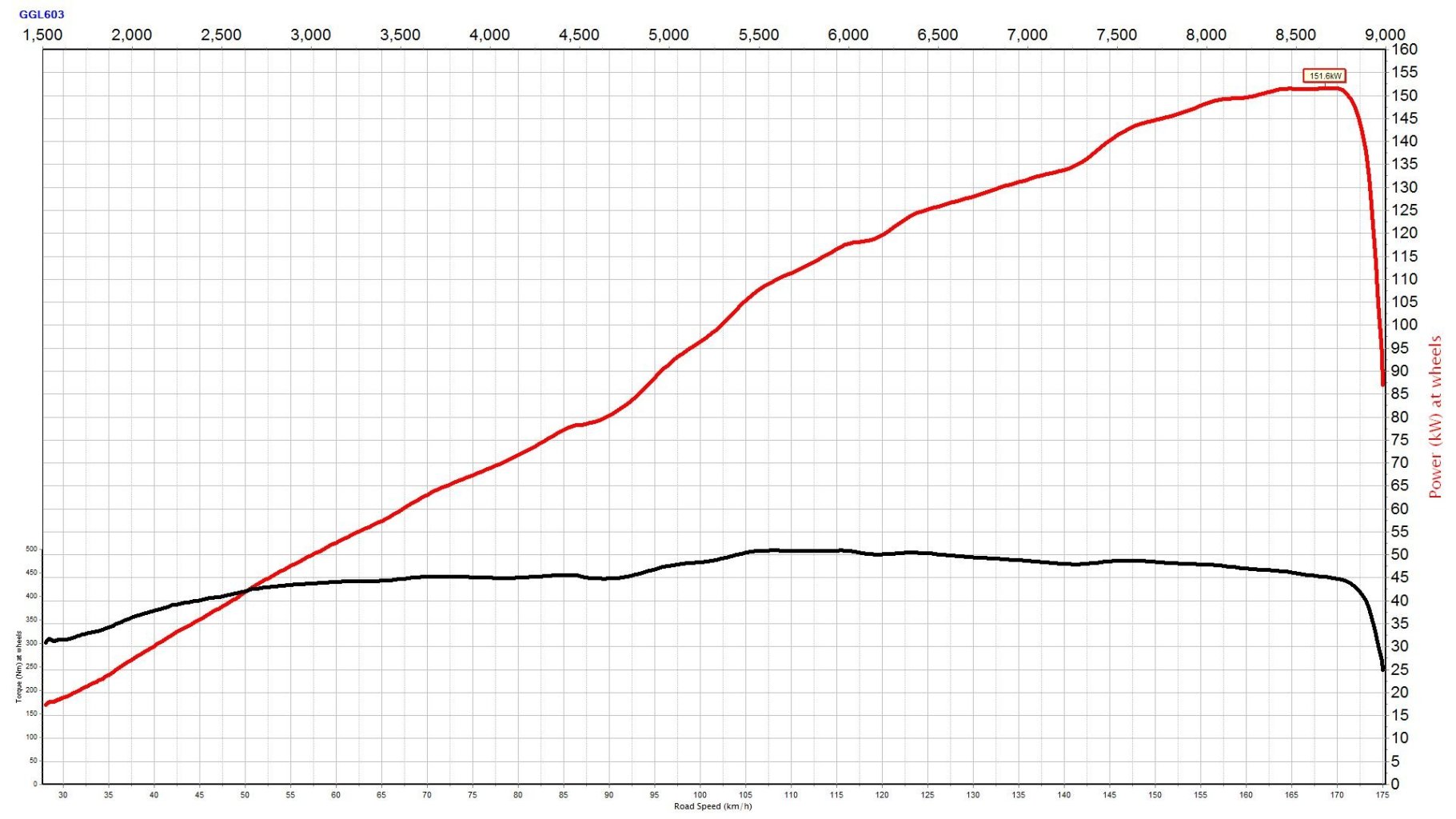

kpr Posted February 5, 2024 Posted February 5, 2024 probably fine long as the bends arent super aggressive. assuming you are still using the 47mm throttles. probably best to have them on the shorter manifold, then can taper up in diameter sooner Interestingly i just tuned a k20 on my dyno. had really short intake with big plenum and big short headers. done as expected. made 202hp and weak through the middle. 2 1 Quote
Hyperblade Posted February 5, 2024 Author Posted February 5, 2024 10 hours ago, kpr said: probably fine long as the bends arent super aggressive. assuming you are still using the 47mm throttles. probably best to have them on the shorter manifold, then can taper up in diameter sooner Interestingly i just tuned a k20 on my dyno. had really short intake with big plenum and big short headers. done as expected. made 202hp and weak through the middle. 48mm throttle plate, 46mm (same size as port) outlet to runner. 53mm inlet to velocity stack. Are you going to remake the intake for it? Would be interesting to see another back to back but on k20. Quote

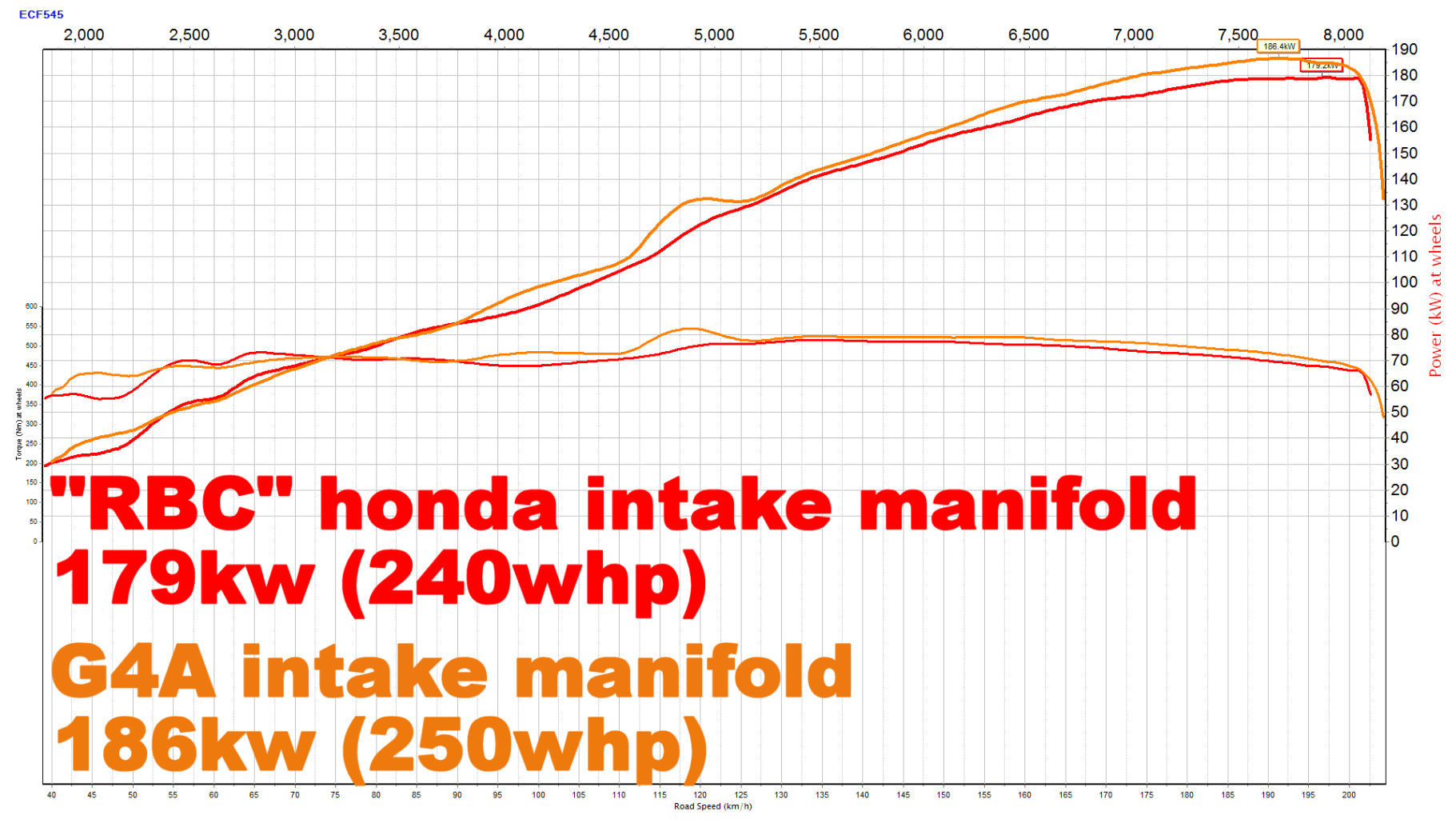

kpr Posted February 5, 2024 Posted February 5, 2024 probably not, just come in for a tune. But i sold the intake off the ep3 , to another guy with a k24. k20 head and stage 3 cams, so better head and bigger cams. Done the initial tune on my dyno when it had a skunk2 ultra race? intake. which is the red below, and the ep3 k24 in brown. He lives quite far away, so remote tuned it to get the afr right when he swapped to my inlet manifold. had to add a lot of fuel through the middle and some up top. so probably pretty close to the ep3 power curve now. Don't see why the k20 wouldn't do the same thing. the heads flow good and have plenty of cam from factory, so good gains in getting the bolt ons right. this is the k20 2 Quote
