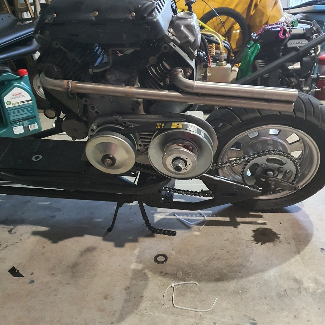

Muncie Posted September 22, 2020 Author Posted September 22, 2020 Right that on the floor needs to go right where my lovely swoopy exhaust is..... might just experiment with new pipes at same time. CVT Time excitement! off the line punch and top end, up till now ive only been able to have one or the other. And the compromise of the exploding pocket bike wheels or a slipping clutch on take off for top end. Was on special finally from Motiveparts (nz company) so i decided to finally do it. The long suffering clutch was only ever rated to 8hp this one is 13hp the guy i bought from assures me it'll take my power easy because its light and gearing is pretty decent. 3 Quote
Muncie Posted September 22, 2020 Author Posted September 22, 2020 Cool its going to work. Bees dick clearances but a gap is a gap chain appears to fall in right spot. Exhaust will not sadly. 3 Quote
Muncie Posted September 24, 2020 Author Posted September 24, 2020 It runs but things need shimming the chain isnt quite right either. Quickly fashioned pipes look cool but are deafening so will add some muffling.... later maybe a bozusoku sytle supertrapp. Will get a sack of 8mm washers and make some clearance happen over weekend. 5 Quote
Muncie Posted September 26, 2020 Author Posted September 26, 2020 Shims in chains adjusted up and off for first ride needs a few revs to get going but fuck shes off as soon as the clutch engages not snatchy either which is nice. Annoyingly the starter solinoid has shat itself and its running a bit shit. And that exhaust is awful sounds like a fart through a trombone. If weather isnt shit i might try an extend ride out back of nowhere as the carb usually sorts itself out after a few minutes, keen to run the Cvt through its range to see how it behaves at like 80-90 k 1 Quote

Muncie Posted October 14, 2020 Author Posted October 14, 2020 Machined these two spacers up for the cvt shorter is to set up as per instructions the other is a trial "low stall" setup to hopefully get it moving with less revs. This engine loves been loaded up and the cvt is intended for things bit more gutless down low so just experimenting. I managed to blow the outer cover off the driver pulley somehow as well cant figure out how but i was fair hauling when it lost drive and rolled to a stop....... long push back to trailer. Quote
Kimjon Posted October 14, 2020 Posted October 14, 2020 The brass slip collar on mine exploded after about 20 minutes of total running time. But meh, doesn't feel any different without it and the belts so loose I can't see it wearing it out any quicker without it there. The Cvt is weird though eh. I didn't think it was a great decision immediately after trialing it, then we raced each other on the drift trikes, it was clearly faster. Quote

Muncie Posted October 14, 2020 Author Posted October 14, 2020 Fitted the supertrapp with what bends and pipe i had left sounds nice and thumpy and not too loud, it pops a bit and spits massive blue flames on deceleration (like a 40cm ring of flame!) I'll redo the headers in 1 1/2" eventually and move the muffler lower and out of way but for now its usable again. Low stall mod worked engages drive earlier doesn't seem to have affected the cvt operation changes ratios as it did before. 3 Quote
