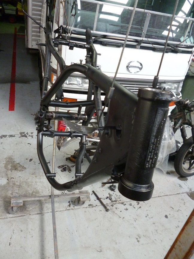

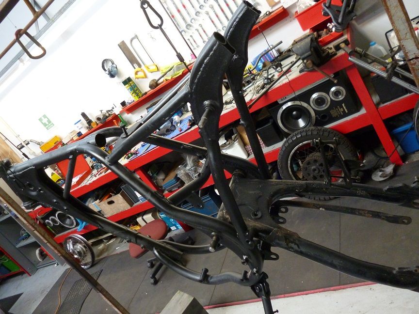

Put a coat of Black Zinc just for now while i mod the frame and weld up new tabs for shit, just wanted something on it will it was bare hence the paint jobs abit rough
Swing arm wasnt blasted, will just paint strip it i think, but for now its just degreased and cleaned up

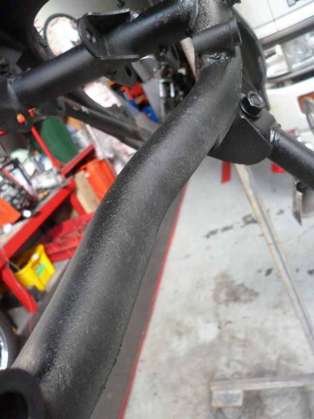

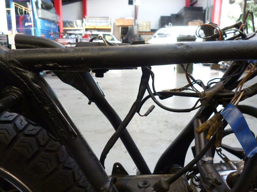

You can see the state that the frame is in,

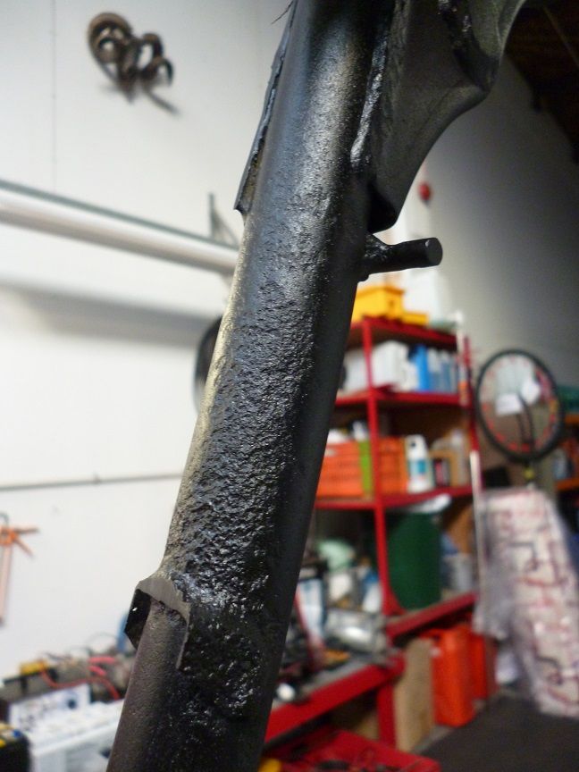

most of it just looks like this, textured paint look, which should be sweet once its primed and painted properly
This shits abit different tho, might have to weld fill this

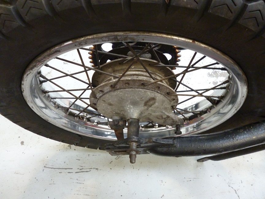

Degreased the wheels, the rear was covered in grease.......
...Came up really good! this is with no polishing, just cleaning aswel.

So bee awhile since the last update, shits on the go slow with us both being on electric at the moment
Danny has done his frame mod, which looks fucking sweet!!
The factory frame looks as bent as a gay dudes slong, Now looks level side on with the up sweep rear tail section

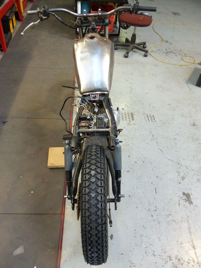

Electric poohar water troff is all done and installed now, and the wiring is looking pretty neat considering how much is stuffed into that tray

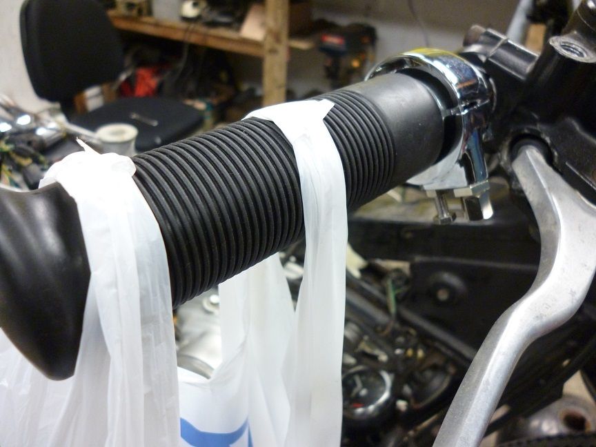

New throttle

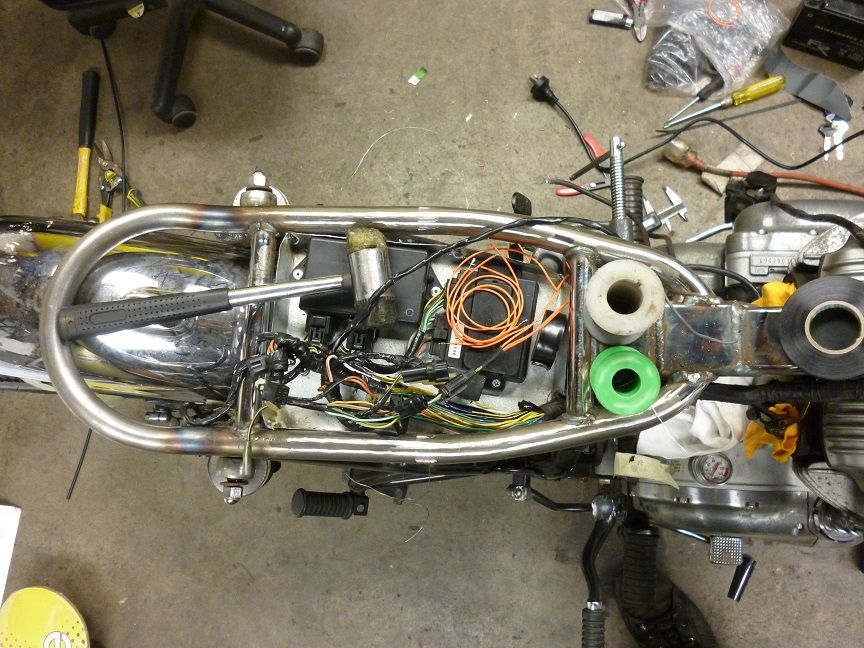

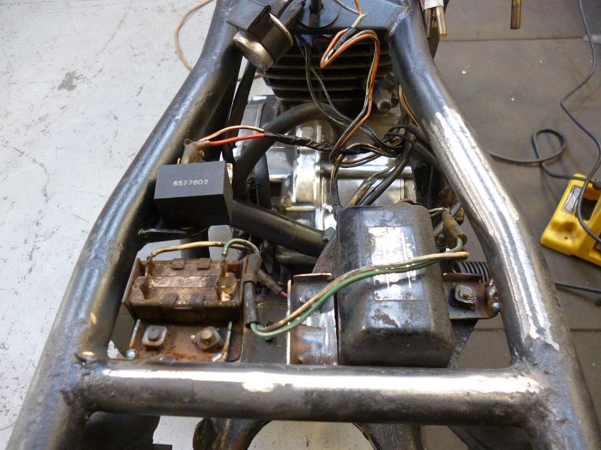

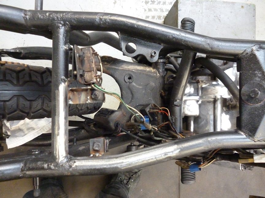

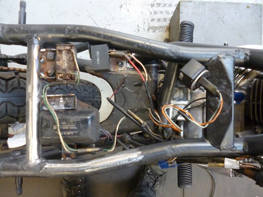

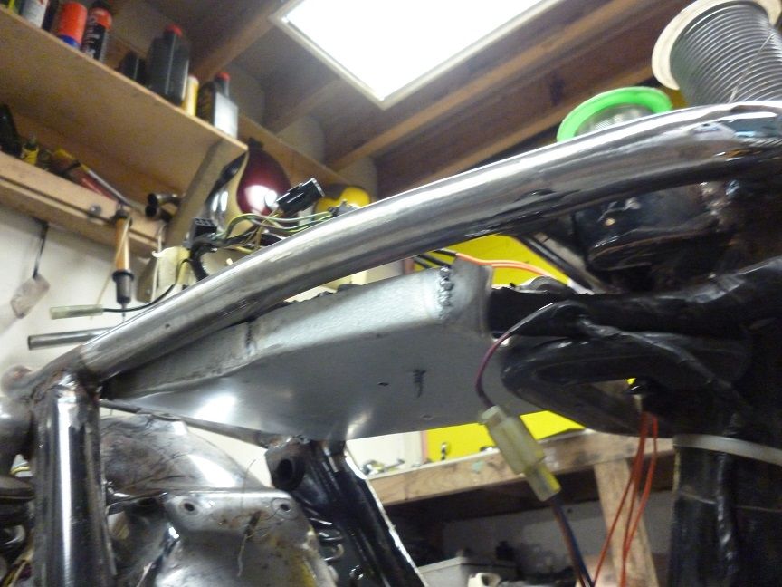

So I havent been doing a whole heap, just remounting eletric magic boxes...
Factory

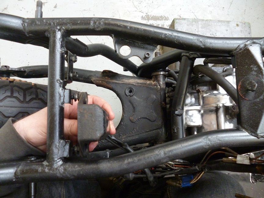

New mounts in, just need one more for the flasher, then ill get onto getting a small battery and make a mount for that, being 6v should be able to get a small one no worries
hopefully i can make the battrey sit high enough up that you wont be able to see it side on
Pretty happy with it, tried to make it look nice and clean also not 100% sure how ill be mounting the seat so wanted to be able to remove the electrics from the bottom aswel as the top

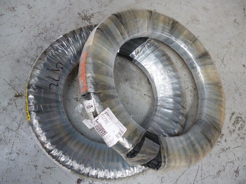

CHECK OUT MY PACKAGE!!!!!
Ive been up in Napier since monday, got a txt from Danny on Tuesday saying come get your tyres slut, but had to wait till yesturday
YEAH!!!!!!!!!!!! ANUS'S!!! I love that shit!

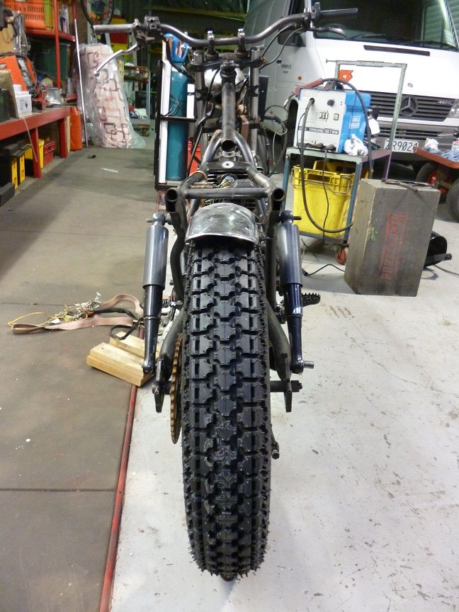

Zurst tip is just mocked
Super balloon! I know what your thinking, "JUST FIT THE FUCKING THINGS, DICK"  Fingers crossed I can get them fitted today and another update this arvo of them fitted
  • Like 4

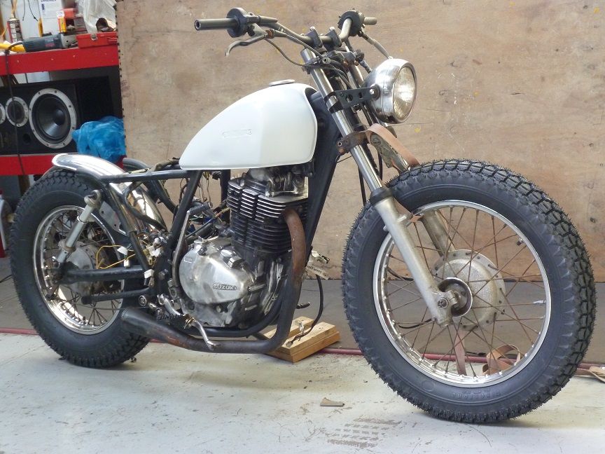

Fingers uncrossed....

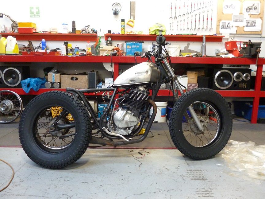

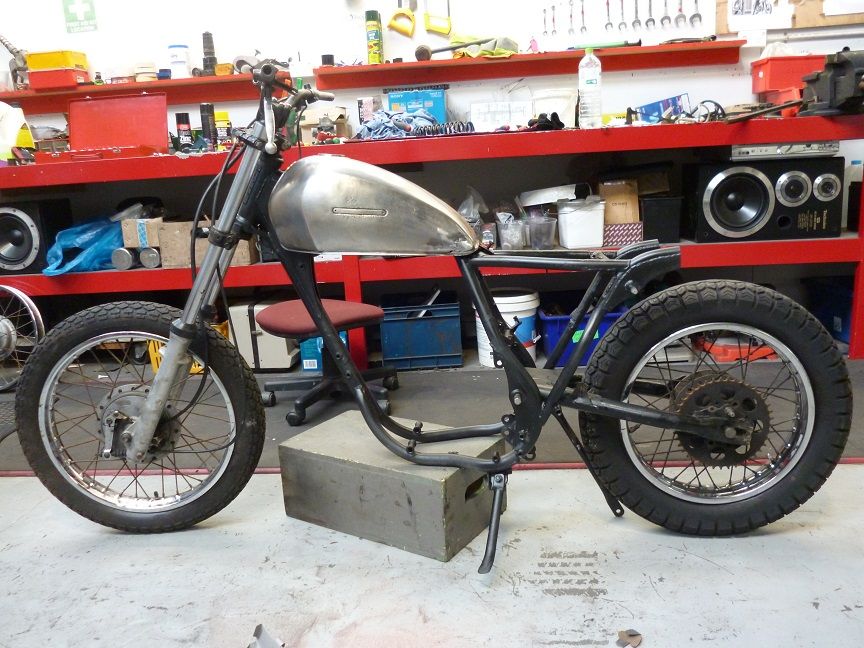

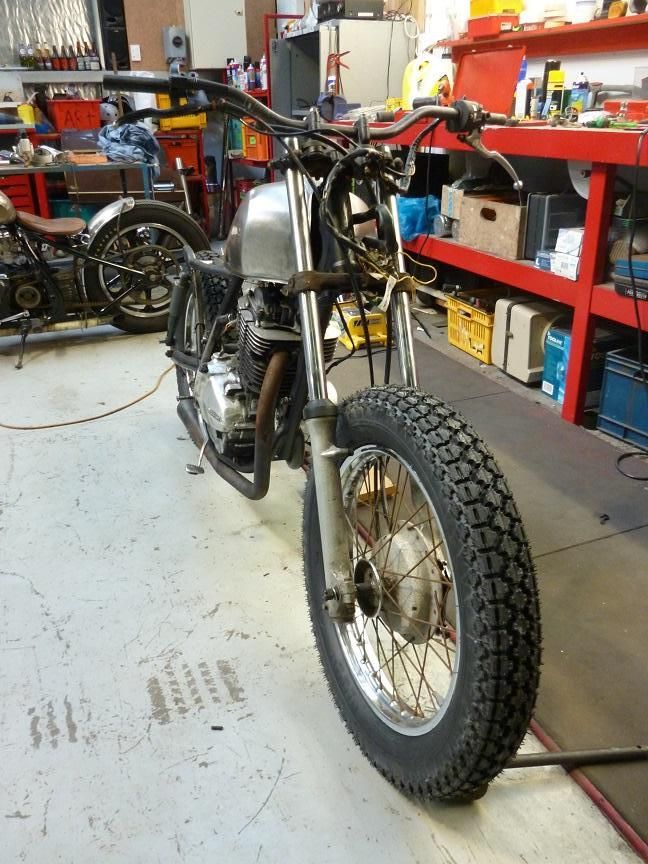

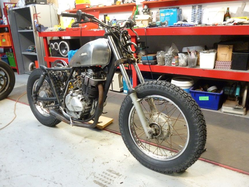

There big in person, front looks alot bigger than photos show aswel
Bars make more sense now i recon

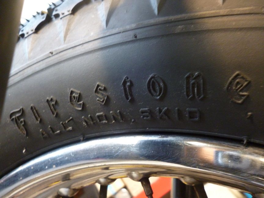

Non skid???!! we'll see about that!

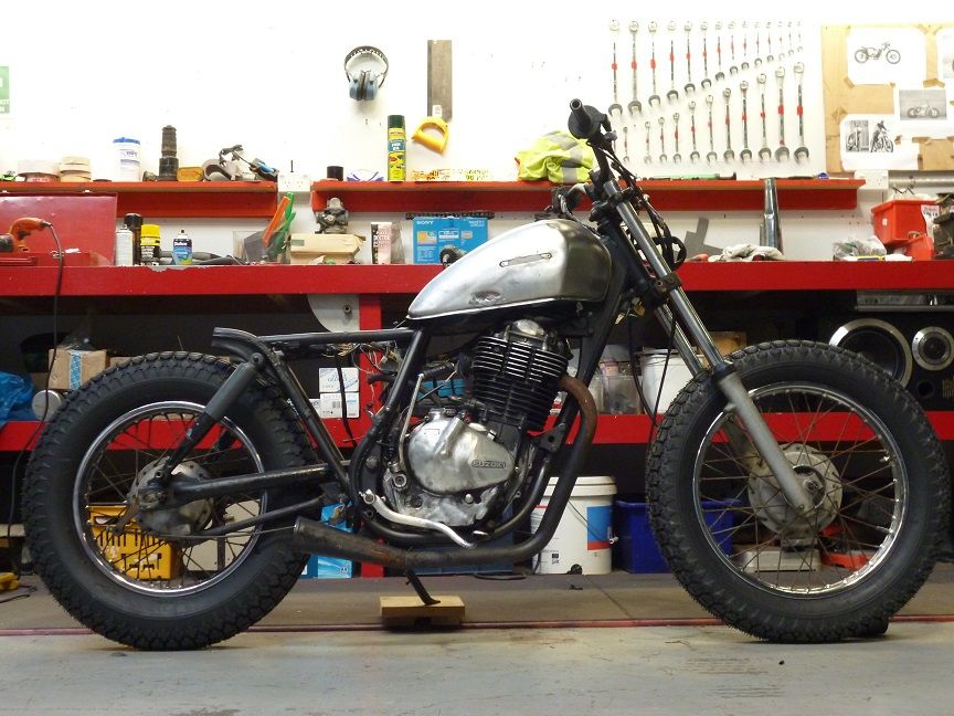

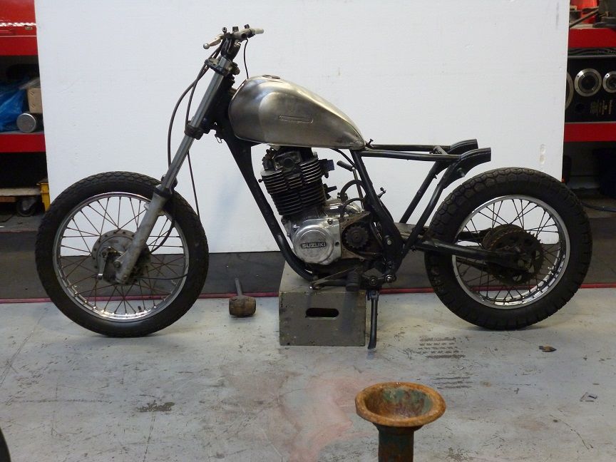

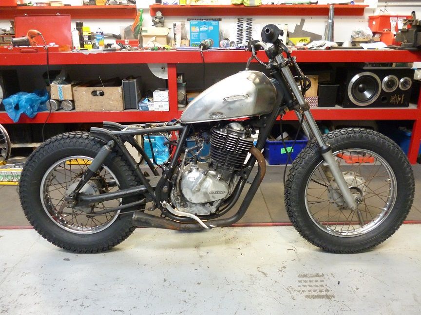

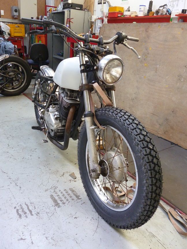

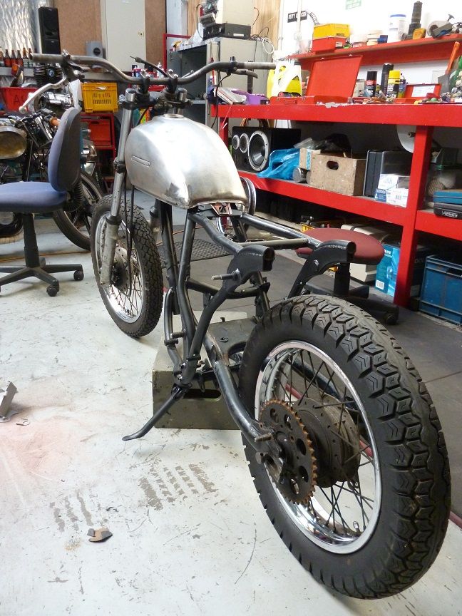

Danny came round and we played around with lowering the front end, Looks way better!  lowered the tank a little aswel
Done for now, have a good weekend kids

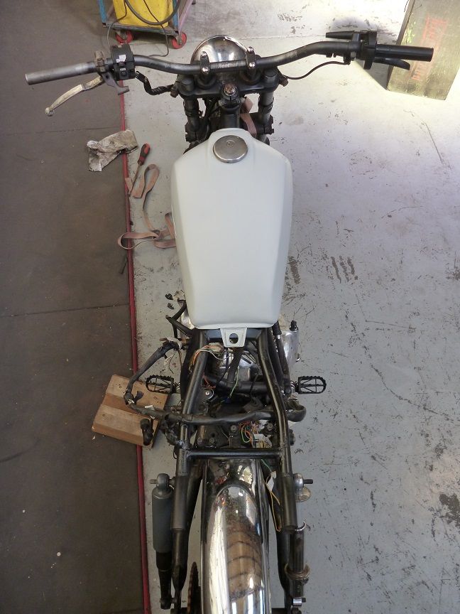

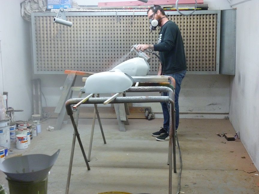

Got some prime-hole on my tank, Tanks to Chris
other tank and bits are for chris's hog

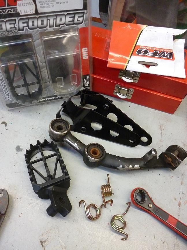

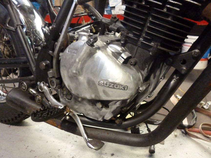

Put the new foot pegs on, had to modify the hangers, worked out all good, apart from one flaw that i fuct up on - keen motorcycles will spot
Think they look oright, not sure if Im just steering at them and not totally all bout them or once its all done, mounts are black, and youll hardly notice them

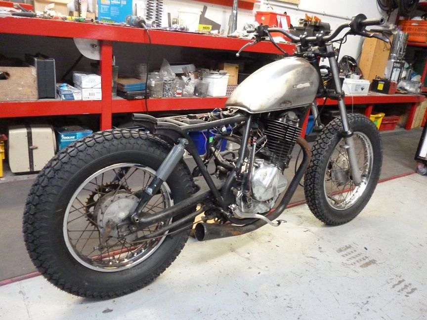

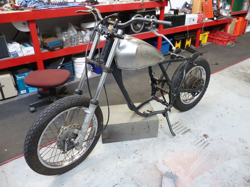

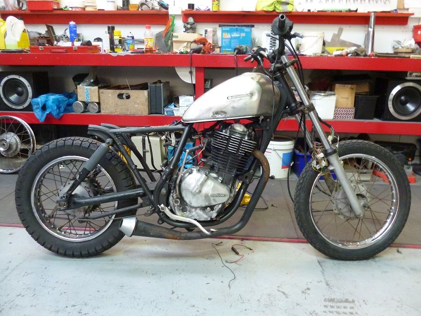

Lowered the rear and front abit more, the rear is at 60mm on the shock and front is 110 in this photo, Im think bang on 100mm will level out the tank and frame nicely
and Im happy with that for swing arm levelness haha once i sit on it itll be sweet

Top view of foot pegs,

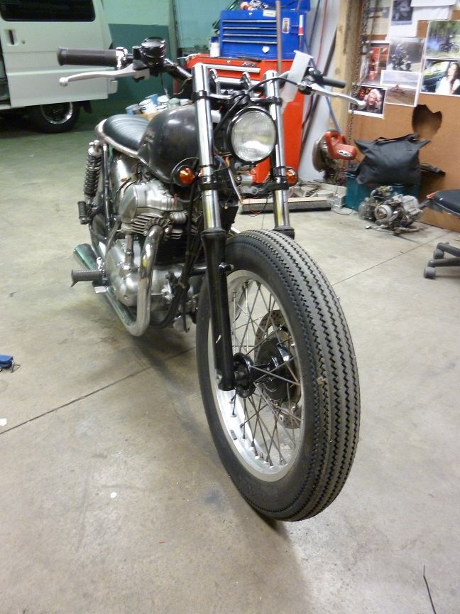

Dannys hog is looking pretty much finished....looking anyway. He peiced it together the other night and rode it

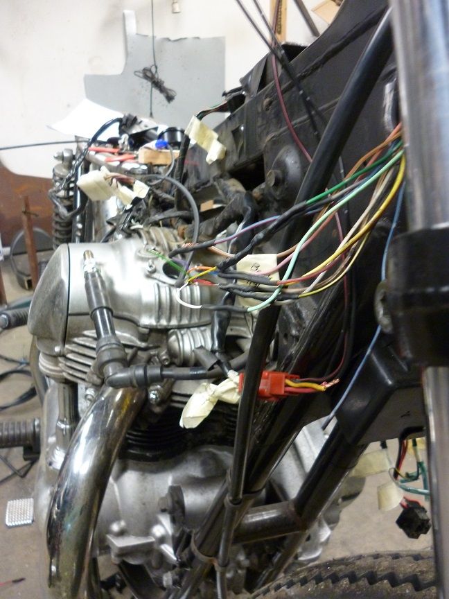

After something like 3 weeks of wiring, cut extend remove and remount, the thing still fires up, with out catching on fire which is nice

Yeah, I modified one peg at a time, what i should have done was cut both of and swapped the "cups" left to right, they only fold slightly forwards,
Still pisses me off, and was thinking it could be a wof issue, so will have to fix i think
Yeah brake lever is just hanging out in that photo
