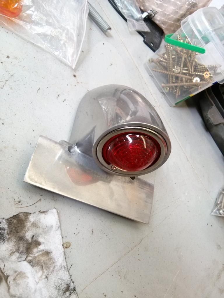

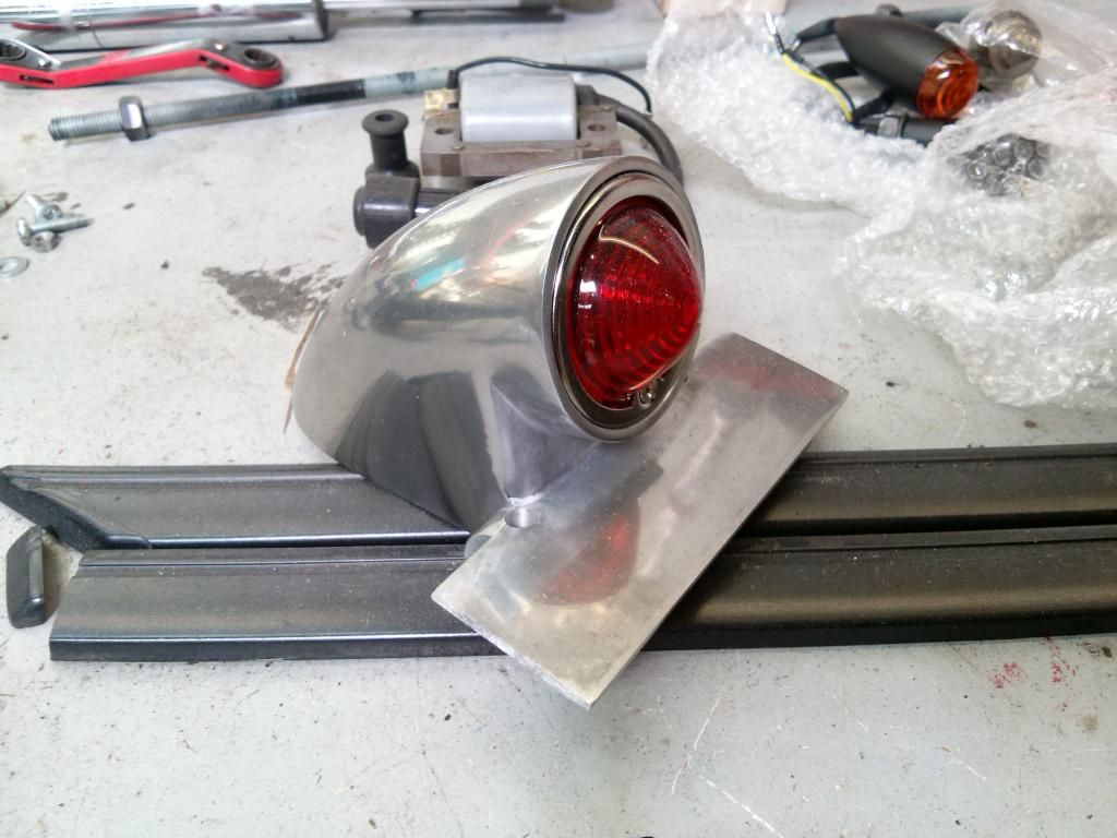

Got this Biltwell mako tail light copy, its still real good build quality for a copy and doesnt feel cheap and nasty
Have cut the number plate bracket off, plan to mount it on top of the rear gaurd but kinda not too sure on it at the moment
sticks up real high, but ill have to wait till the seat is done and might not look too bad.

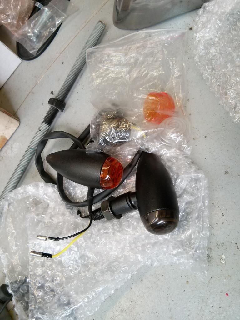

indicator, came with normal lenses, smoked and clear. Metal housings and feel like good build quality aswel.

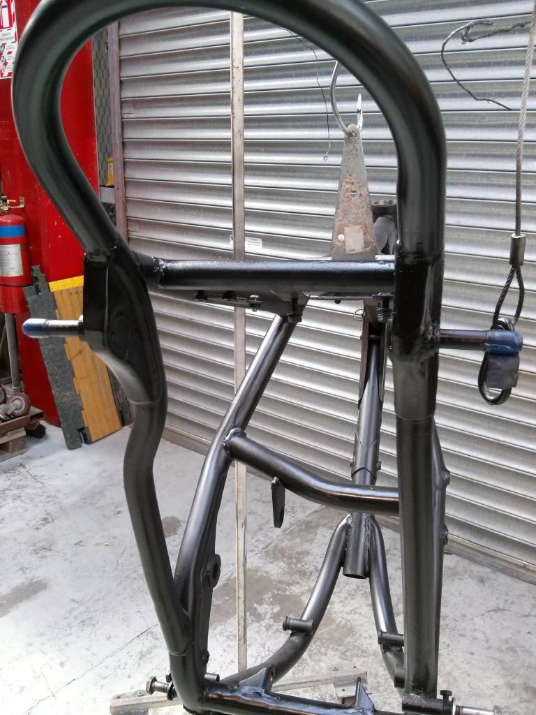

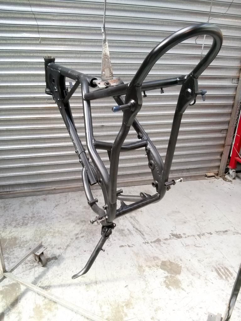

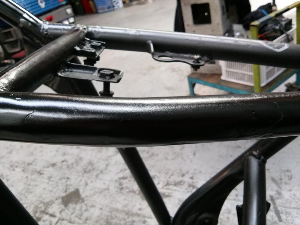

Rear hoop all welded in. and tidied up the ends of the shock mounts
Pretty happy with how that came out

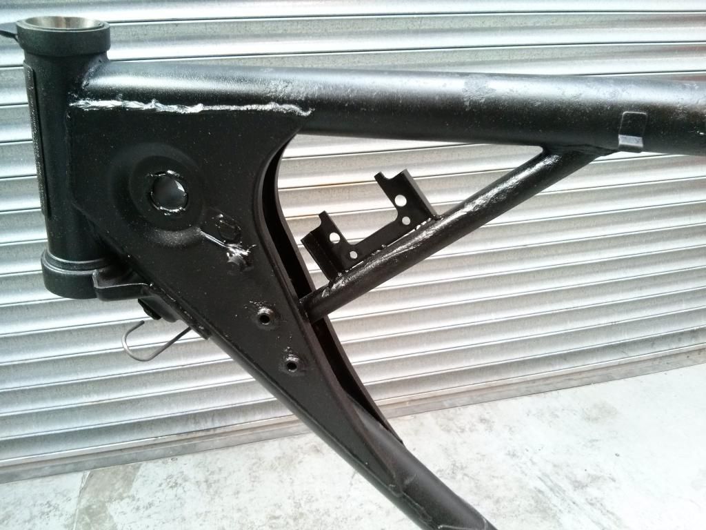

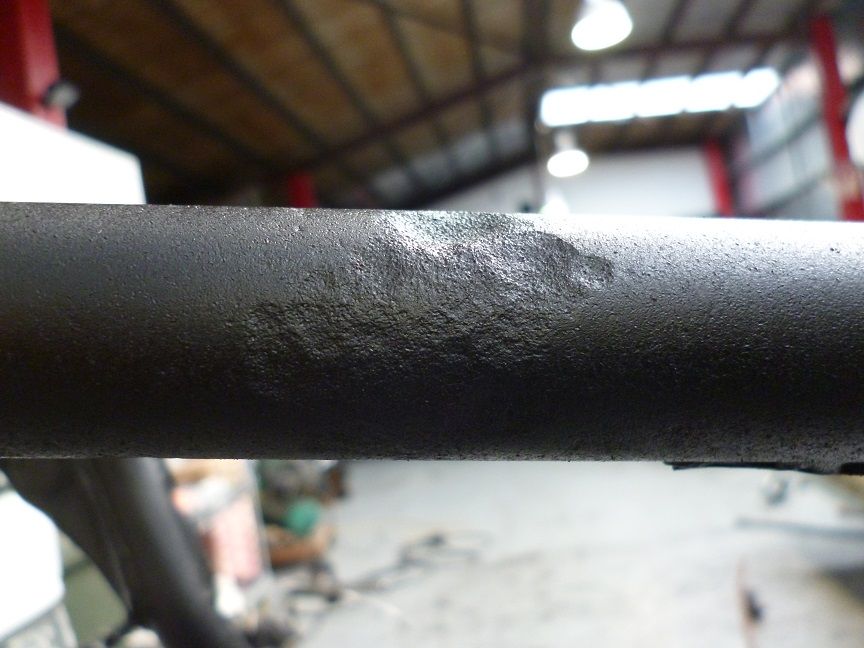

Before.........
........After, just weld filled it, in the end. Looks pretty good, and once the primer and paint goes on, it should fill any last little pits

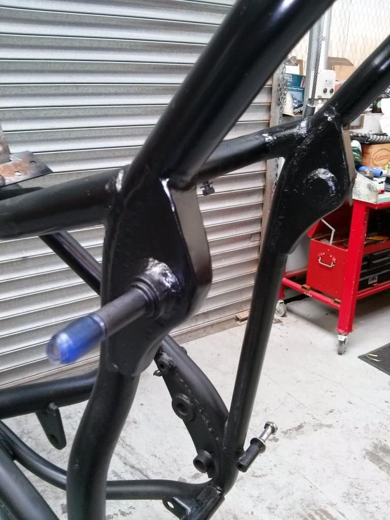

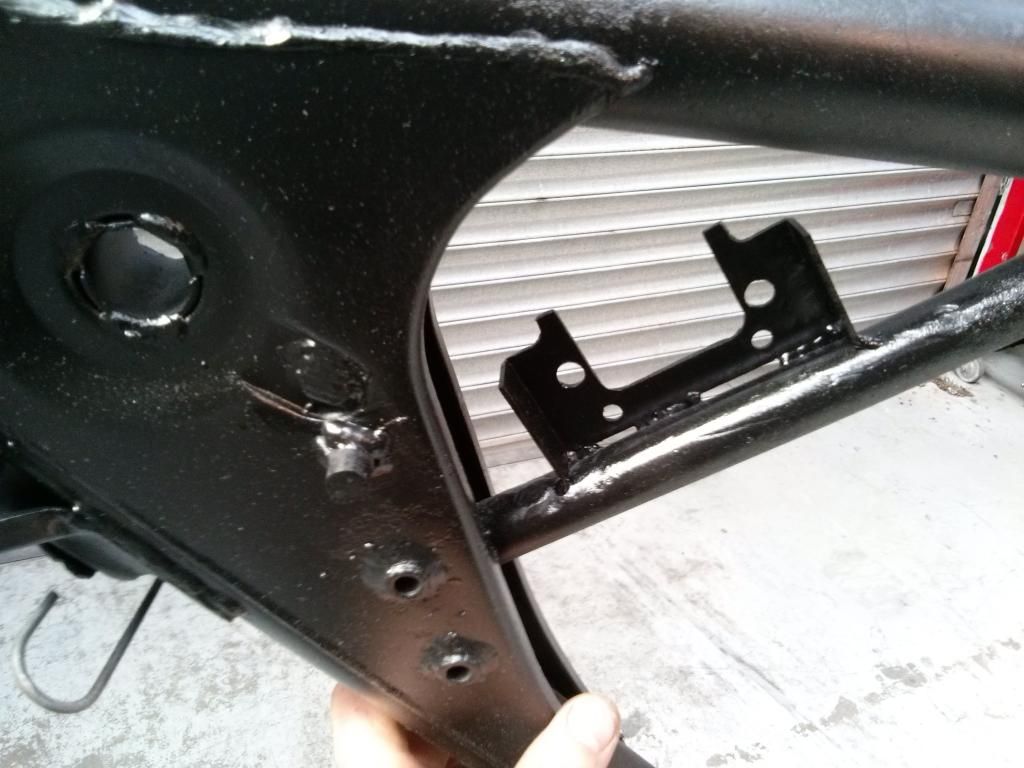

Have since cut all the unwanted tabs off and welded on tabs for the rear guard and seat mounting points. Have to move a foot peg mounting point over, and a flasher unit mount then the frame is done and ready for paint.

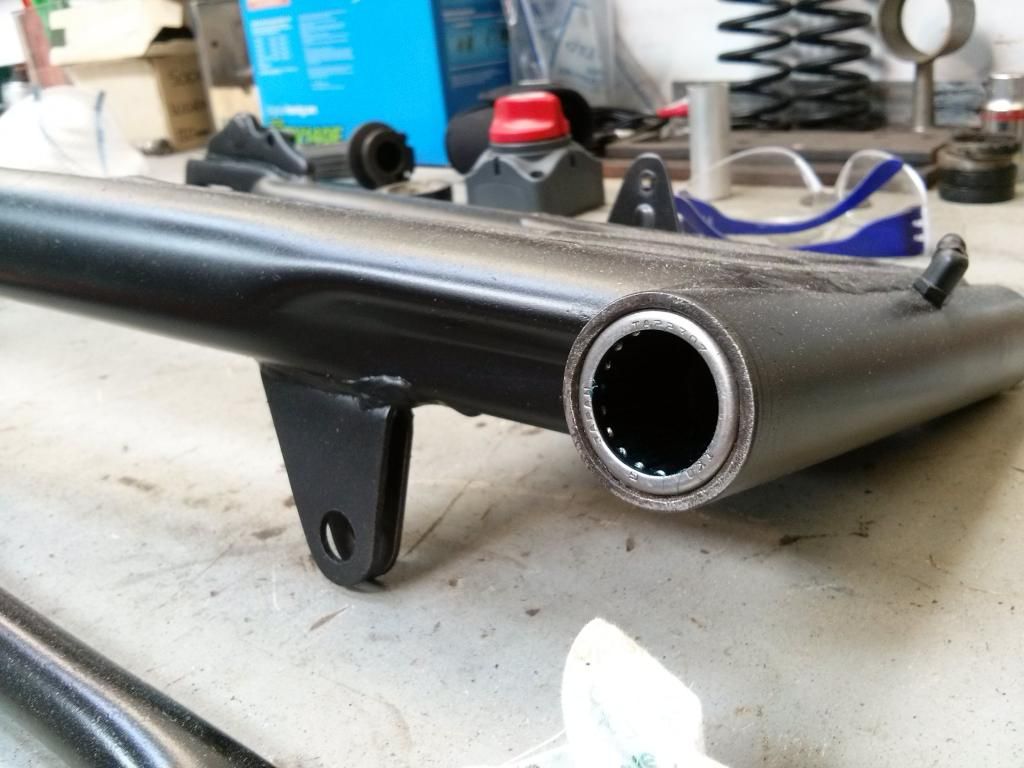

The Swing arm pivot sleeve was really badly pitted and the bearings rusted out and completely shot, hence the new bearings. Boyles couldnt find me a new replacement sleeve anywhere. Searched on ebay, but couldnt find anything. Lauras old man gave me a couple of good ideas, but then I remembered I still, for some reason, held onto the rear/cut up swing arm for the KZ from when i hard tailed it. Sure enough the sleeve is the right length and the right size OD (where the bearings run), but the wrong ID (where the axle goes). Stoked! As that shouldnt be too hard to fix, will ask Manu if he can drilll that out for me some time. Manu if your reading this............

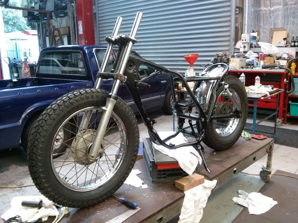

Have had a new headset sitting on the bench for a long time now, finally put it in. Why did I not do that earlier?! Putting brand new parts on is so sweet!
Feels so good, I guess thats mainly because the last head set was "index steering"
Forks on for the frist time since like last year! Loser!

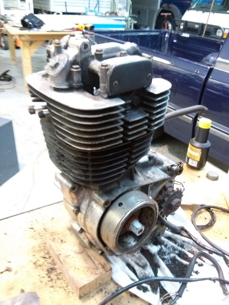

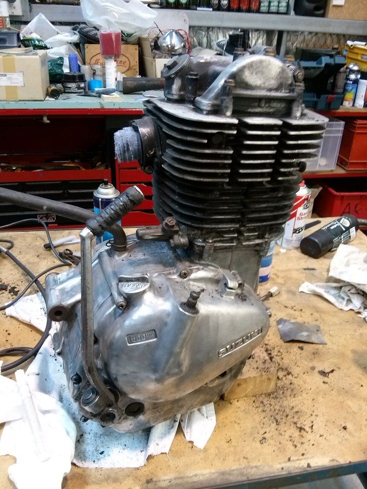

Have cleaned up the motor as good as I can, ready for paint. I know some people hate on painted air cooled motors, but this motor looks like balls
Think Ive cleaned it up some more since these photos aswel

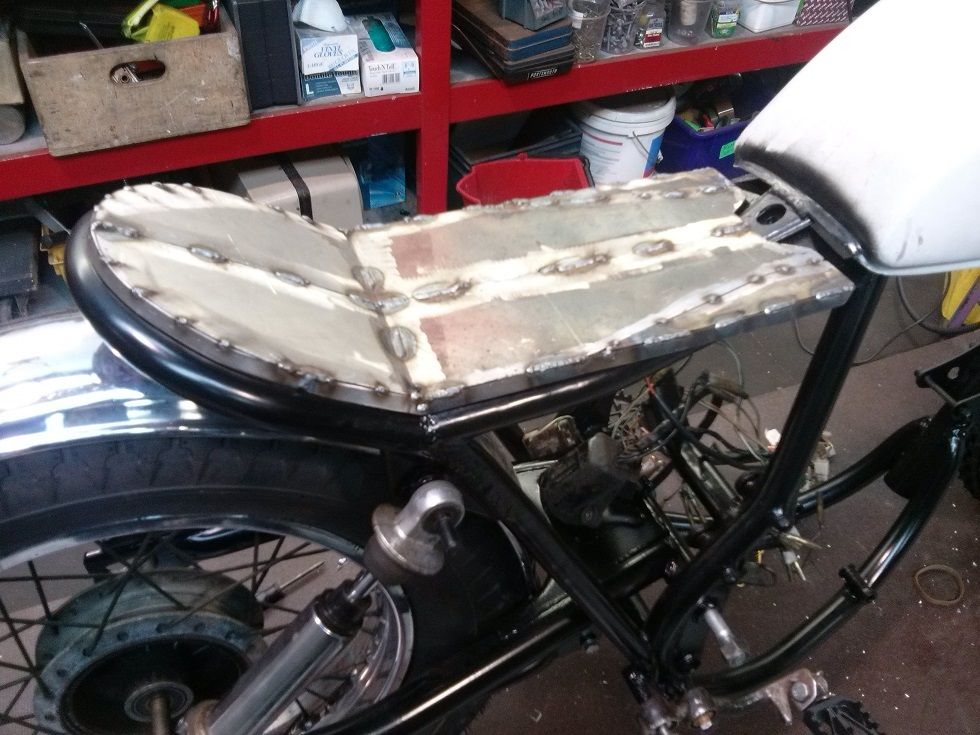

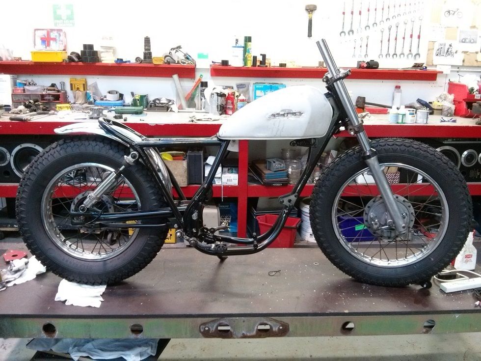

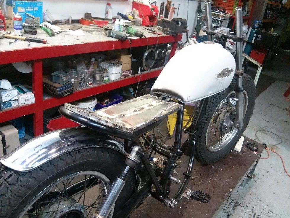

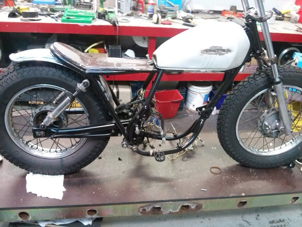

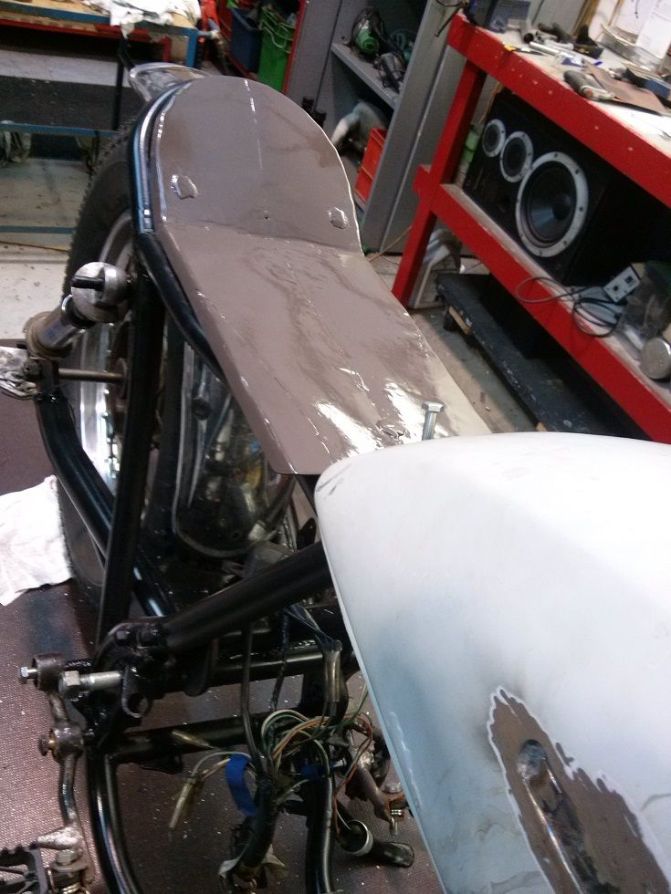

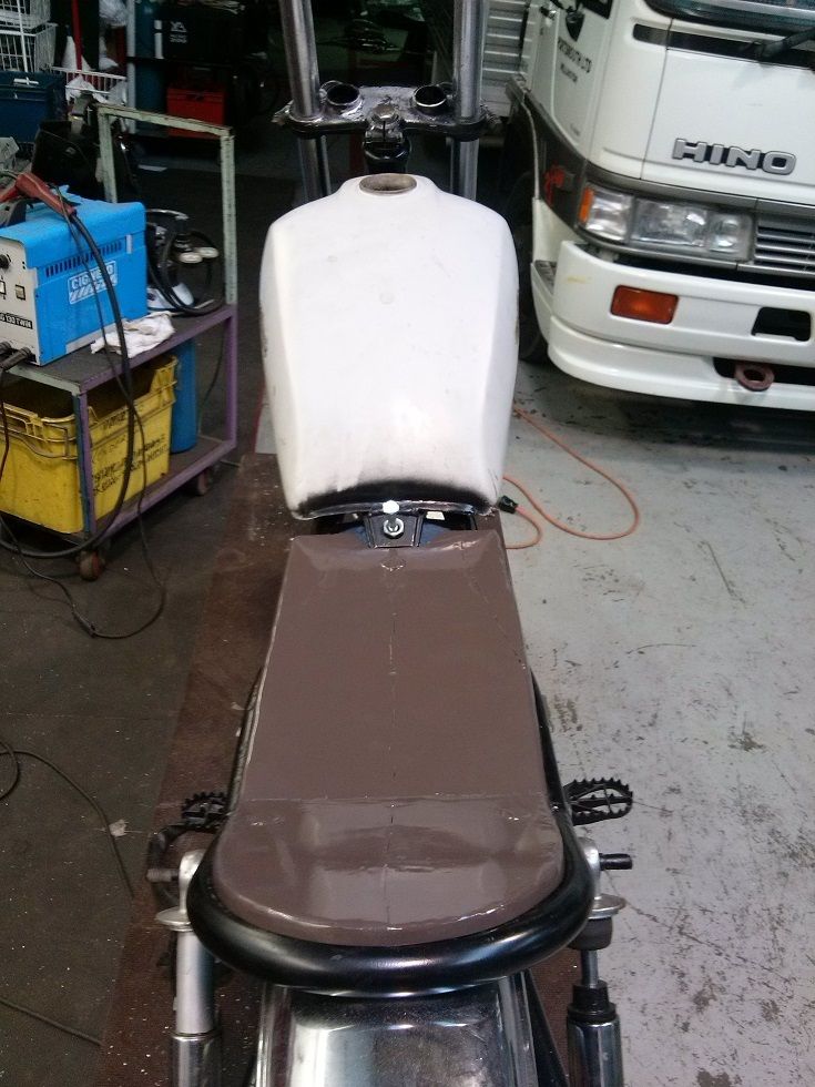

Got the tank back from mates workshop which motivated me to get the seat pan made up
after abit of trial and error with making the basic shape
Settled on this

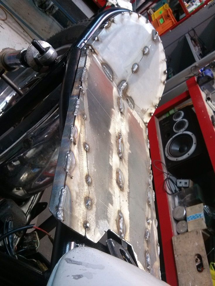

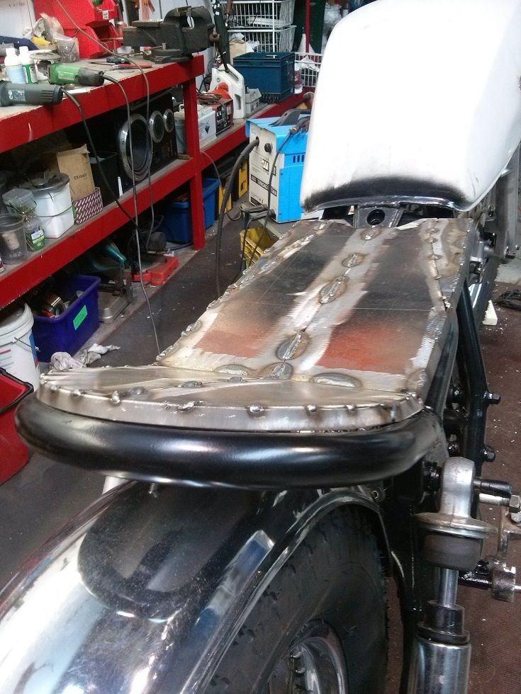

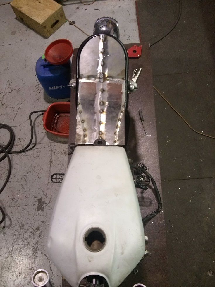

Seat needs to be slightly raised to allow room for electrics, so made a lip around the edge
Then welded from underneath, ground off top welds and welded on some studs for mounting, and etch primed
Slightly tapered the front end to meet the tank width
really happy with overall look, the seat the bottom line of the tank is dead on where i wanted it. Stoked!

So in my hast in getting the front end back in, didnt realize Id put the forks on backwards haha dumbarse

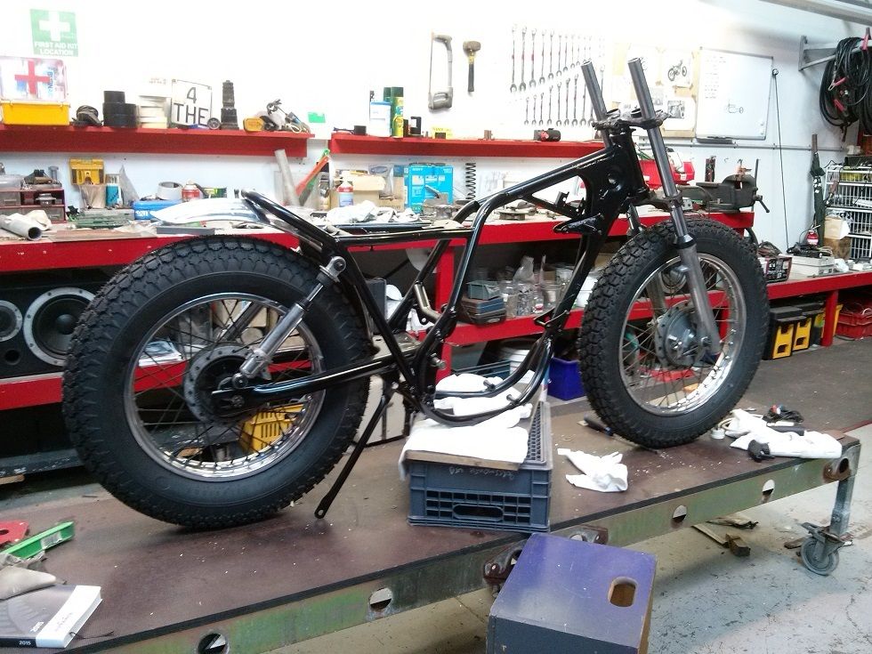

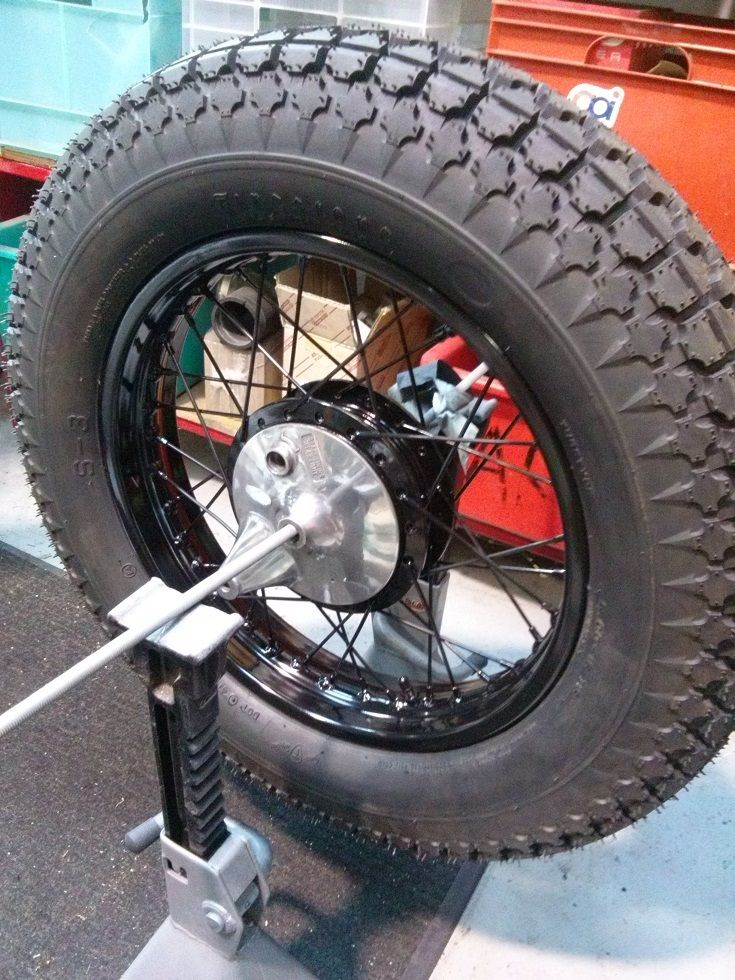

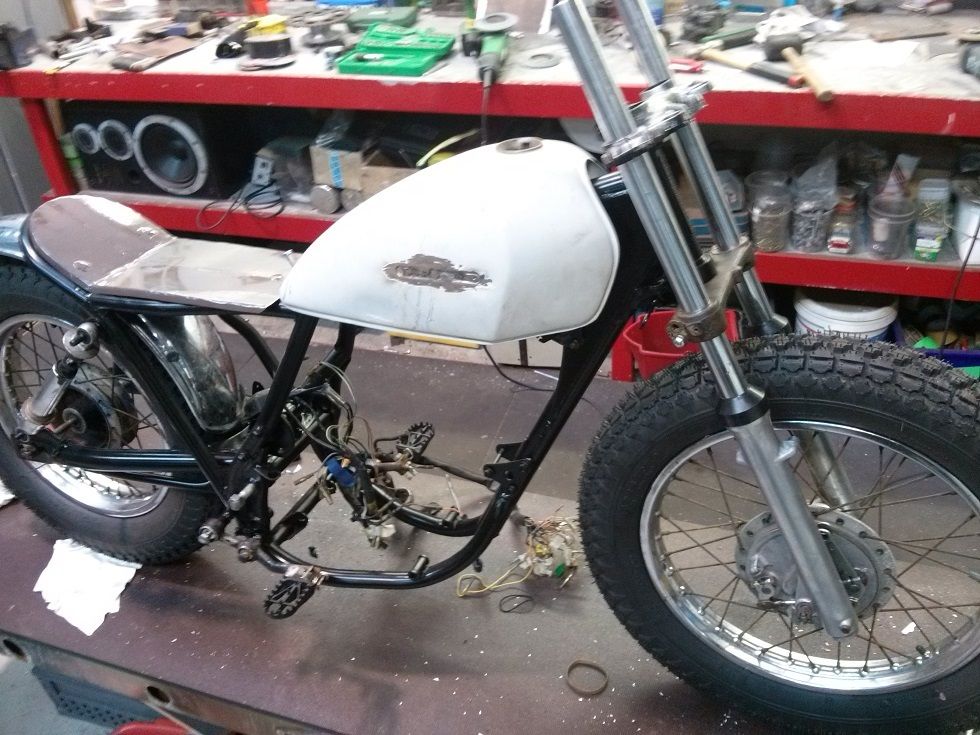

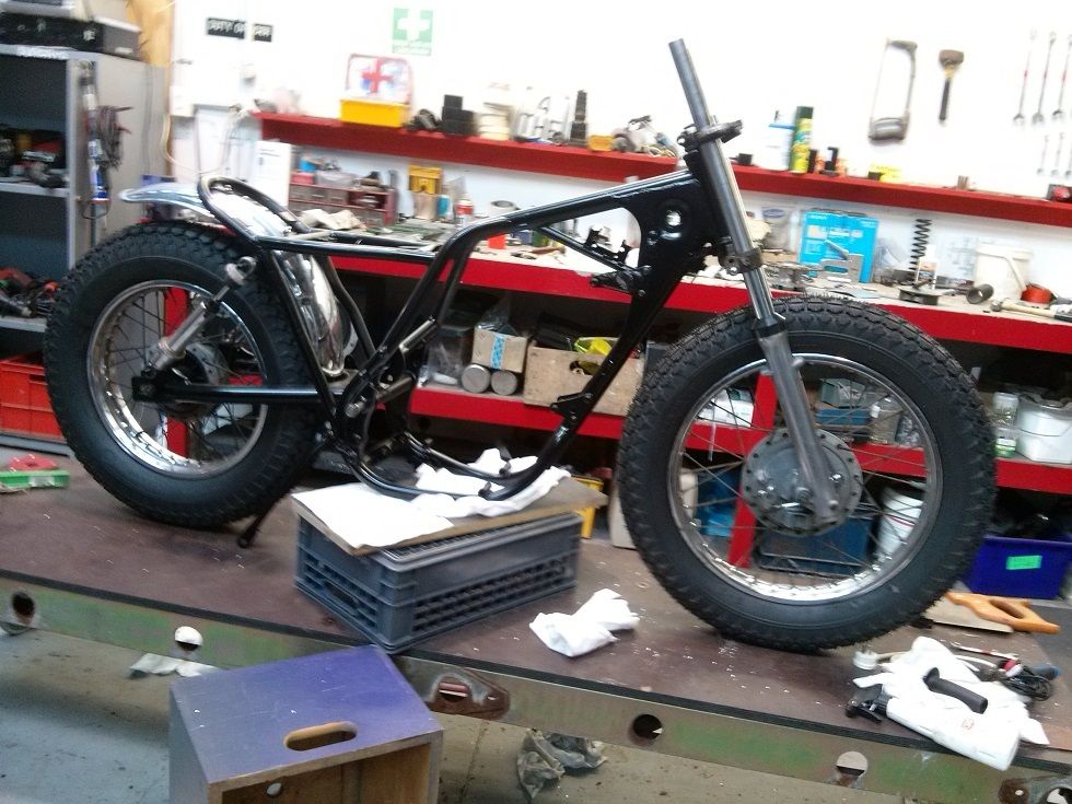

But anyway, heres the wheels in,
wasnt going to paint the wheels or polish the drums when I started out, but chrome was stuffed and hubs needed something happening to them
really happy with the headlight aswel, got it awhile back but nice to see it on the bike finally
fresh paint!
First time ive seen it all one colour
Since I had the wheels all but done, thought I might aswel put a new sprocket on there, figured it would be a black one as thats what come off,
turned out to be a silver one, which kinda didnt like at first but stoked with now
