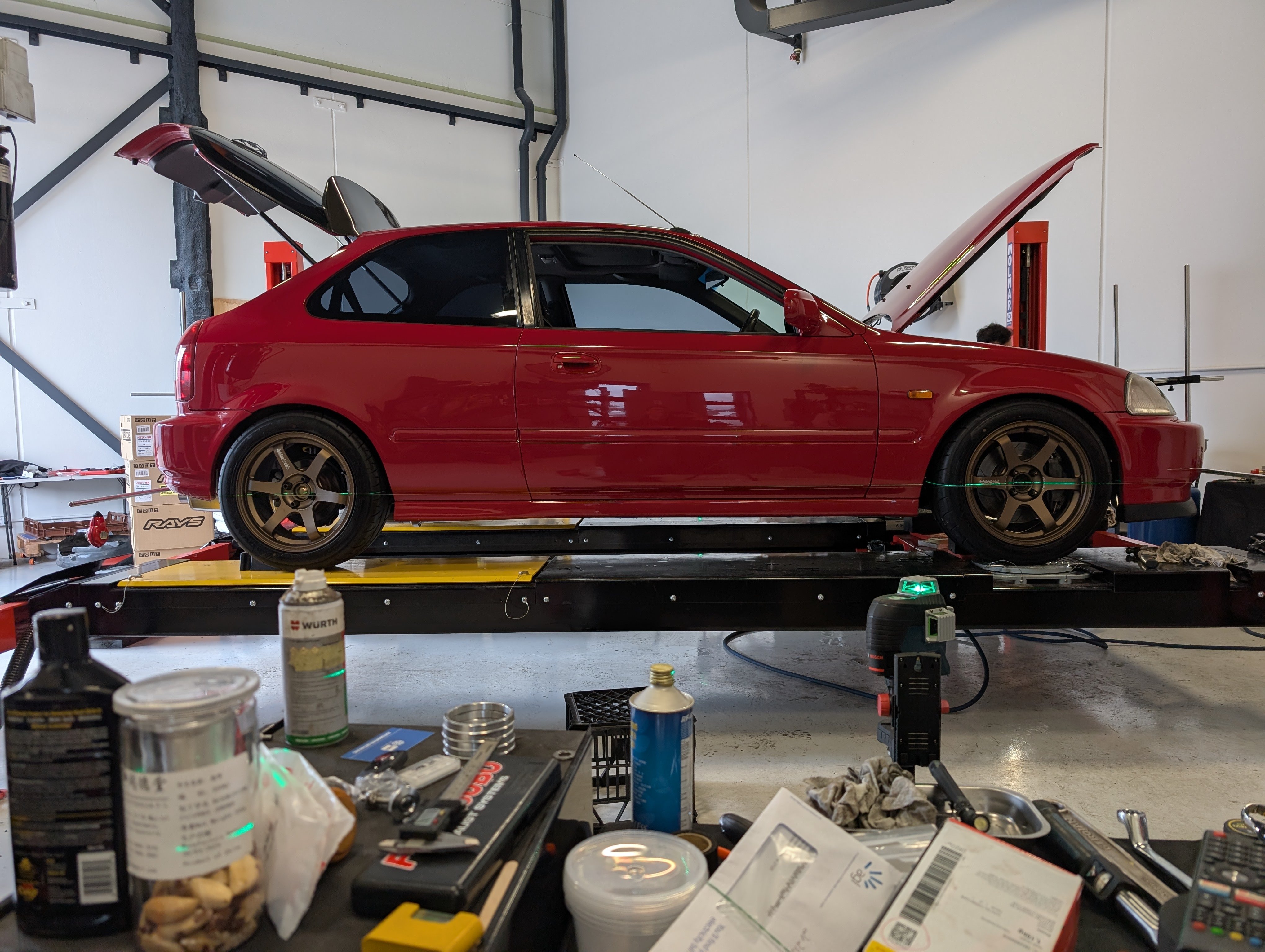

Honda Ass Dragger Posted May 16, 2025 Author Posted May 16, 2025 Got a nice strings and lazers alignment, added front and rear camber arms, plus rear toe arms. Car now drives amazing next up some 90tys graphics. Stock guards 225/45/16 ad09s +35 off set wheels n it's sitting nicely under all the stock guards 😃 5 Quote
mjrstar Posted May 16, 2025 Posted May 16, 2025 10 hours ago, Honda Ass Dragger said: plus rear toe arms. I found the rear toe adjustment to be critical on my ek. From 2-3 mm to zero was the difference from something that had way too much lift off oversteer to being able to bomb into corners with way more commitment. Everyone says you need the toe to prevent understeer, but with the right diff and tyre combo I'm not so sure. 1 Quote
Honda Ass Dragger Posted May 17, 2025 Author Posted May 17, 2025 5 hours ago, mjrstar said: I found the rear toe adjustment to be critical on my ek. From 2-3 mm to zero was the difference from something that had way too much lift off oversteer to being able to bomb into corners with way more commitment. Everyone says you need the toe to prevent understeer, but with the right diff and tyre combo I'm not so sure. From my quick drive through the local touge on the way home it's amazing. Quote

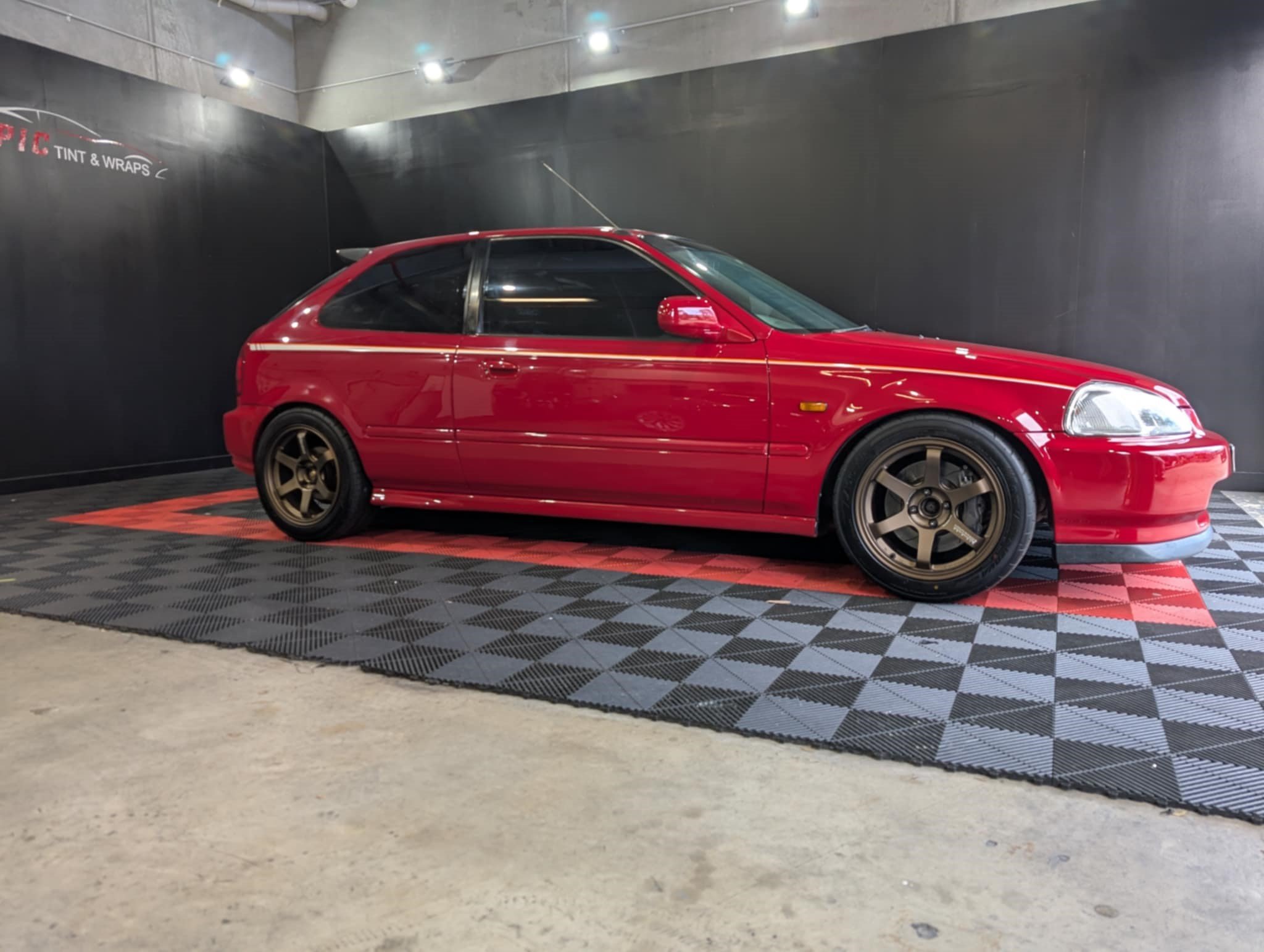

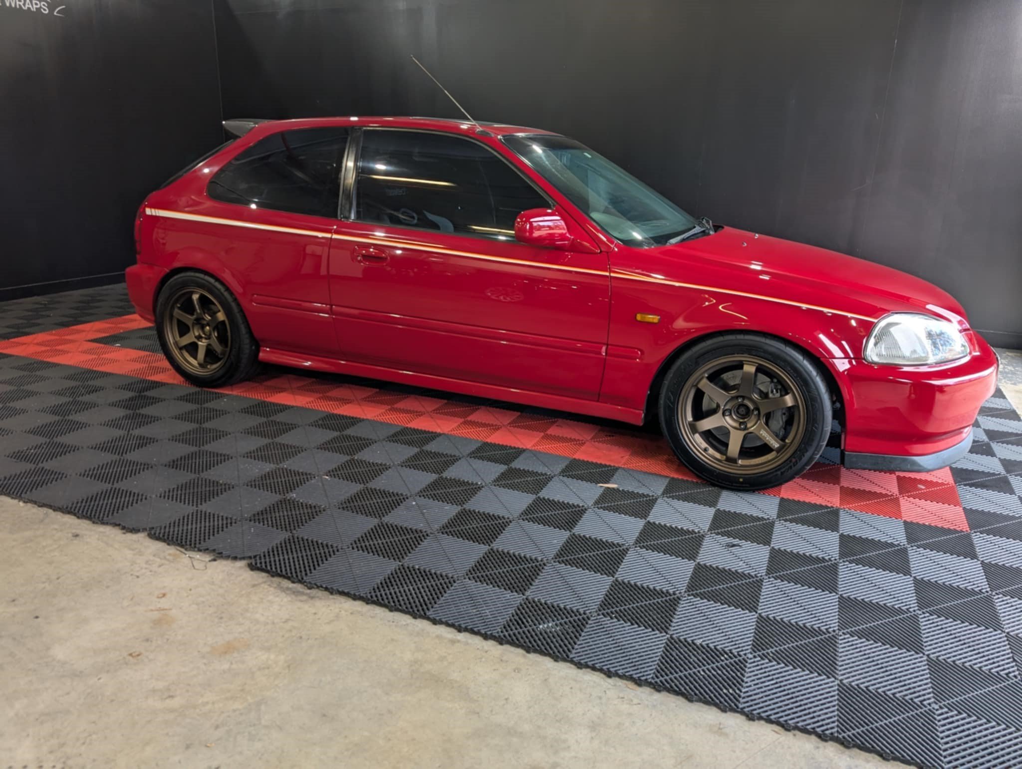

Popular Post Honda Ass Dragger Posted May 20, 2025 Author Popular Post Posted May 20, 2025 V2 is completed 14 Quote
mjrstar Posted May 20, 2025 Posted May 20, 2025 Nice clean look, it's much more stealth than my ek! 1 Quote
xsspeed Posted May 20, 2025 Posted May 20, 2025 real clean, sweet wheel and tyre combo too, nice square chonk 1 Quote
