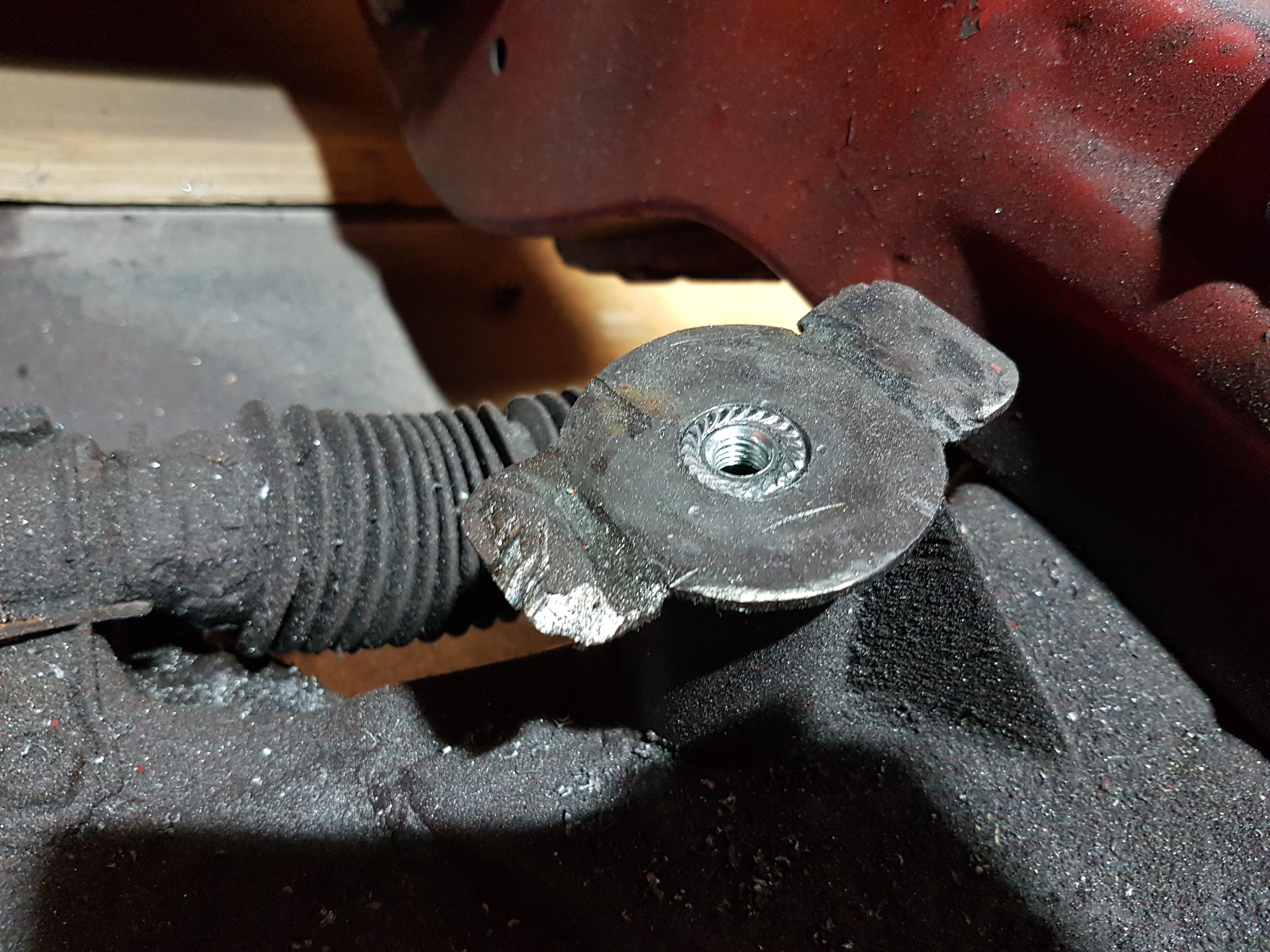

And I noticed this very strange bit of damage while inspecting the head:
I have no idea how this would have happened, but there's a substantial piece missing from the face of the bucket. There's no signs of damage on any other buckets either. The cam appears to be fine aside from a small wear pattern visible in the above picture. I'll get a DTI onto it to make sure the cam is straight and will replace the bucket.
Has anyone else ever seen this?

A bit of further investigation shows no signs of stress on the underside or the valvetrain.
This chunk obviously decided it'd had enough... But it's hard to know why.
